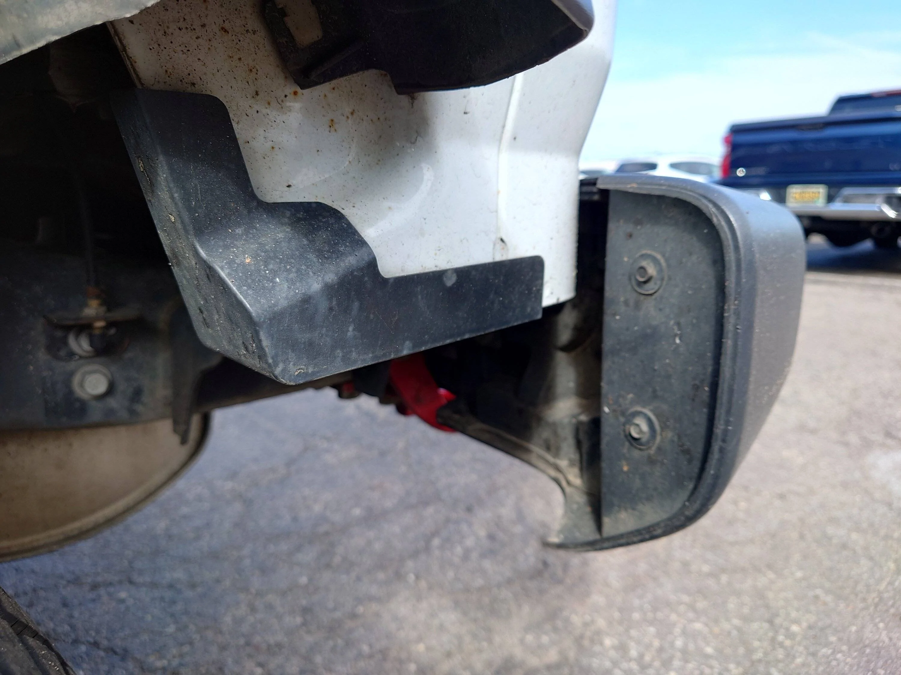

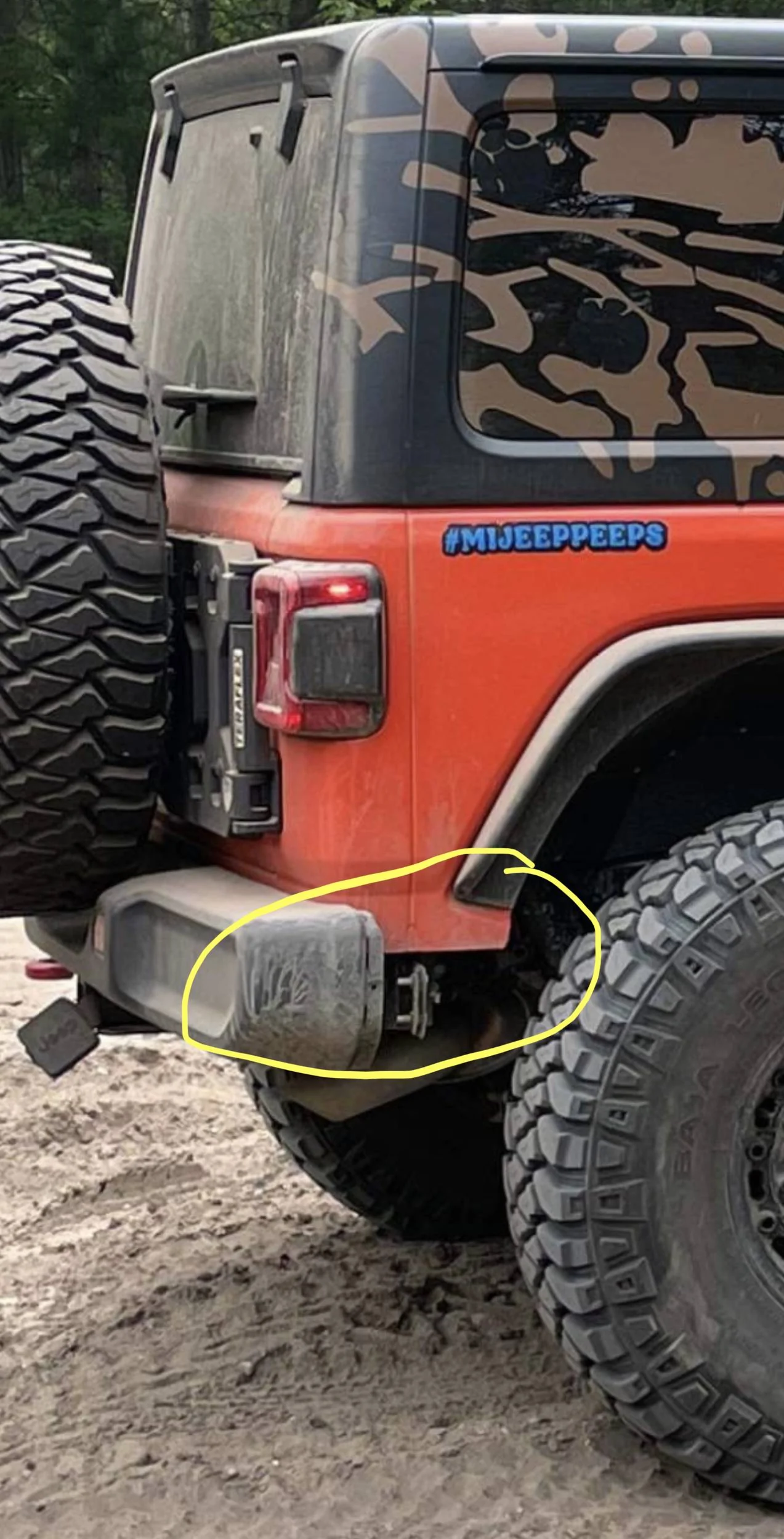

Can anyone recommend a solution to the missing original end caps? They interfered and had to come off when my fenders got installed. I’ll eventually replace the bumper, but I’d like to clean this look up in the meantime.

Reinstall the end caps again ….
or try mud-flaps. Just throwing ideas

Shari,
The aftermarket is focused at replacing the factory bumpers. So, a solution is very likely going to have to be either replacing the plastic bumper with aftermarket or fabricating a custom solution.

Yeah, I was afraid of that. I thought I might be missing an easy solution. Thanks!

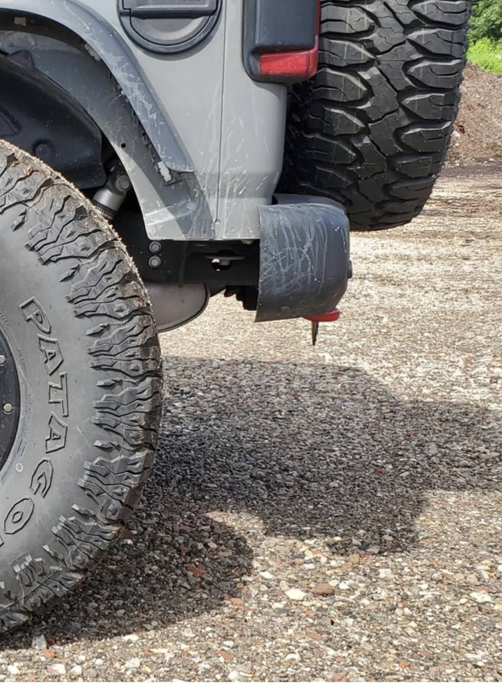

Yeah, my OEM plastic rear bumper is pretty smashed up from dropping off steps on trails. Last trail smashed the muffler tailpipe almost flat too.

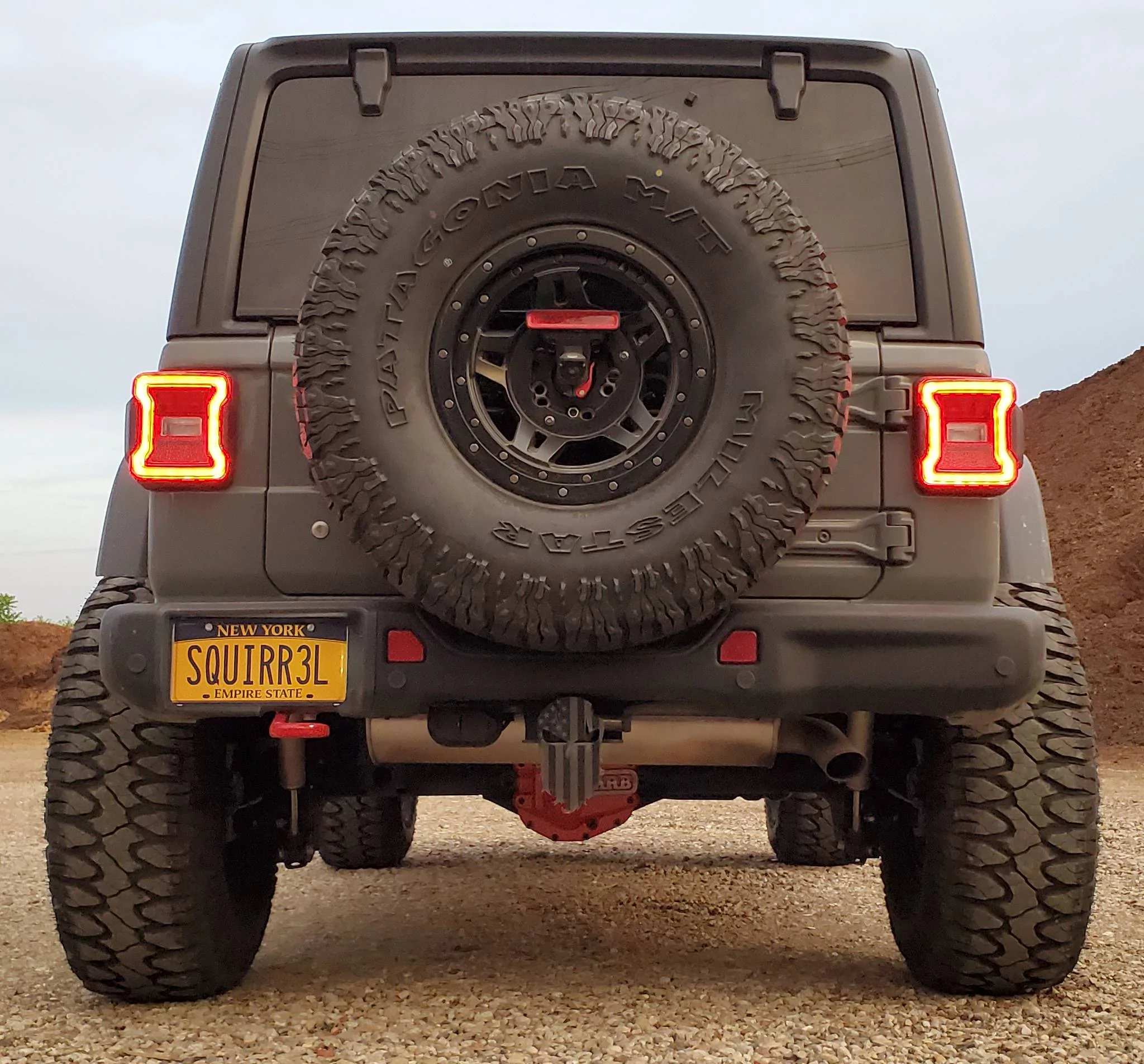

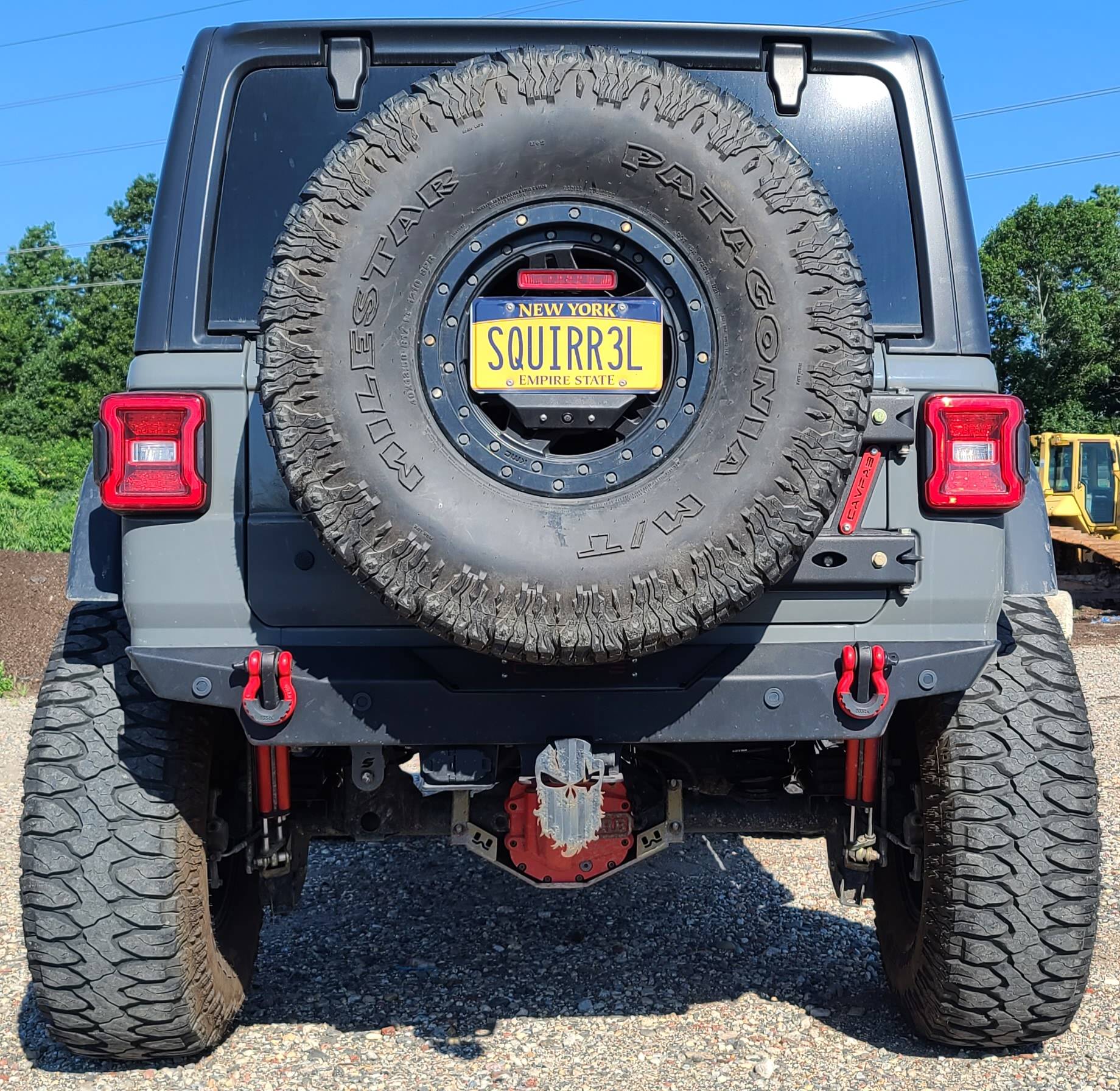

Before my factory steel rear bumper had a chance to damage the body, I ditched it for the aftermarket. I ended up with the Cavfab Ultra High Clearance bumper, which is strong enough to protect the body from upward hits. It's of a minimalist design, so it also increased the departure angle.
I swapped out the factory trash can muffler for a Borla Touring Climber cat-back, so the exhaust now exits on the drivers side and is flush with the bottom of the frame rail.
I also added the Metalcloak skid plate for the trailer plugs.

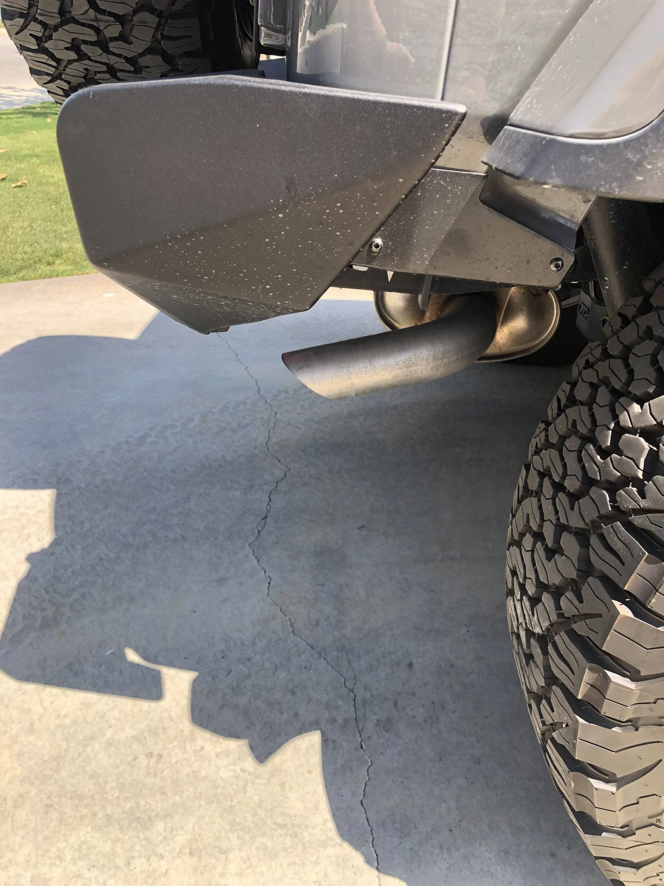

I cut that flange off flush. Made a filler panel to cover the open end from mud kicked up off the tires. And put the fishbone body armor piece on. I'll take another picture after work...
Jeep Wrangler JL OEM plastic JL bumper end cap options? Screenshot_20230920-125702
Memcdowe
Jan 10, 2020
108
North Alabama
2020 JLU Rubicon 2.0
Would you mind providing any details as to how you made that panel?
Also, did you remove that entire bracket that the tab sticks off of or just that tab?
Thanks!!
