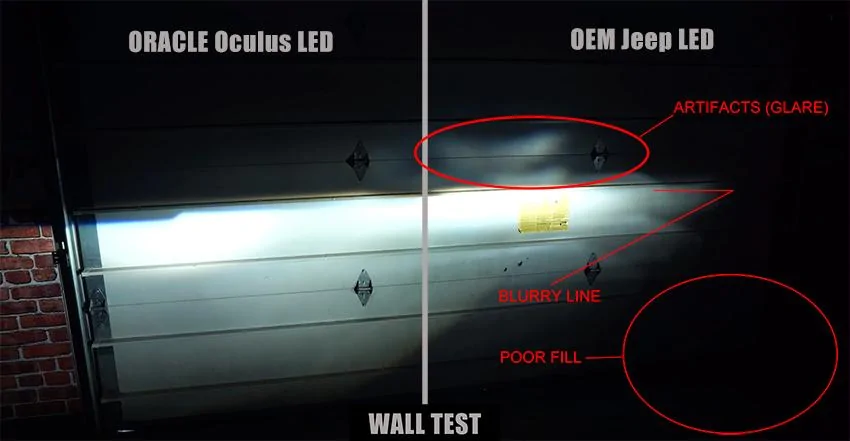

Good to know. I was going to start messing with all the screws till I either broke it or fixed it..
I love the lights but have to admit , that squiggly line bugs me just a little. Maybe Oracle could chime in here and explain why it is like that. Just ordered the fog bulbs. Did the drl and turn bulbs already.
I believe the squiggly line aka "step" has to do with the light direction/height toward oncoming traffic - I think ideally (when aimed properly) there should be one "step" in the middle
This is exactly why. They use a very good quality projector with a properly set cutoff shield. If you have noticed any of the luxury brand HID lights are the same, if a little bit less focused even. When properly adjusted the passenger side of the cutoff should line up for both beams. This will give you a single step that lowers the output just a little bit to avoid blinding oncoming traffic.
Hi all, we just joined as a forum sponsor so excited to see this discussion going...always appreciate an opportunity to provide more info!
You are all correct about the step line! Light focus is very important for not only driver safety but others on the road who can potentially have their vision obstructed by glare. The step line for left-hand driving countries is lower on the left, higher on the right so your lights don't blind oncoming traffic. The Oculus headlights have a very sharp cut-off line and focus light with precision specifically to avoid such issues (and this sharp cutoff makes the step more obvious on a wall test!) You should adjust them slightly so there is that step; you can see what I mean in the photo below. Feel free to give our support staff a call if you have more questions or want a technician's assistance with aim!
Jeep Wrangler JL OEM LED vs Oracle Oculus wall_test_2_1024x1024
