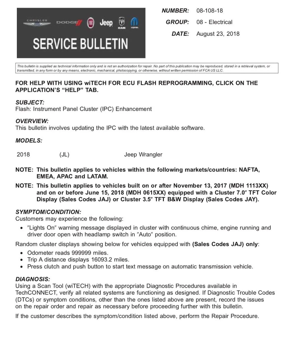

My dealer says this bulletin does not apply but I have this problem, wanted to know if anyone actually fixed this by pushing down on the fuses or did it continue for them. There are several threads similar to this but no one actually says they resolved the problem. Did anyone?
Always a good idea to check and re-seat fuses if you're having an electrical issue, then find the plugs and re-seat them. You can at least eliminate what it shouldn't be. A step further would be continuity tests on the wires, but you'd need a wiring diagram.
