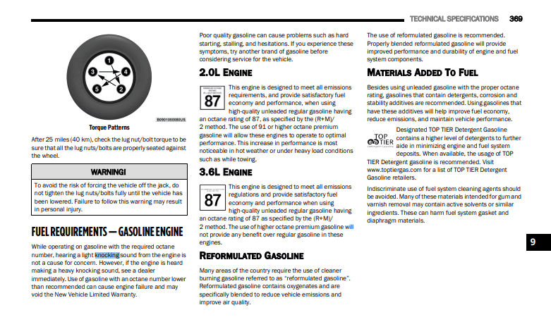

I did see in the owners manual where slight knocking under low RPM is normal but what is defined as slight?
