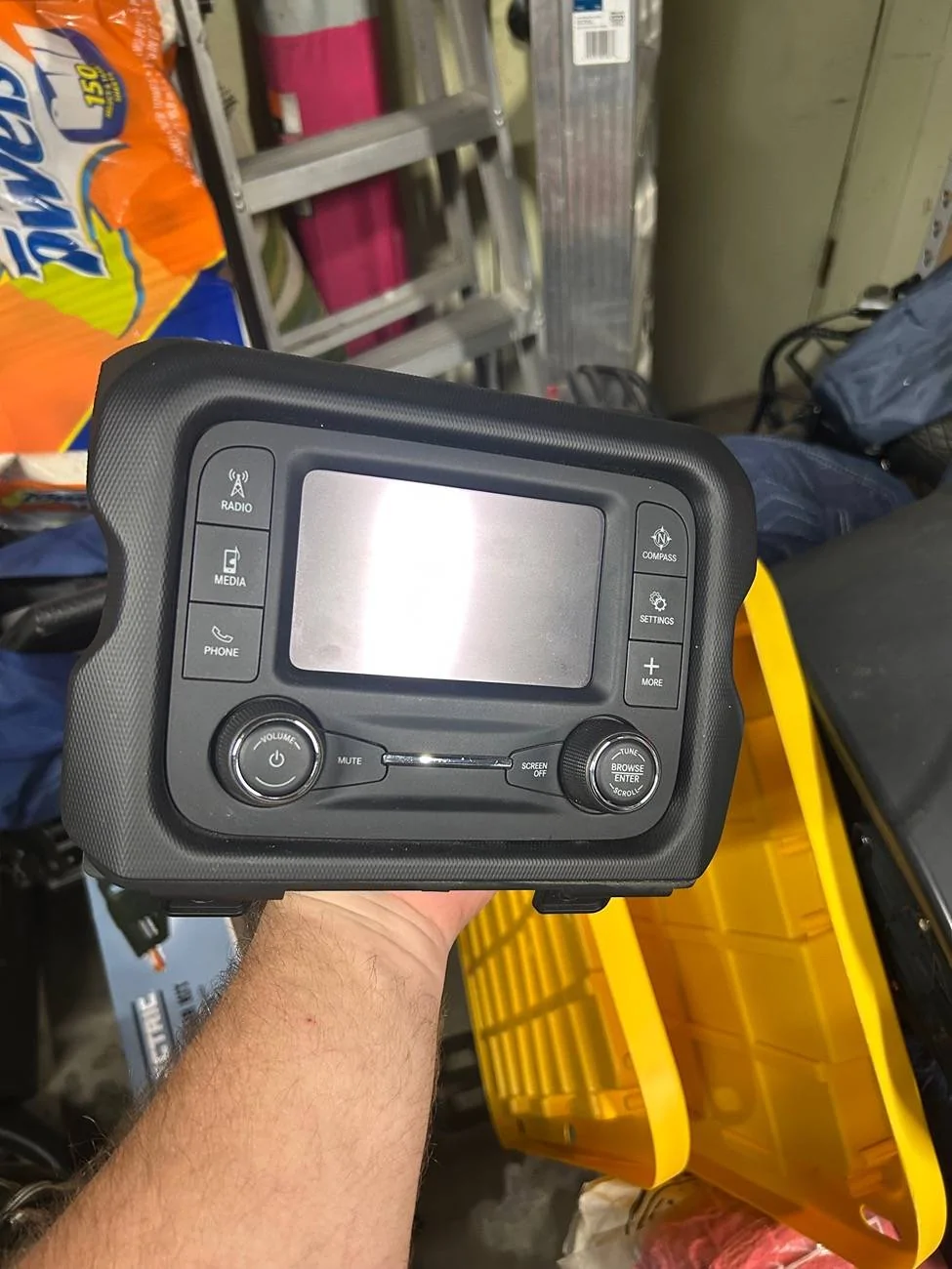

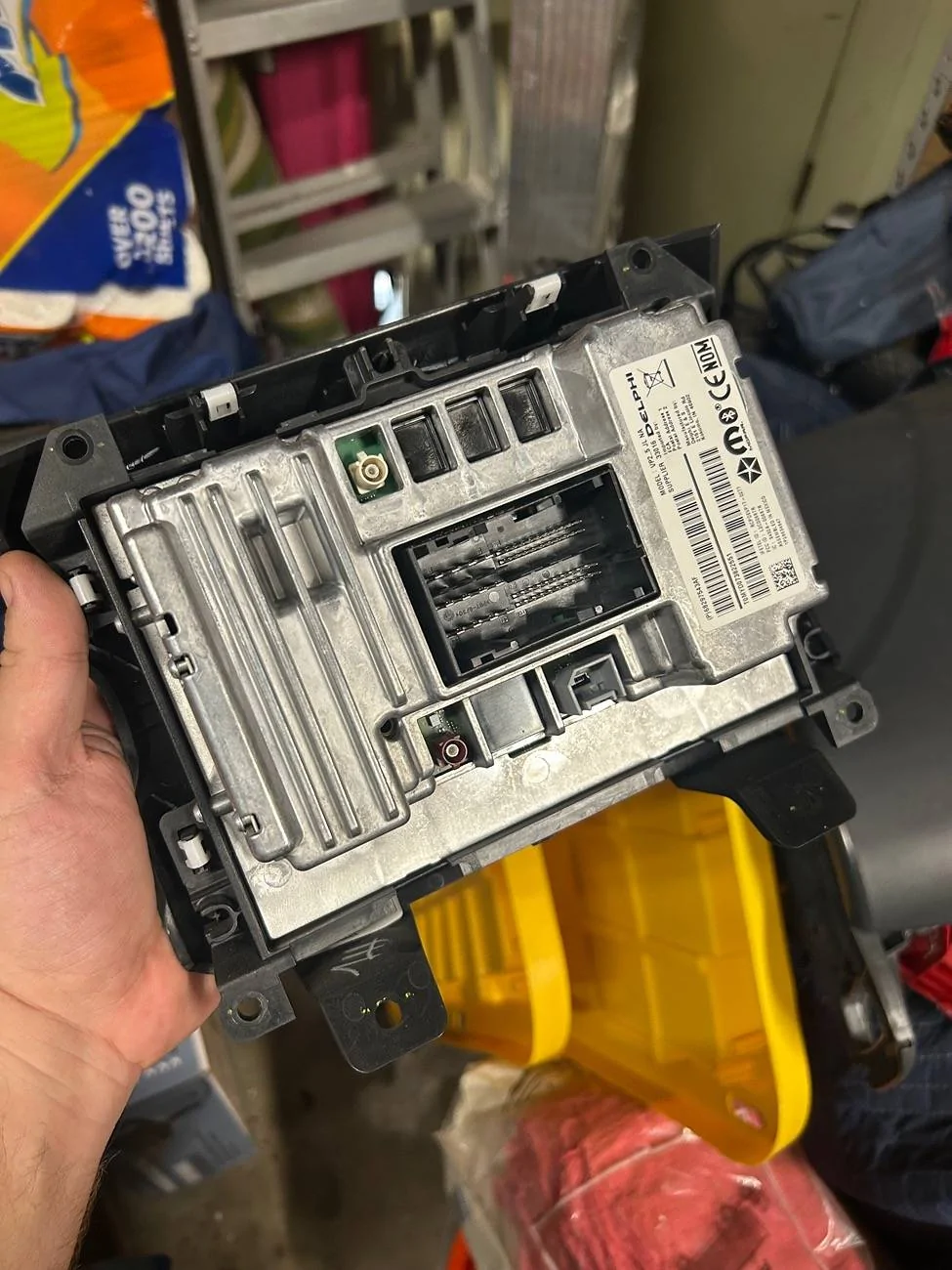

The install kit is the most ridiculous part of the whole thing. There’s a 35 dollar harness, and a $140 dollar harness and you need both. I upgraded to the 7” screen but then had no volume knob, the hvac was funky, all sorts of problems. Eventually traded the 18 in on a 24.
Is this the unit you’re looking for?

That's exactly it!
