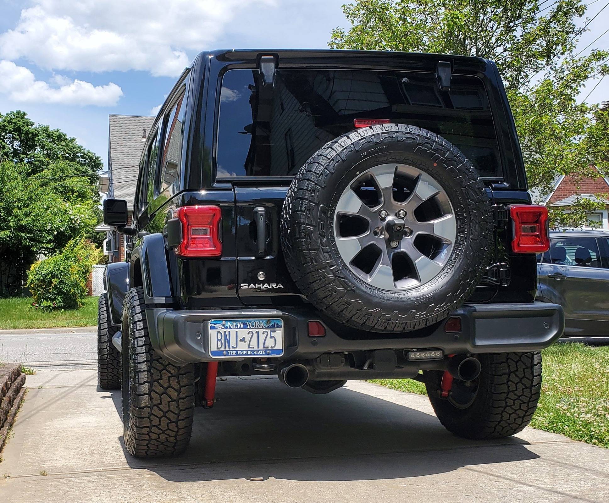

Just wanted to post pictures for anyone thinking about tire size. I have stock wheels on my Sahara. After 60,000 miles I replaced my stock Goodyear Wrangler tires out for Falken WildPeak AT4 285/65R18. To accommodate, I used 1.5" spacers and upgraded the suspension with stock Rubicon springs & shocks.
This setup is great, no extra road noise handles perfectly fine at even 90MPH. I feel more prepared for offroad adventures. I was told these are 'single ply' standard tires and not so great for towing (I only tow small loads and not often like firewood).
