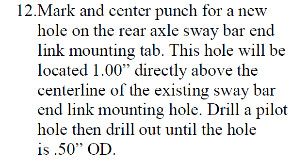

Roll bar axle mount? Trac bar maybe?![]()
Cool.. I'll give this a try. Also did you relocate the rear roll bar axle mount point? I have two set of instructions for the kit. One said to drill a hole an inch up from factory axle mount point. The other didn't - that was the only difference between the two (strange). I didn't drill.. I measured from center hubs to fender lips and I get 2 to 2 1/16 inches accross all 4 stance points. Havent gotten to freeway speed yet but it drives about the same as stock. Looks great on stock 33s. I'm getting 35s this week.
