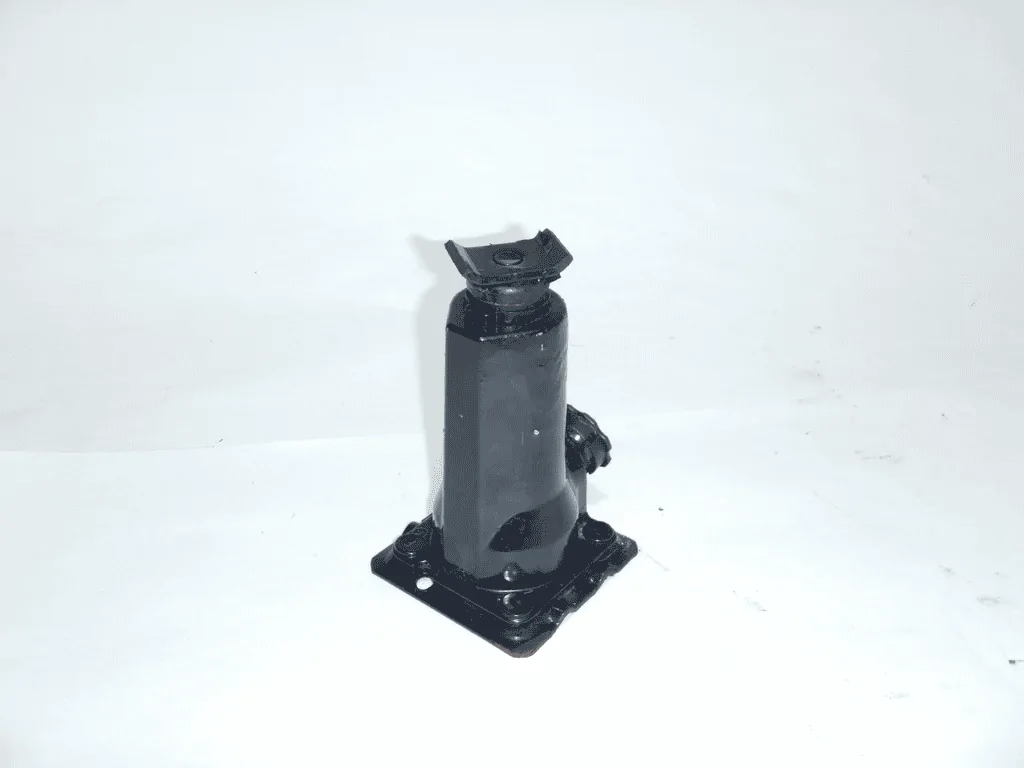

Just changed rims on Rubi.. of course offset is now different and factory tailgate bumps need to be replaced.. So ya buy the cut-able ones and hope to get just right? What if the clever guys created an adjustable tire bump tailgate stop that replaces the factory rubber.. operate on the same principle of the screw type bottle jack.. Snap it in, screwdriver adjustable twist it out till contact and perfect fit.. What ya think? Am I overthinking It? I have had multiple jeeps and getting the right bump has always been a issue .
