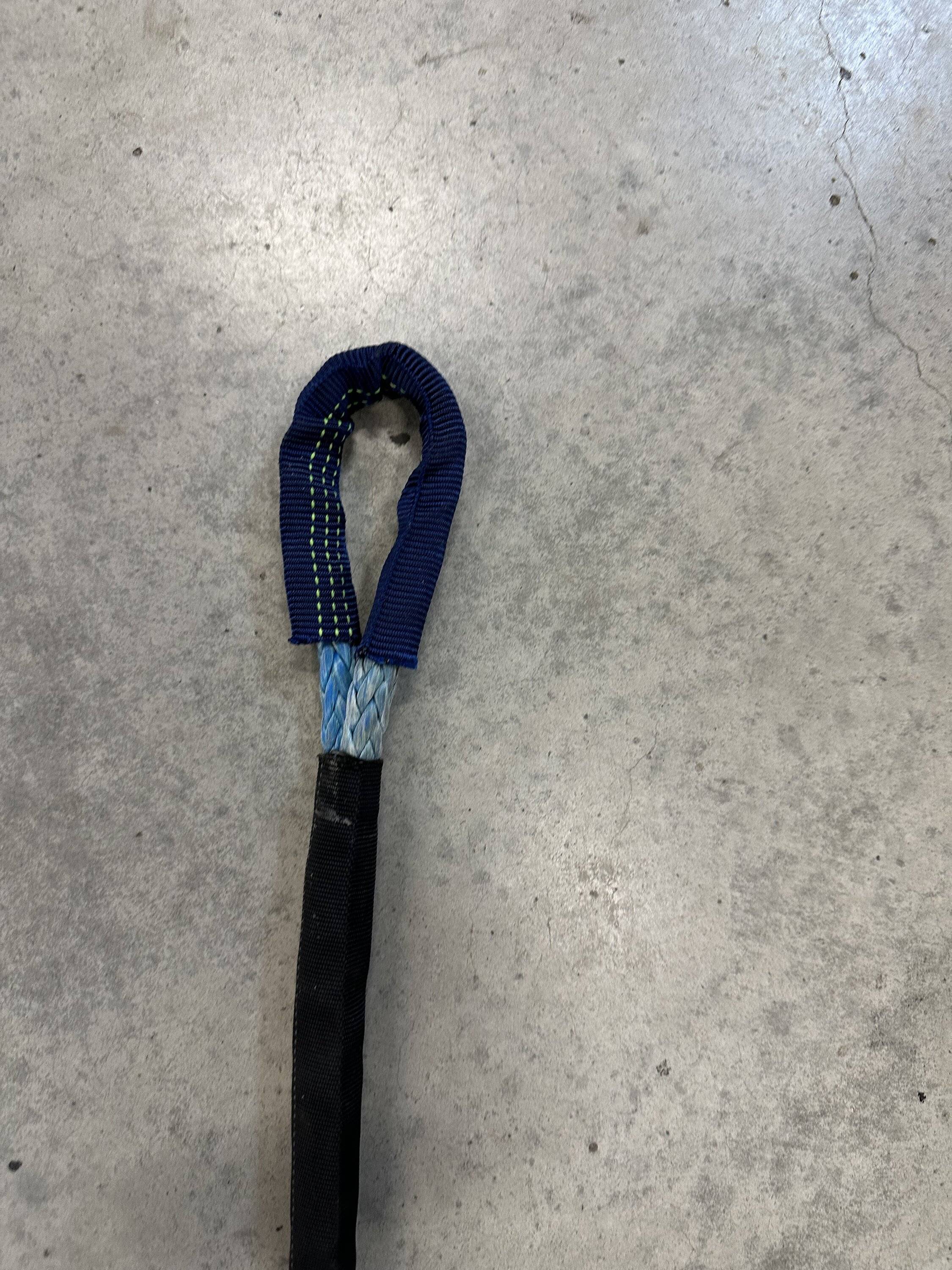

Hmm. Why not just replace the hook with a soft shackle?
Is there a reason to not just remove the typically pre-installed steel loop and just connect the looped rope end with a soft shackle?
Anyone?
Edit: I’ve learned the an acceptable way is to attach the soft shackles via a cow hitch. You do lose 15% strength in the line. One could offset by going to larger line which I’ll do the next time I replace my winch line. Very Easy knot btw. I’m going with just the cow hitch on the factory 3/8 line for now.
Anyone?

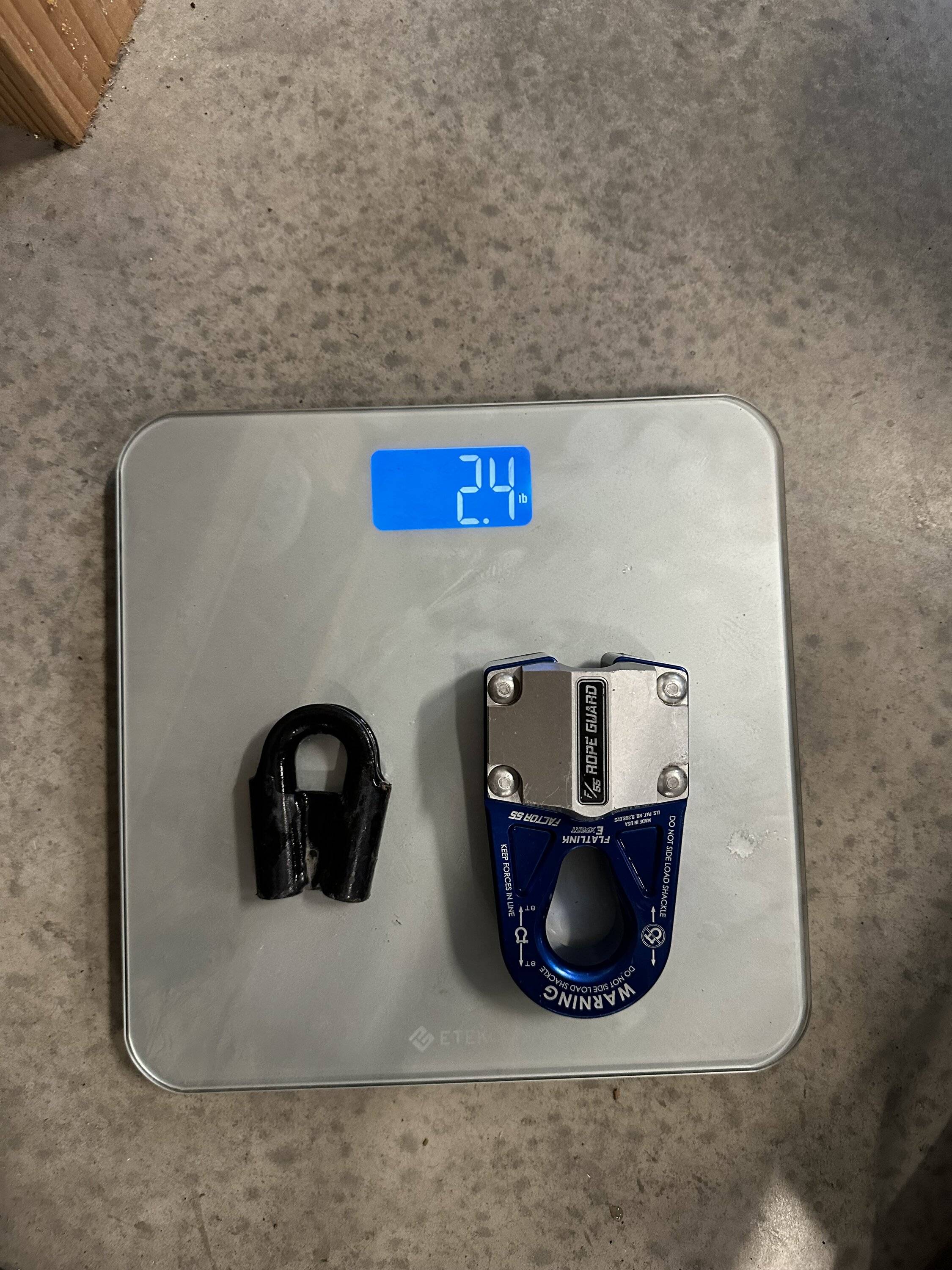

I did that but on hard pulls it was pinching the line. The steel loop is very light so I put it back in.

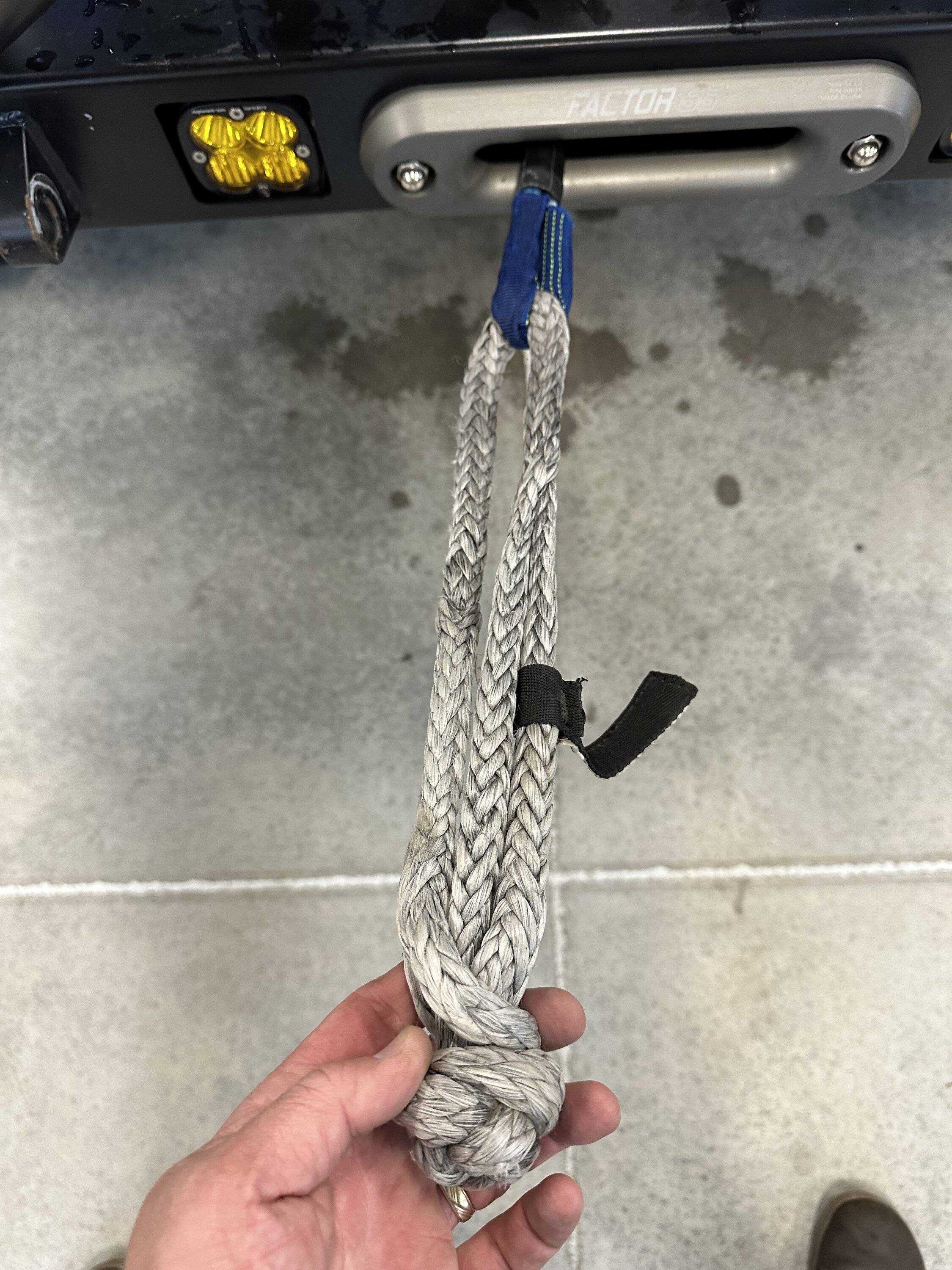

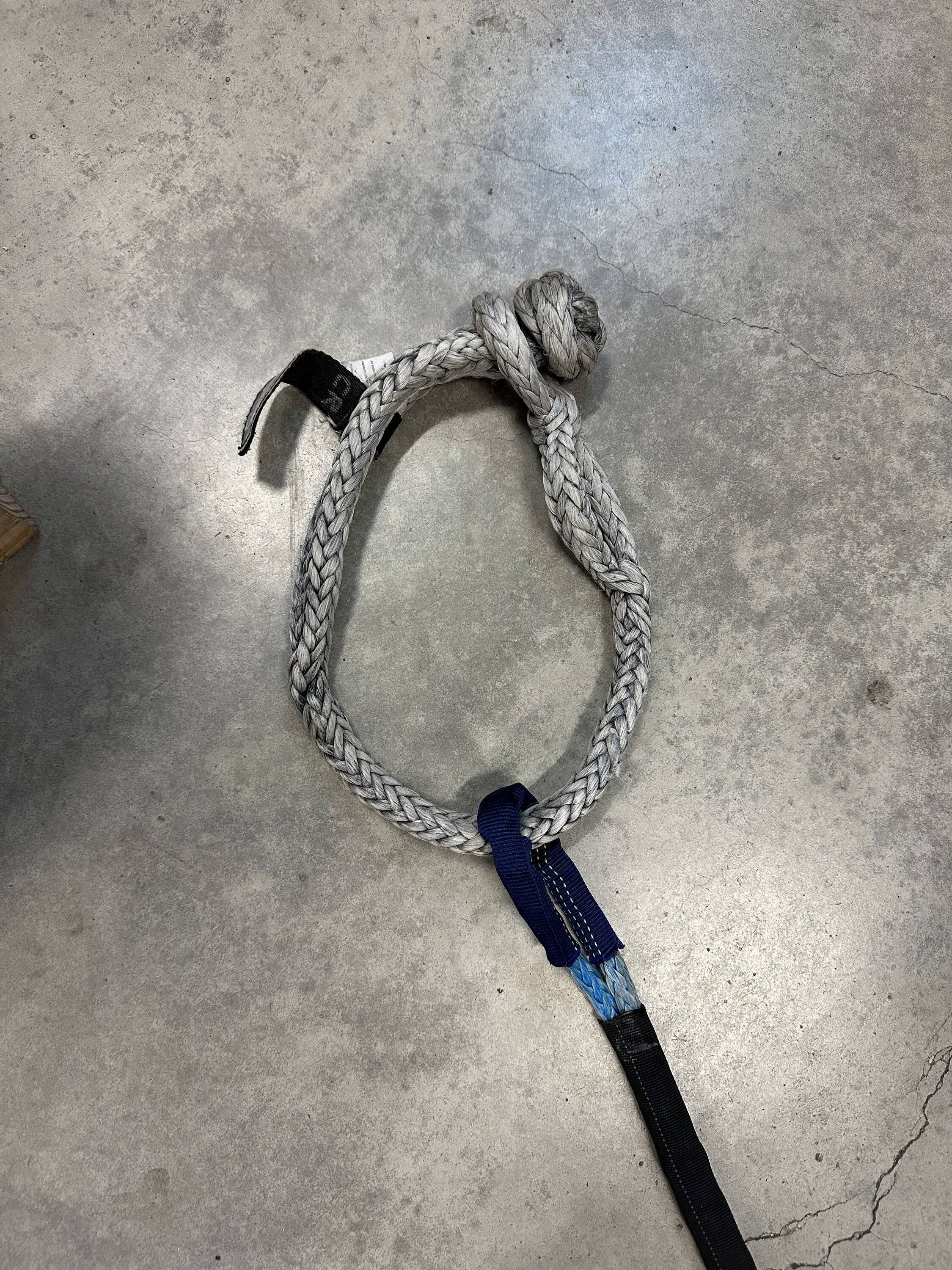

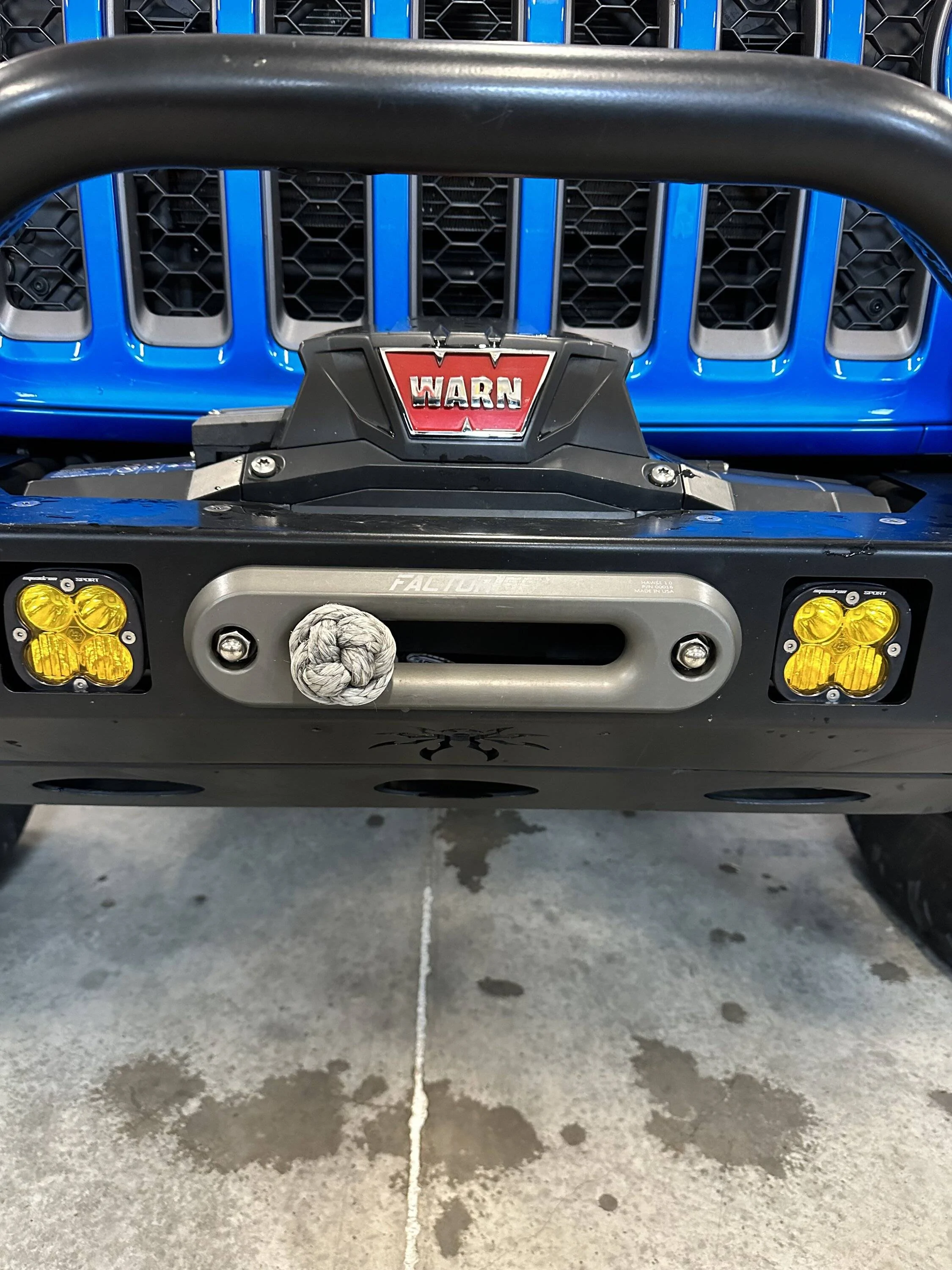

I did this a couple months ago, just stumbled on this post. I was tired of dropping the line in powdery snow and having it sink into oblivion and the extra weight is just another potential missile if something does fail. (Yes I know synthetic isn’t supposed to store energy, etc.) I figure I’ll replace the soft shackle more than I normally would, but that’s a cost I’m willing to absorb.
