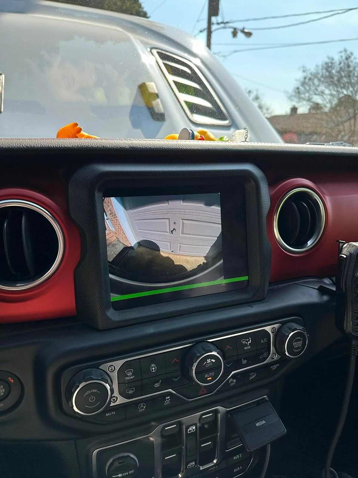

Long story short had to replace the cable and camera on my 2020 JLUR.
Used these PNs:
Genuine Mopar High Mounted Stop Lamp Wiring 68432092AB
New Rear View Backup Parking Assist Camera For Jeep Wrangler 2018-22 68452959AC
I also installed the Terraflex carrier, not sure if that may be a part of the problem or not due to mounting location changes.
In any case I am now met with this. Note that guidelines are enabled in the unconnect system, too
Jeep Wrangler JL New Camera + Tire Mount = Problem? unnamed (2)
Any thoughts and/or solutions are much appreciated!

To add: I also pulled the F11 fuse under hood for 10m or so in an attempt to reboot Uconnect, no change.

Update: was able to free my original camera from the old housing and transfer to the new carrier, tested free and clear.
I am guessing the camera I was sent was/is meant to be paired with the front trail cam? No idea, but for now I’m happy. ?
