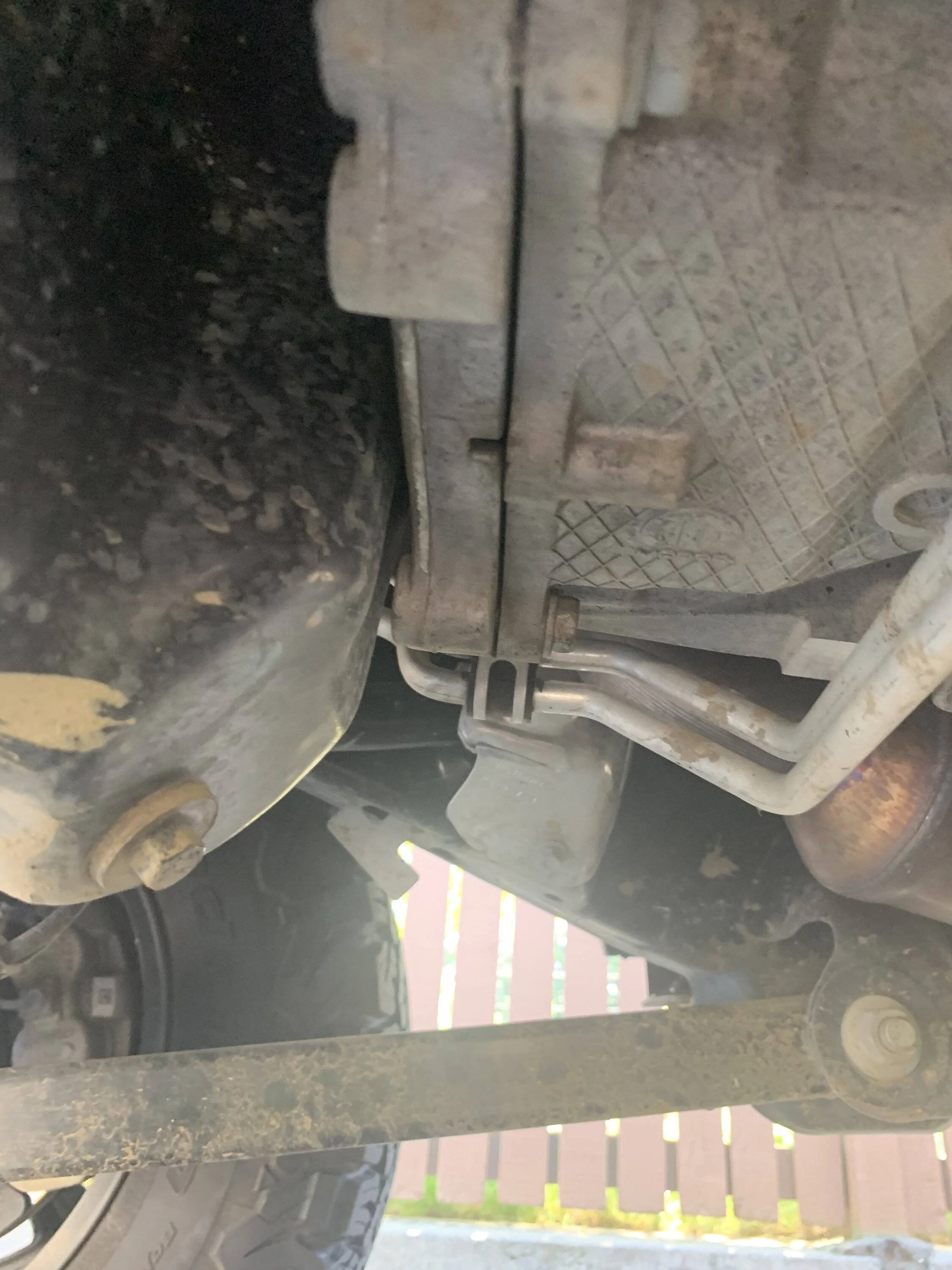

It looked like oil to me, but was dirty, so not totally sure it wasn’t trans fluid, although it had no red color to it. Interesting thought on just having them clean it up and watch it for a while like Left field did. I did check all of the plugs etc. the only spot it was wet was on the bell housing. Smok’em, I am using Davis Moore, have not really used either dealer in town so rolling the dice.
If it’s oil, make sure they check the PCV valve and system. If the crankcase is retaining too much pressure, it will push oil through the seal. It’s not a sign of a failed seal. The seal is made to hold in a certain amount of pressure. If the PCV system is the issue, they’ll fix that and not worry about the seal as it will seal back up just fine.

Hello all,
PIcked up a new Gobi 392 a little over a week ago and drove it back to Kansas from Colorado. Got up the next day to start the detailing process and noticed some fluid on the floor. Found a drip coming from the bell housing right behind the oil pan. Took it to the shop last Friday to be checked out. I was assuming possibly a rear main seal based on the location. They removed an access cover and were not able to see anything....the rear main seal was dry. So the next step is to pull the transmission to see if they can figure out where the leak is coming from. Not a good start on a $80k vehicle with 600 miles. Fortunately still have the diesel Gladiator in the garage to enjoy.
I had a similar issue with my Ram and it ended up being a seal on the transmission. They actually replaced the rear main seal first thinking it was that. I have the same ZF 8HP75 transmission. The ZF fluid is not red but kind of a yellow/green color. It does have UV dye in it from the factory.

When my wrangler was a few weeks old, I saw a little bit (size of a quarter) of engine oil on my garage floor where I park it. I looked everywhere and couldn't find the source and it hasn't happened since I have over a year and 12K mi on it.

I have decided to put some more miles on it to see if it was some residual fluid from the build. Would prefer to rule that out before having them pull the transmission. Will see what happens.
It isn’t. They are assembled dry.
