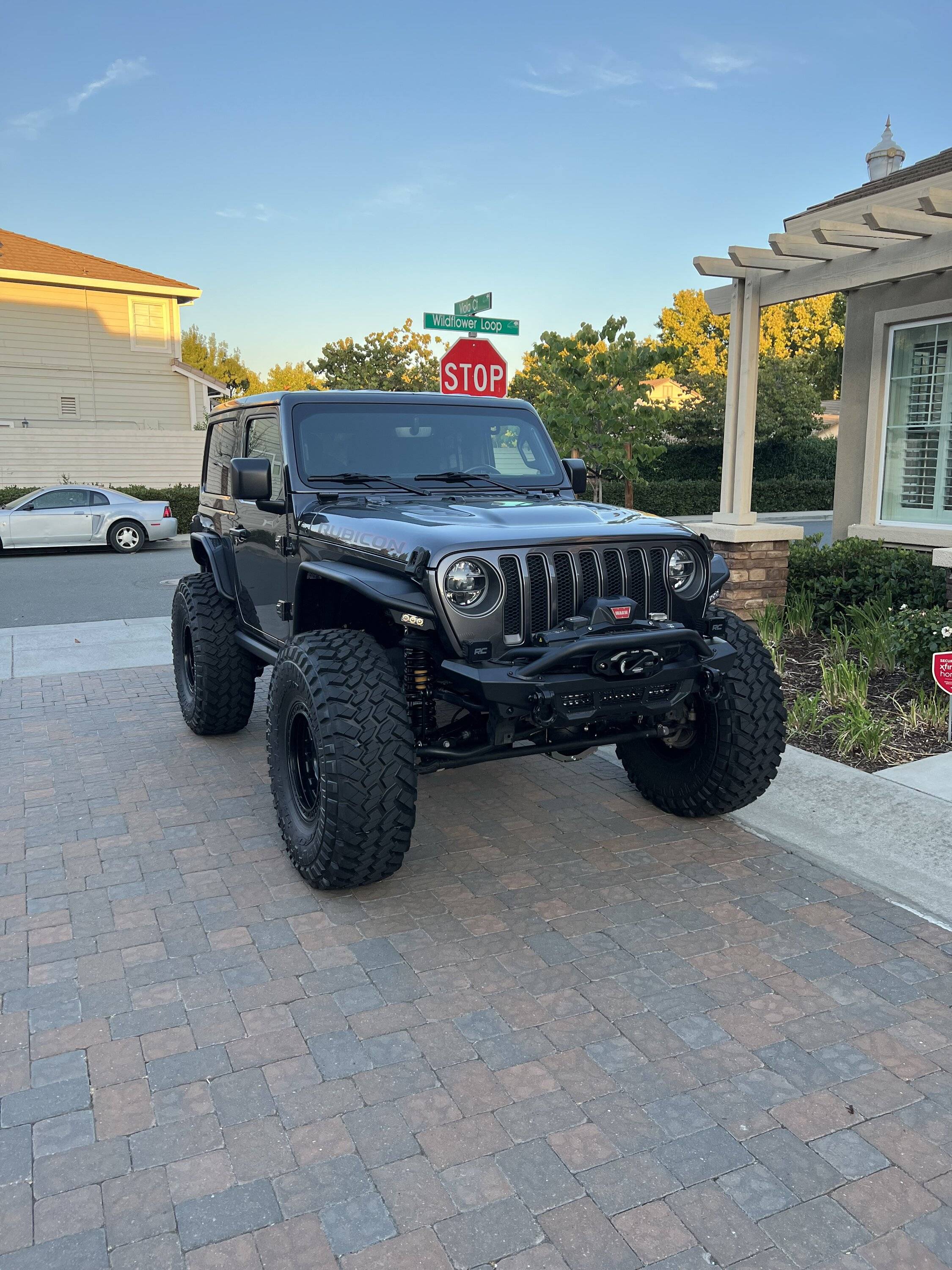

Trying to decide about running 2 in. wheel spacers. Any input would be appreciated.

Thta is a lot of stick's out...but if you go with another 2 inches make sure you get some very high quality spacers...LIKE made from STEEL and forged not cast?
