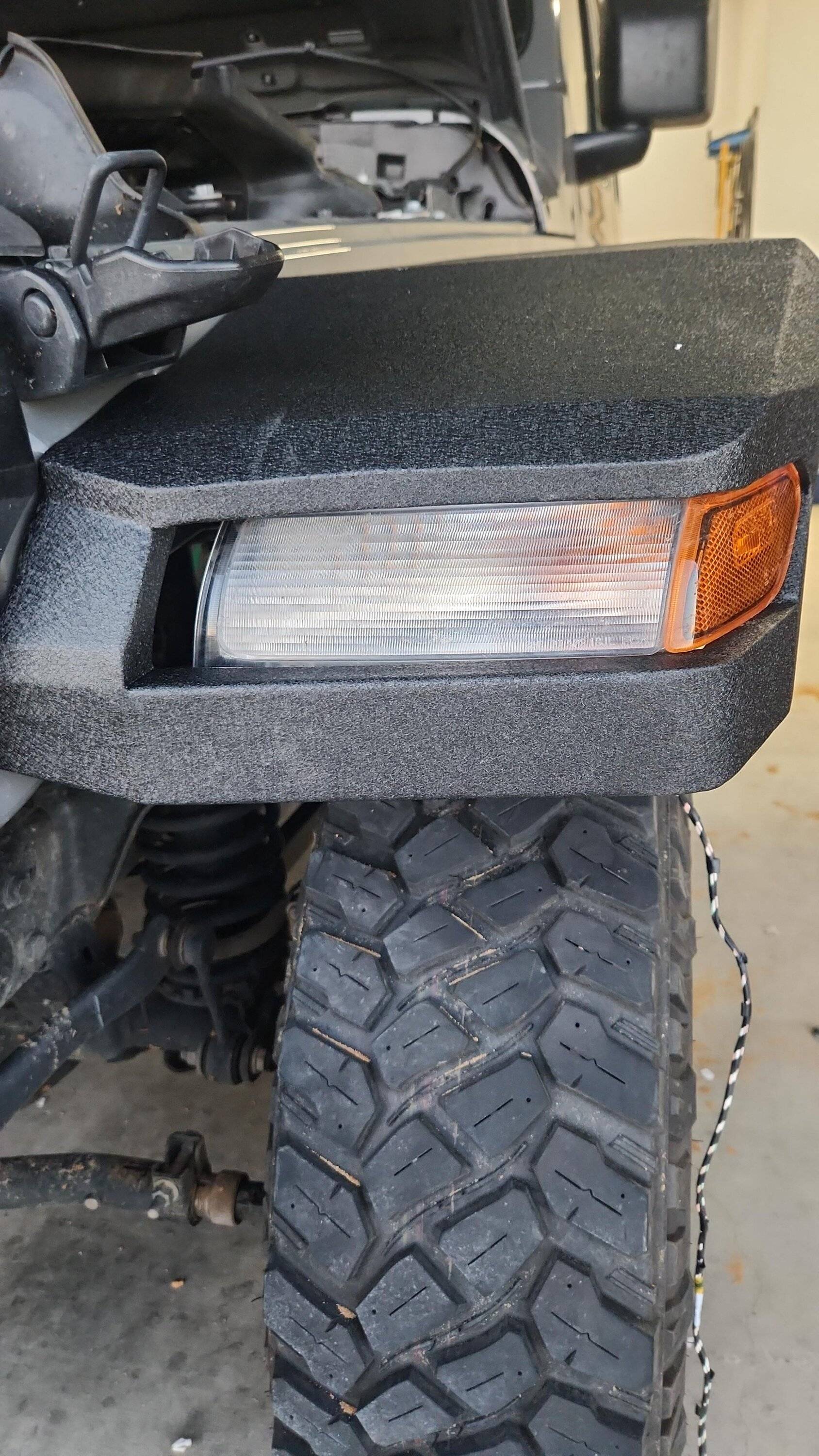

I have a '22 Ecodiesel, im not read up on all this as many of you, forgive the ignorance. I need to know which turn signals go with these fenders I installed today. Got everything done, went to put these back in and they don't fit, they are too small. do I need to order gladiator lights? I've included pictures. what lights do I need to order? TIA

what fenders did you get? and where did you get them?
when i updated to JT fenders on my JLU, they came with the split-lamp turn signals already installed (in which i changed the bulbs to yellow).

I know the highline Rubicon fender lights are different that the rest could be those it needs.

I got them off Amazon, cheapo's they are hooke road. But I liked the look and they match the bumper I got. It says they fit the gladiator amd the JLU...... is there a bigger and smaller light associated with these models?

I think this one only fits the sahara and rubicon trim light.
The sport willys light are single bulb dual function and are shorter.
