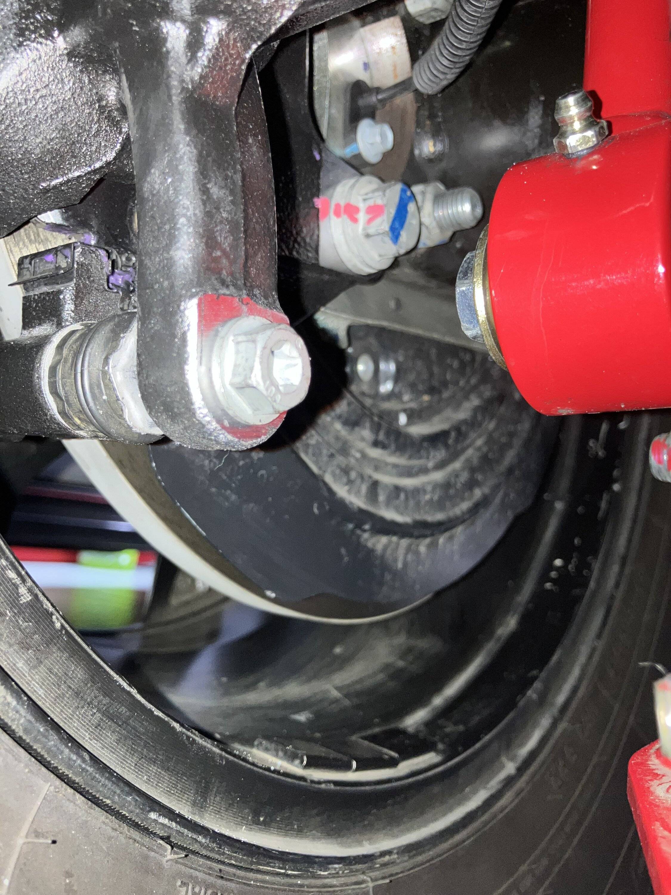

I thought I had my brakes all figured out after I mixed up the rear caliper brackets, but I still have doubts. I need one brave soul with Hd brakes to pull out their driver side rear lower caliper slider pin and post a picture for me. This can be done without removing the wheel, just the one bolt , move the caliper out of the way and slide out the pin. This would remove all doubt for me. The bolt just needs a bit of blue loctite and 27 ft-lbs to go back on. I know it’s a big ask, but it would really help me out.

won't one of these images help? what exactly are you wondering about?

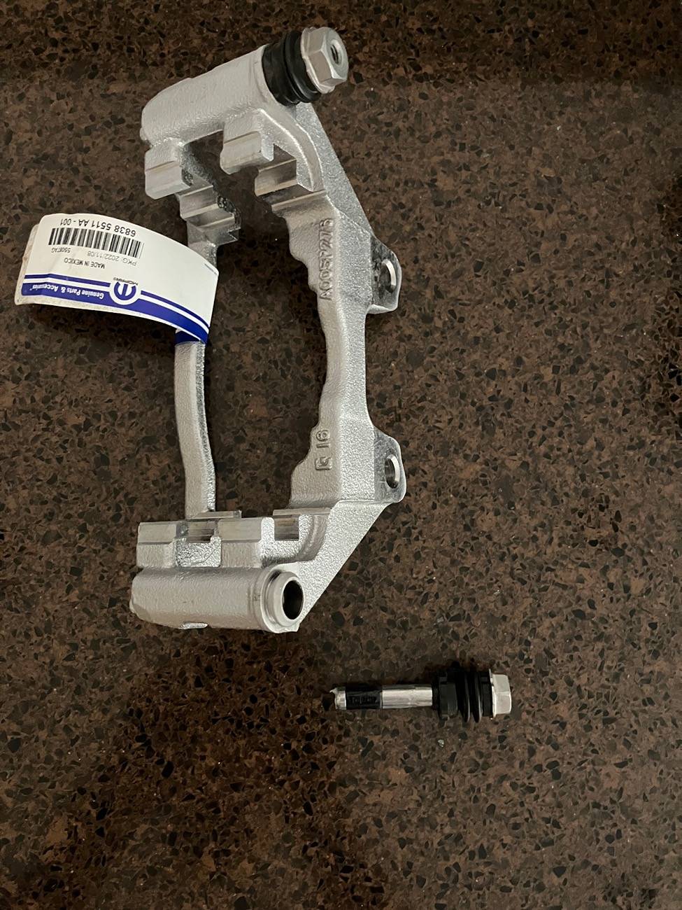

So I got a hold of a new driver side caliper bracket, and in fact the booted pin is on the bottom. No more videos, no more drawings, just an actual part. Lucky for me, I put the brackets back on correctly. A good Saturday is in my future.
