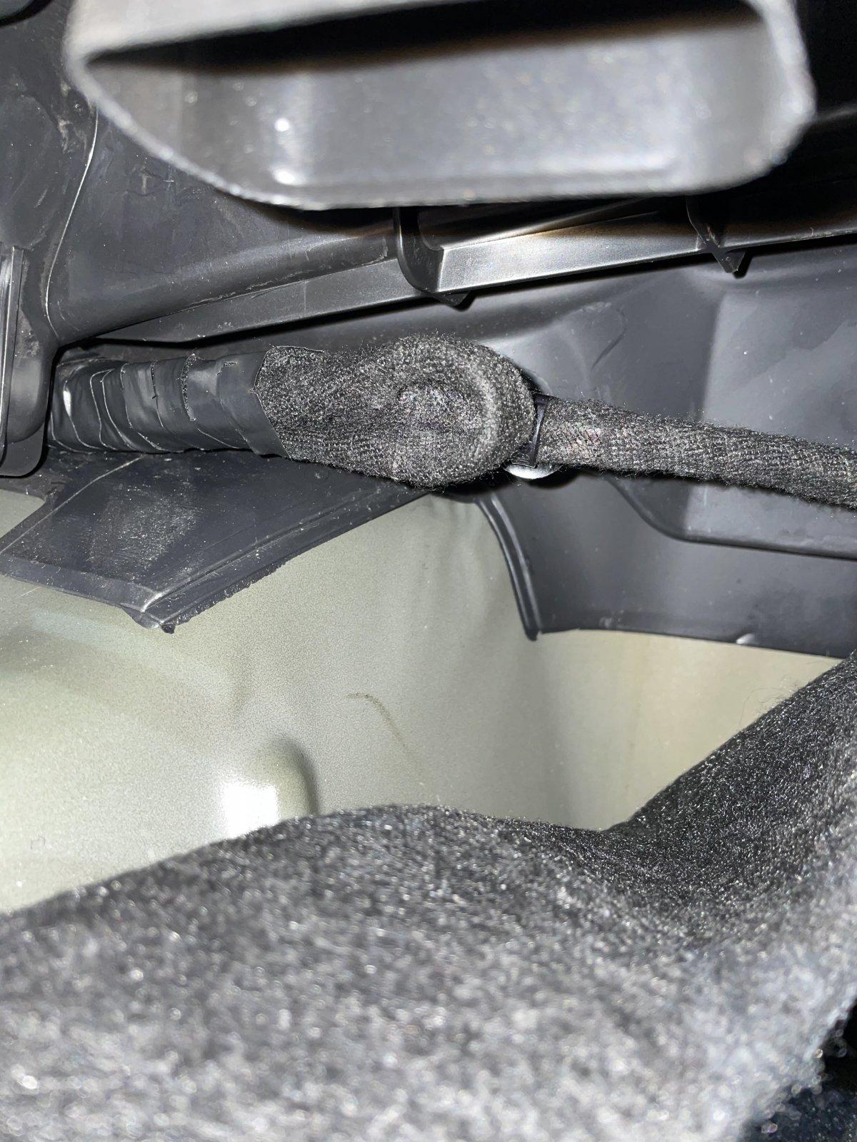

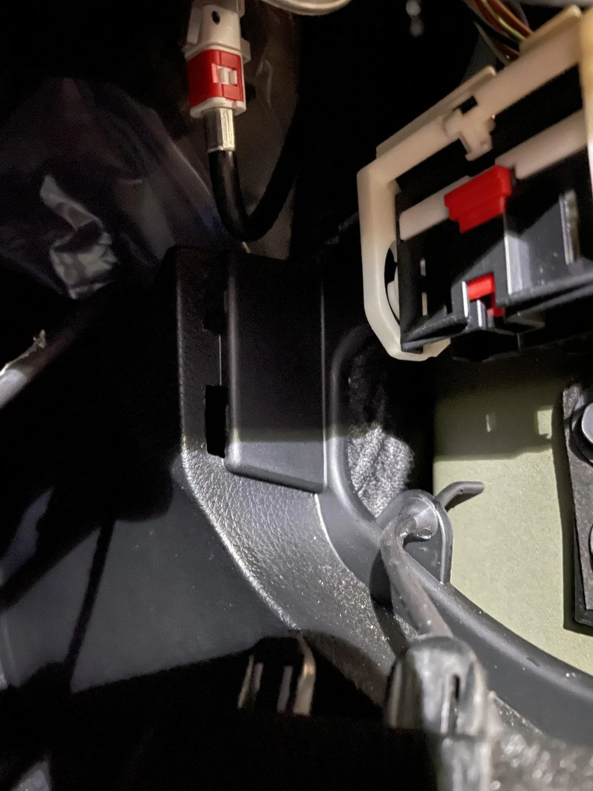

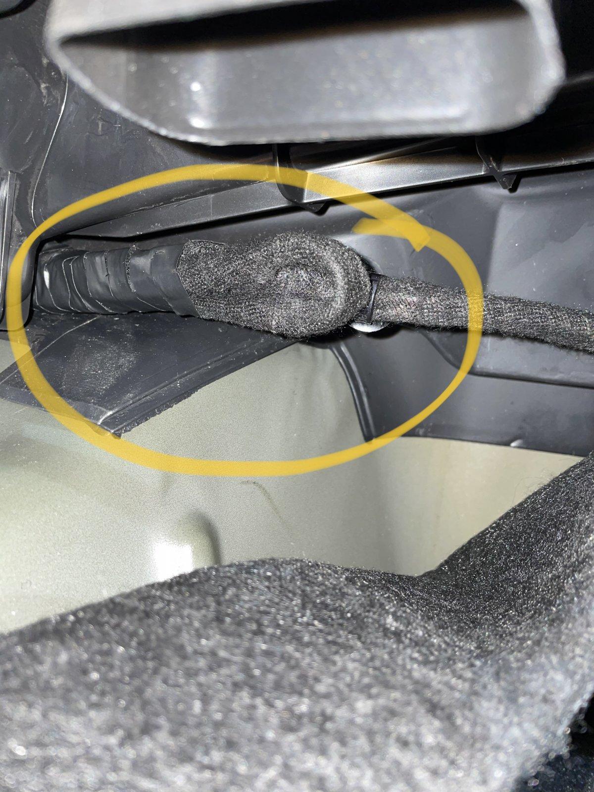

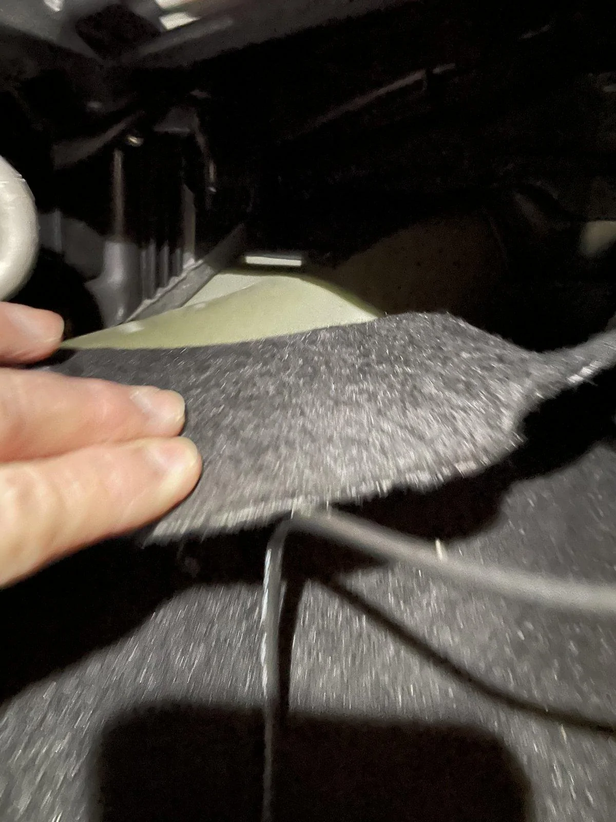

I am trying to install AC be using the inside auxiliary wires I can’t find anything on YouTube that covers the inside wires and where to locate them so I need help. I can’t seem to find any loose wires under there as described in the book there are some tightly wrapped down the wires on the passenger side under the center pump which I cannot get out. Then I read that they were on the side Panel of the passenger side and I’m trying to remove that now to see if they that is where they are. See pictures below

I have pulled on those to the point that I was fearful of screwing something up. Are they latched in or something?
Mine were in there like that. I just cut the tape and started pulling. Once the tape is cut free you can see how it’s attached.
Thank you much! This has been the longest easy project on this Jeep!

As the others have mentioned, the aux wiring is secured and wrapped with electrical tape. Jeep has supplied a decent portion - try not to make any cuts until you figure out how much you need.
