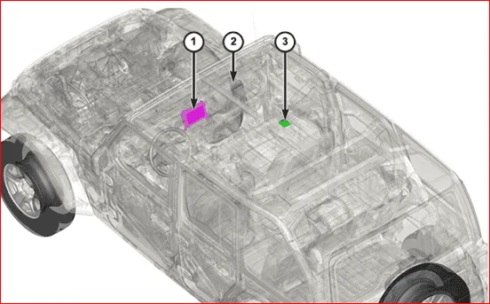

Maybe disconnect the battery for a few, and see if it resets?
Also make sure there isn't anything interfering with the antenna. #3 in the image
I have taken the hard top off and road around put the soft top on and still nothing. I have disconnect all 3 grounds one on the battery and two on the side of the fenders, pulled fuse 12 and 97, and still the same thing. I appreciate the advice, I thought about pulling radio out and unplugging the gps transmitter.
