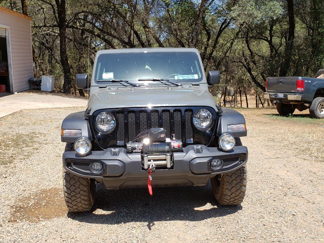

I installed a Smitty Built 9500 winch, stripping off the plastic finish covering to get to the frame. Welding in 3/16" angle iron between the frame to bumper mounts for the winch to mount to - then reinstalling the plastic finish pieces and cutting out the necessary areas for the winch and rollers.

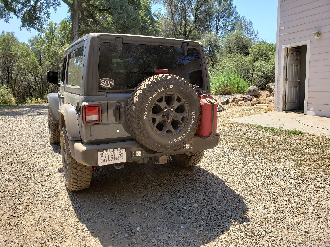

I also wanted to carry some extra fuel, five gallons would do while also wanting more, at least five gallons would get me roughly an additional 100 miles to the next gas station. Not finding what I was looking for on the internet and/or 4x4 web sites, I built my own.
A very simple gas carrier that fits a standard size "5 gal Jerry Can". The carrier uses the same mounting bracket which holds the tailgate on (I did replace the factory bolts x2, with longer harden steel bolts). Best part of this carrier is, the tailgate opens to full length - just missing the right tail light.

Thumbs up for the winch job! You keep the light weight bumper, and the winch doesn't sit on top of it, blocking (some of) the airflow. That's how I would do, if I had the skills.
