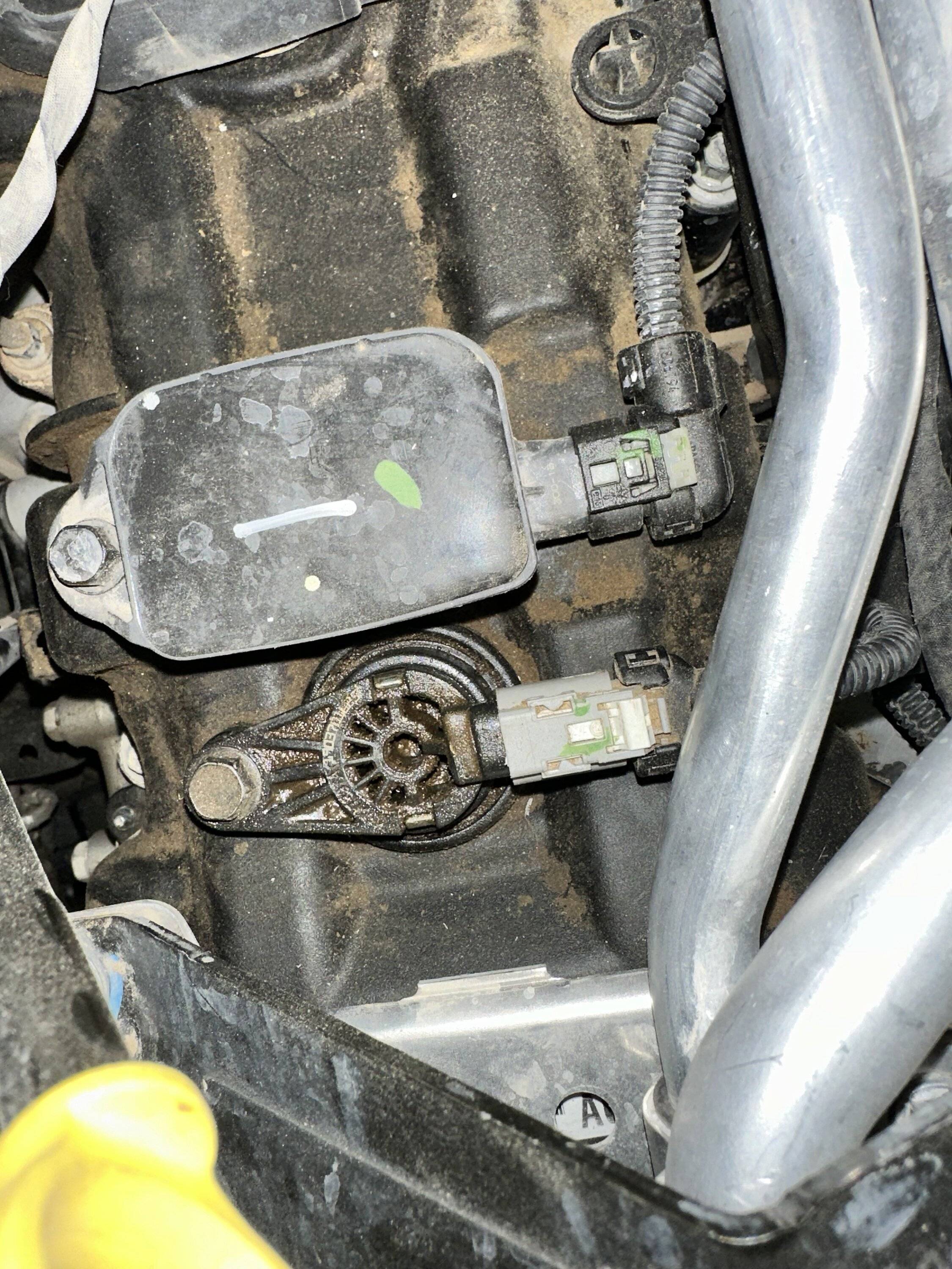

The front VVL had what looked like oil resting on top of it but no oil on engine cover itself. I cleaned it up and used a multimeter to test it along with the power going to it. All good. I attempted to check the VVT but I couldn’t get the leads deep enough to check the sensor. Power going to it is good. I did notice the plug on the top VVT doesn’t snap into place so I taped it down. Reset the codes. 2 trips out and so far no lose of power. Hopefully it is something that simple

The front VVL
I’ll be checking the VVT and VVL tonight since they are easy to get too. Any suggestions on what to look for?
Remove the solenoid and check for internal metallic contamination
I removed the VVL and it is functioning properly no metallic contamination. The VVT was not removed but I will double check it
When you say VVT, what are you talking about? VVT means variable valve timing. Are you referring to the camshaft timing actuator on the front cover? If so, no point in removing that one, you can't really see anything on it.
What is your indicated oil pressure at idle at Normal Operating Temp?

Yes camshaft timing actuator. I can check the oil pressure tomorrow
Monitored the oil pressure all week. At idle it was always around 30. 28 was the lowest and 33 was the highest. No change when I lost power
oil temp were mostly around 210 with 233 being the highest and dropping into the 190s after losing power
one of the fuel injectors started ticking on the bank one side so those 3 will be swapped out once the parts come in. I’m also going to swap the camshaft position sensor as someone said that is what caused their jeep to lose power anytime they went above 4K rpm.
