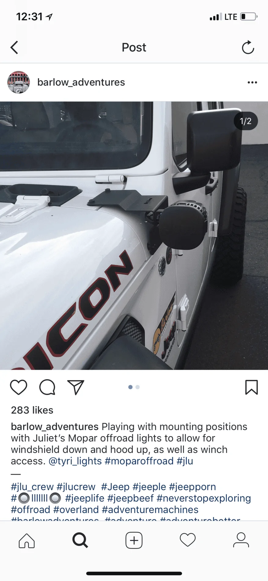

www.ruggedradios.comI want to mount an antenna for a county fire department radio. I can't find a simple bracket to do this as the bolt pattern changed from the JK to the JL. Would this bracket be high enough to get the wire under it and out to the car? Look too clunky?

I know it's been a while, but to answer your question yes there is enough room. I bought the Mopar light mounts for this reason, to mount my 2m/70cm NMO antenna to it by drilling out one hole. I know there is definitely enough room to mount an antenna and run the coax either under or behind the mount. I chose a different location though, you can see my thread here if you're curious https://www.jlwranglerforums.com/forum/threads/ham-radio-install-w-pics.9490/#post-243195I want to mount an antenna for a county fire department radio. I can't find a simple bracket to do this as the bolt pattern changed from the JK to the JL. Would this bracket be high enough to get the wire under it and out to the car? Look too clunky?
I checked out the link.......it was quite helpful, thank you. I decided on a different bracket setup - I'll use the tailgate door hinge bolts to mount a bracket for the antenna. What I did see in all this is that it will be easy to mount a bracket to hold the remote head for my Motorola county radio. All in all, I really appreciated all the comments, they were quite helpful.I know it's been a while, but to answer your question yes there is enough room. I bought the Mopar light mounts for this reason, to mount my 2m/70cm NMO antenna to it by drilling out one hole. I know there is definitely enough room to mount an antenna and run the coax either under or behind the mount. I chose a different location though, you can see my thread here if you're curious https://www.jlwranglerforums.com/forum/threads/ham-radio-install-w-pics.9490/#post-243195
