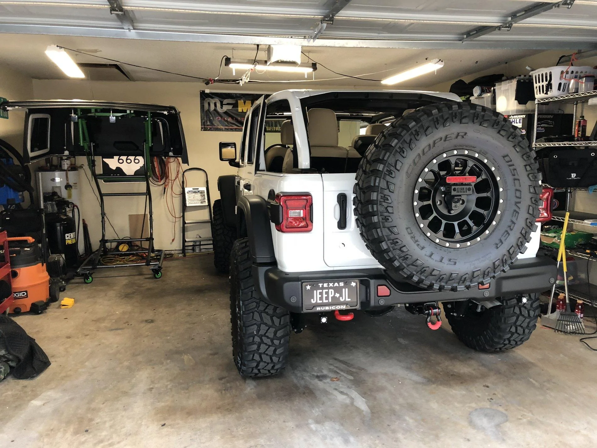

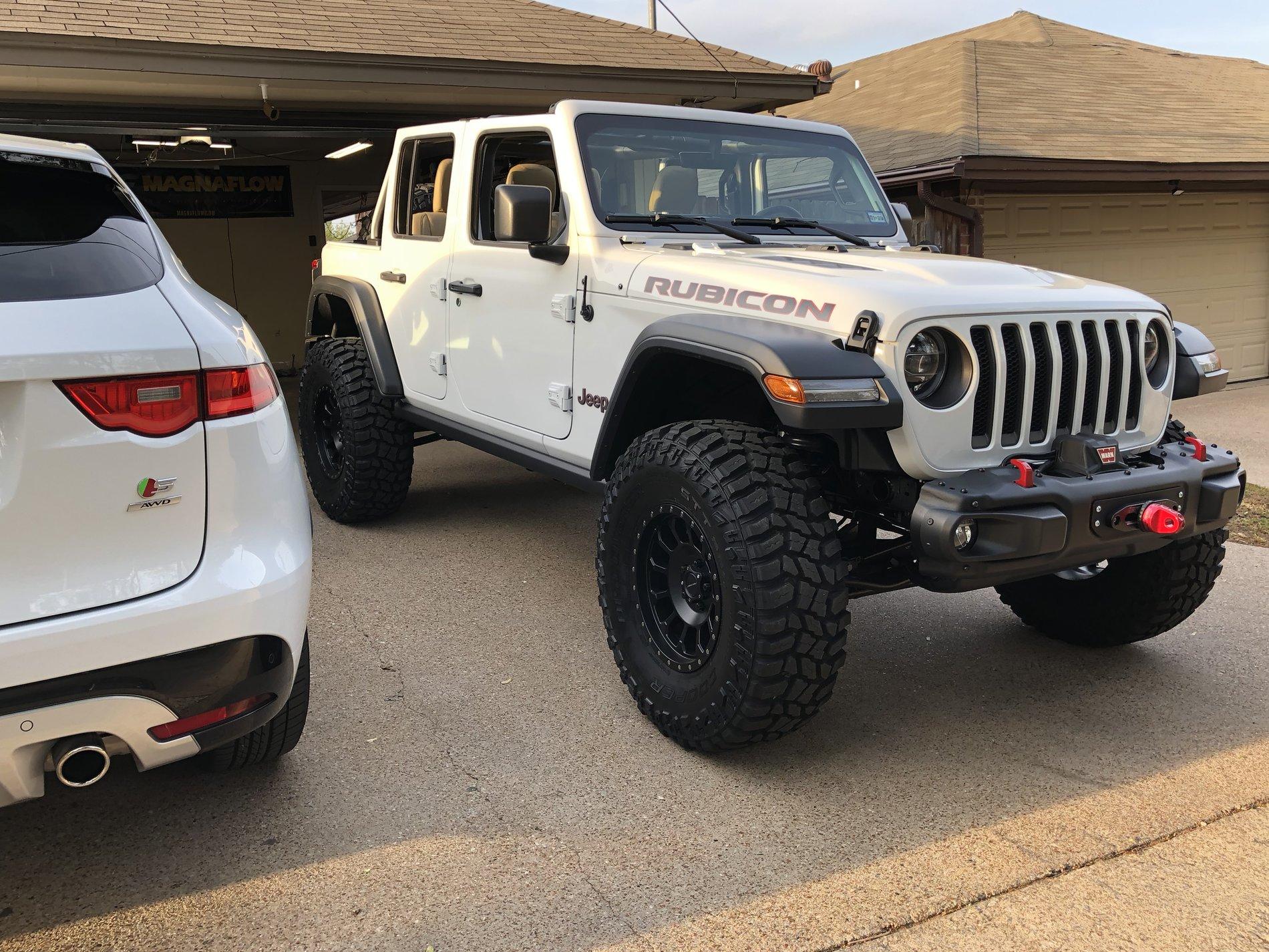

35’s fit on a Rubicon without a lift but a 1.5-2” lift would be perfect. First pic is 35’s and no lift. 2nd pic is 35’s and 2.5” lift

so you went to 2.5 instead of 1.5

Yes. I went with a Rough County 2.5” budget boost and then I replaced it with a 2” Mopar lift. The Mopar lift is a little more than 2”.
The Mopar lift is a complete suspension lift with new coils, shocks, front LCA’s and the RC 2.5 budget boost is just coil spring spacers, shock extension brackets and longer end links. That’s why it’s only $175 versus $1500.
