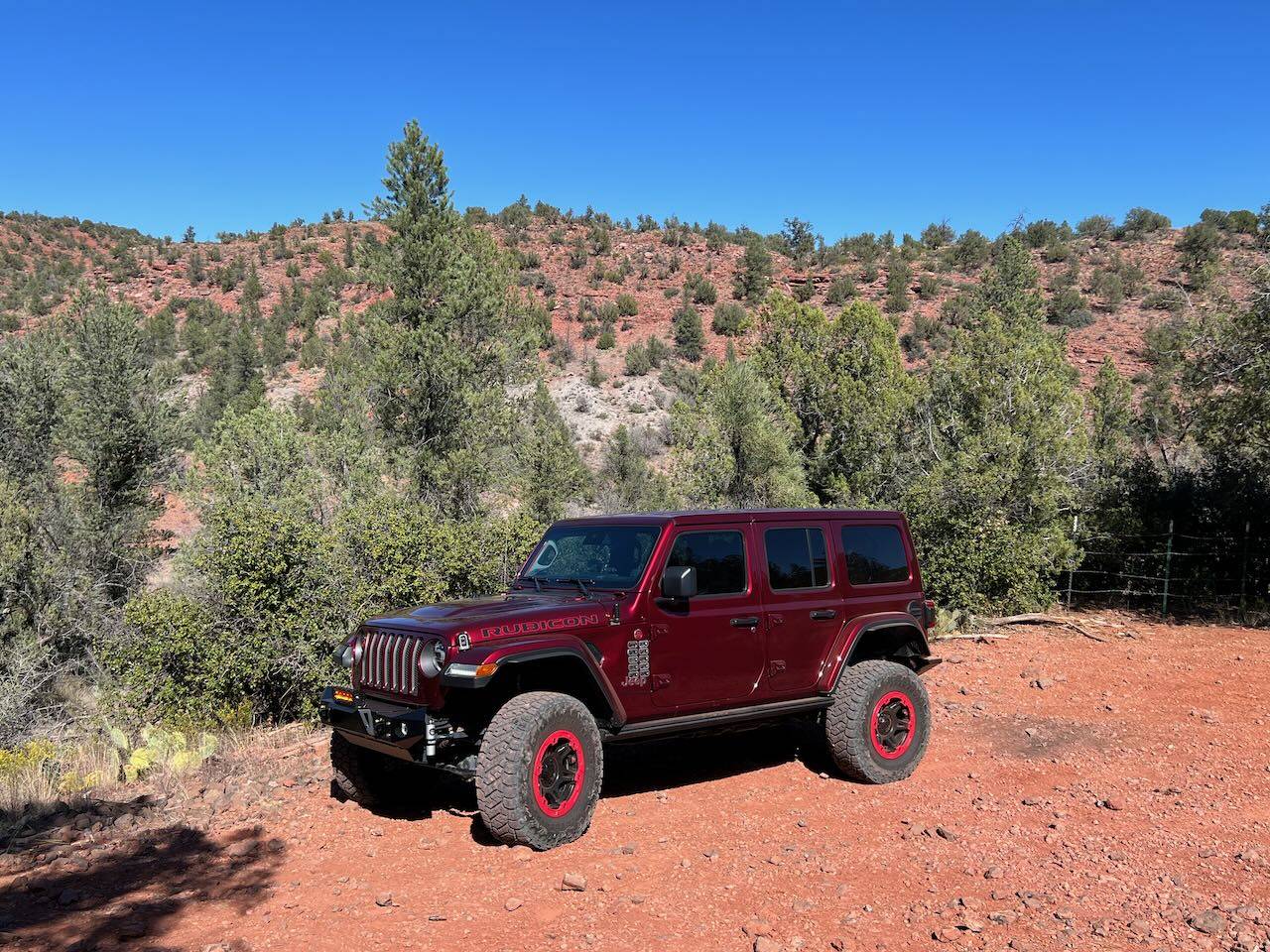

I have a 2021 JLURD and recently had the Mopar lift kit with the BIlstein remote reservoir shocks installed. I gained about 2.5 inches in the front and 2 inches in the rear.

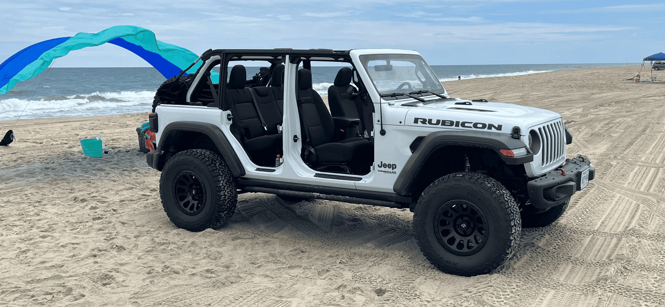

Here is our 22 JLUR with Mopar lift and 315/70 KO2s. I had closer to 3 inch lift in front and roughly 2.5 in back. The Fox shocks ride great. You will have to put adjustable track bars on as the kit doesn’t include them.

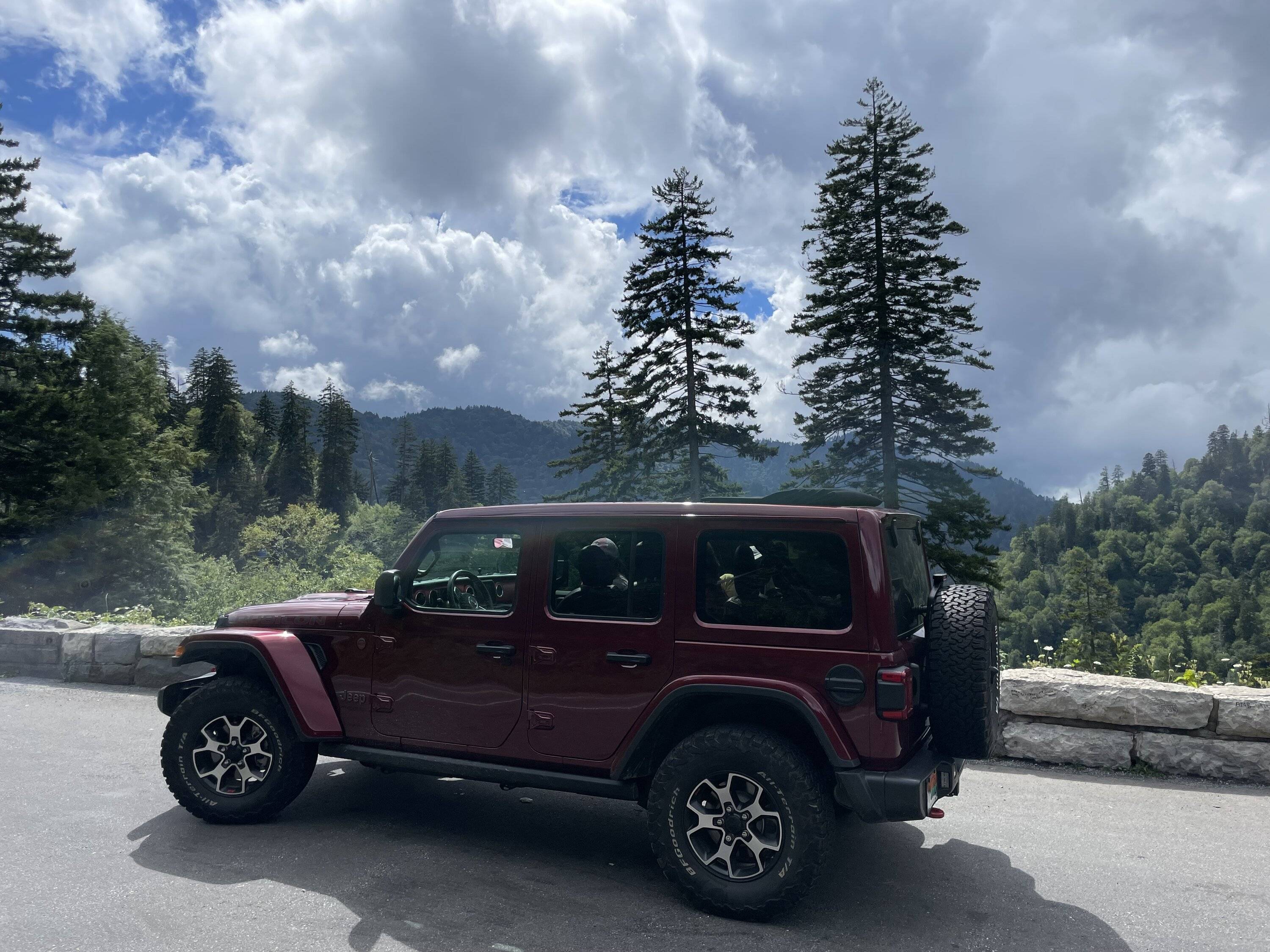

Awesome! Are you on 35s in this photo?

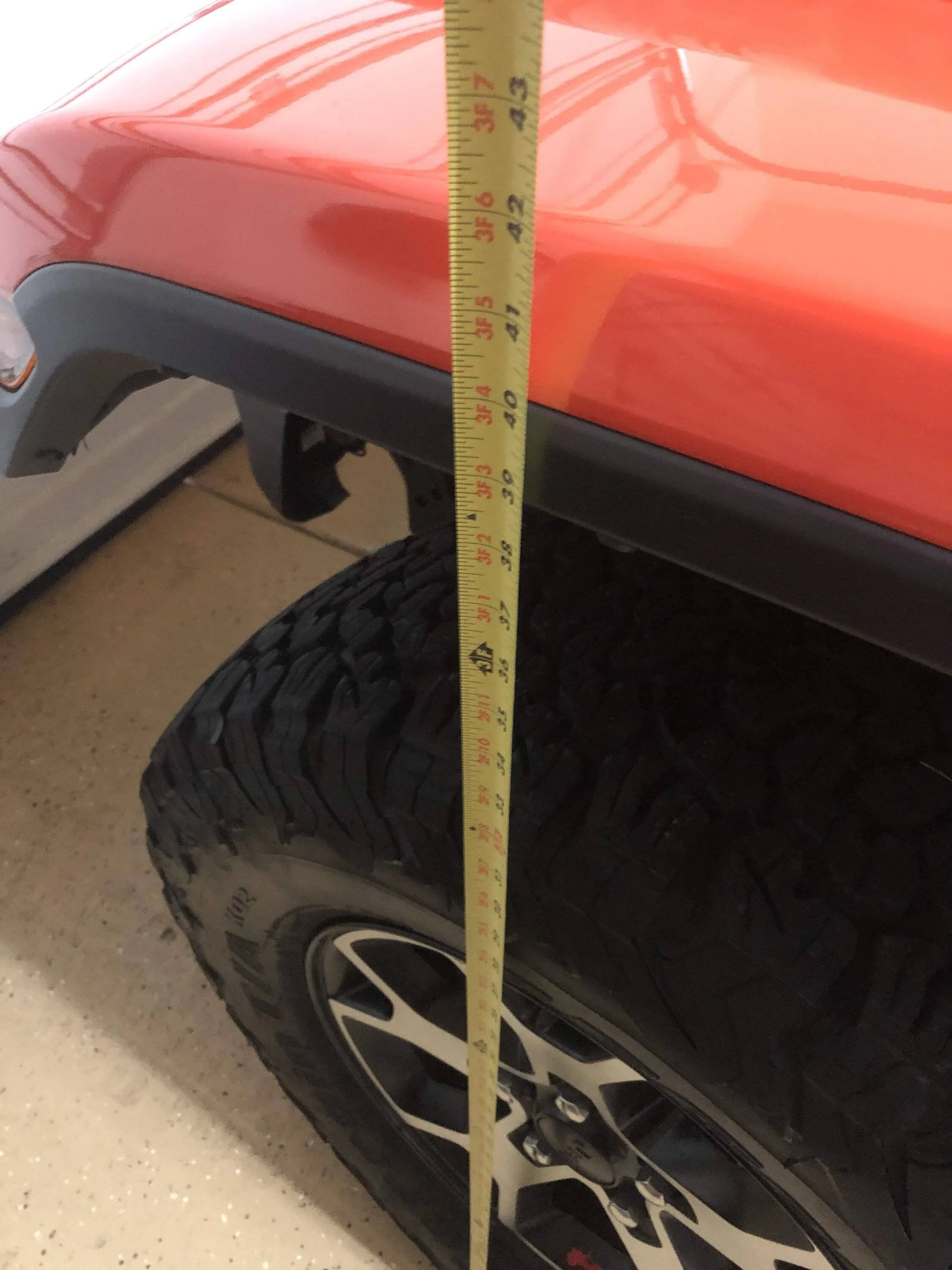

Raised my 2023 2door rubicon 3.375 inches, I measured accurately
