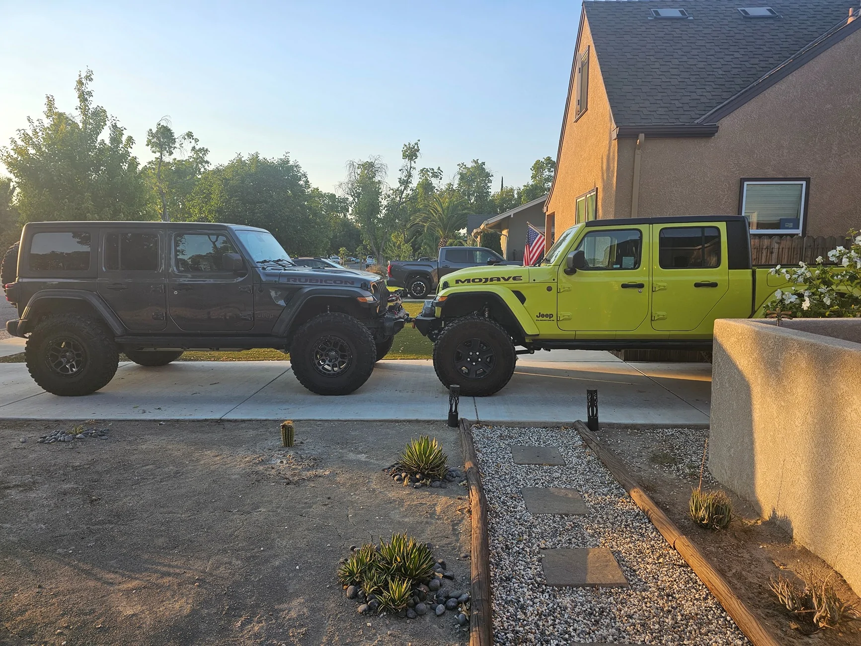

Depends on the quality of the 3.5" lift. Most companies account for some added build weight. Both the wife's JLUR and my JT run metalcloak 3.5" springs and even with the winch, full skids, and 39 hanging off the back they are still at 3.5-4" over stock height.
Jeep Wrangler JL Modified 3.5 lift 20250823_071749
