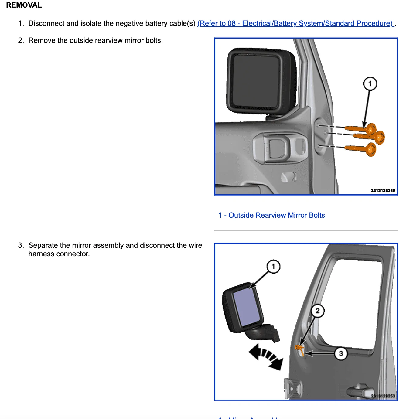

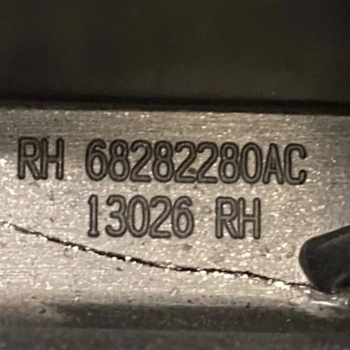

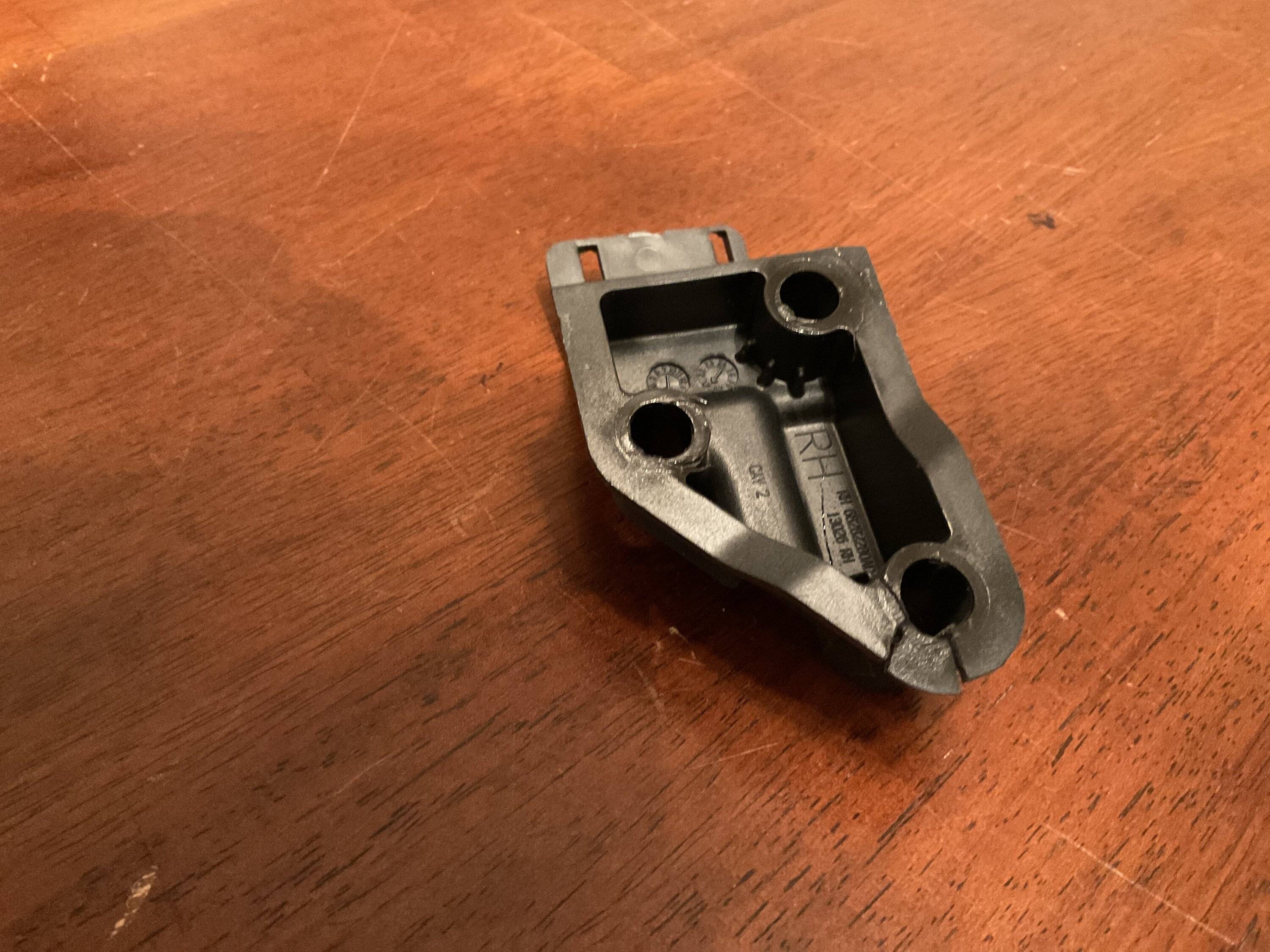

Ordered the mirror, but when I took the old one off, there is a plastic bock inside the door that acts as a spacer for the three bolts that hold the mirror. That plastic block is also smashed (seems like it did its job), so I need to replace it, but I can't find it on any parts list.
where is the best place to look for obscure parts like that?
