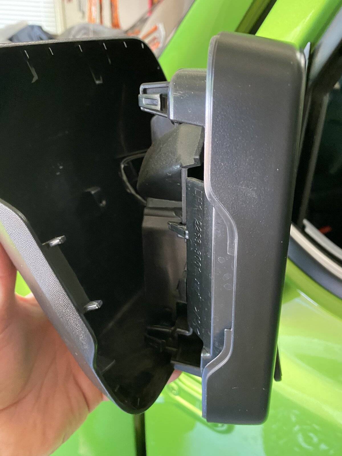

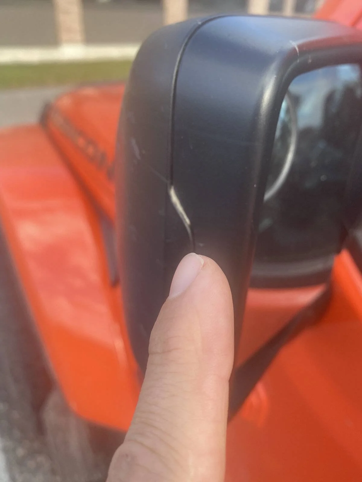

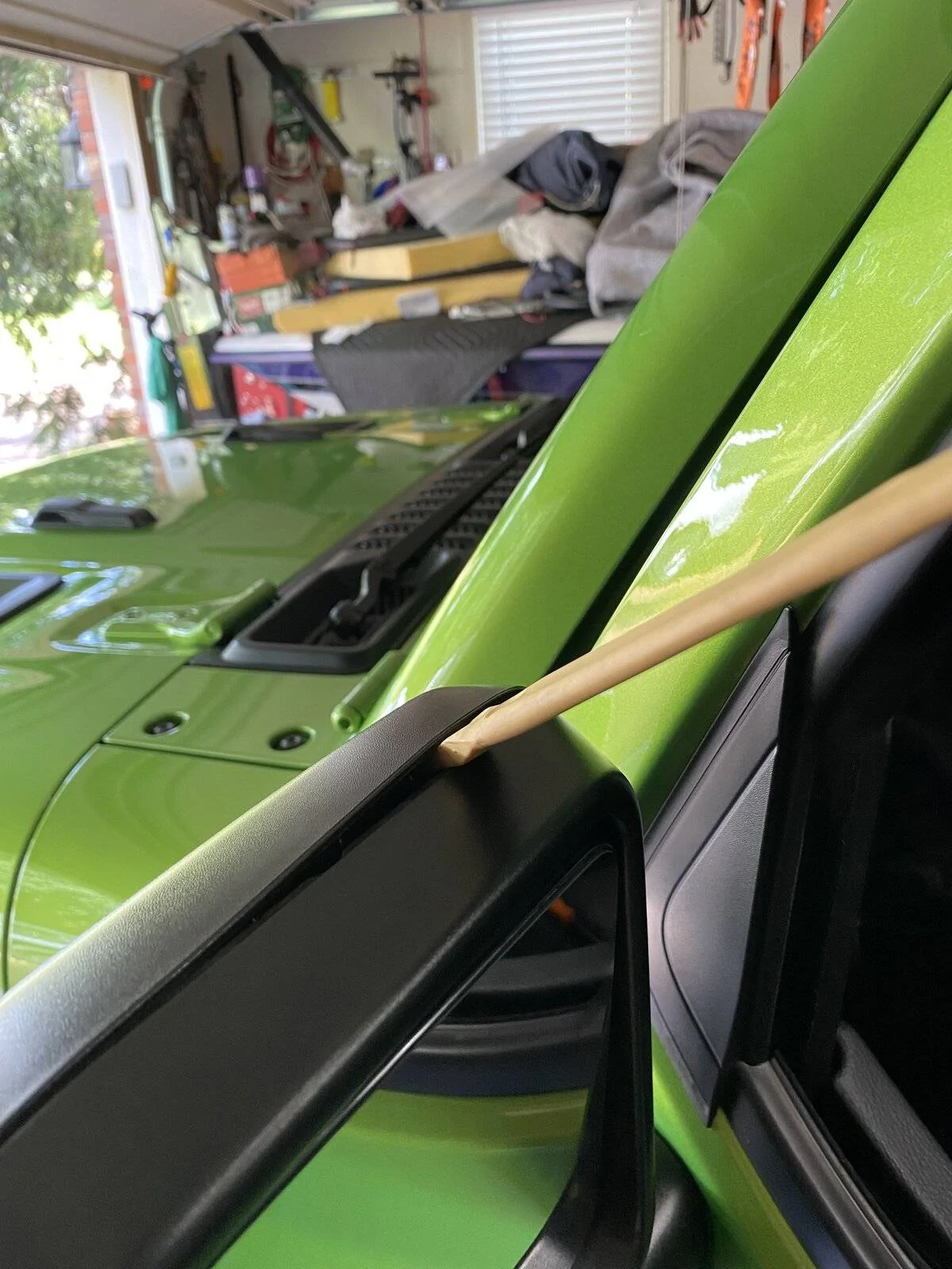

Mine was doing the same thing. I’d put my hand on it and it would go away. I found that in the seam of the housing I slipped a small thin piece of cardboard and trimmed it off with an X-Acto knife That has stopped it for the past year. Where I mean is on the black housing for the mirror. About an inch and a half back there’s a seam that runs all the way around the mirror I place the cardboard in the far outside part furthest from the door
