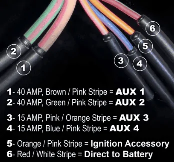

Going to install a midland mxt400. This requires wiring to the battery and a good ground. I have the aux group, can I wire straight to one of the aux cables under the passenger side dash? If so which one should it go to? Thanks
