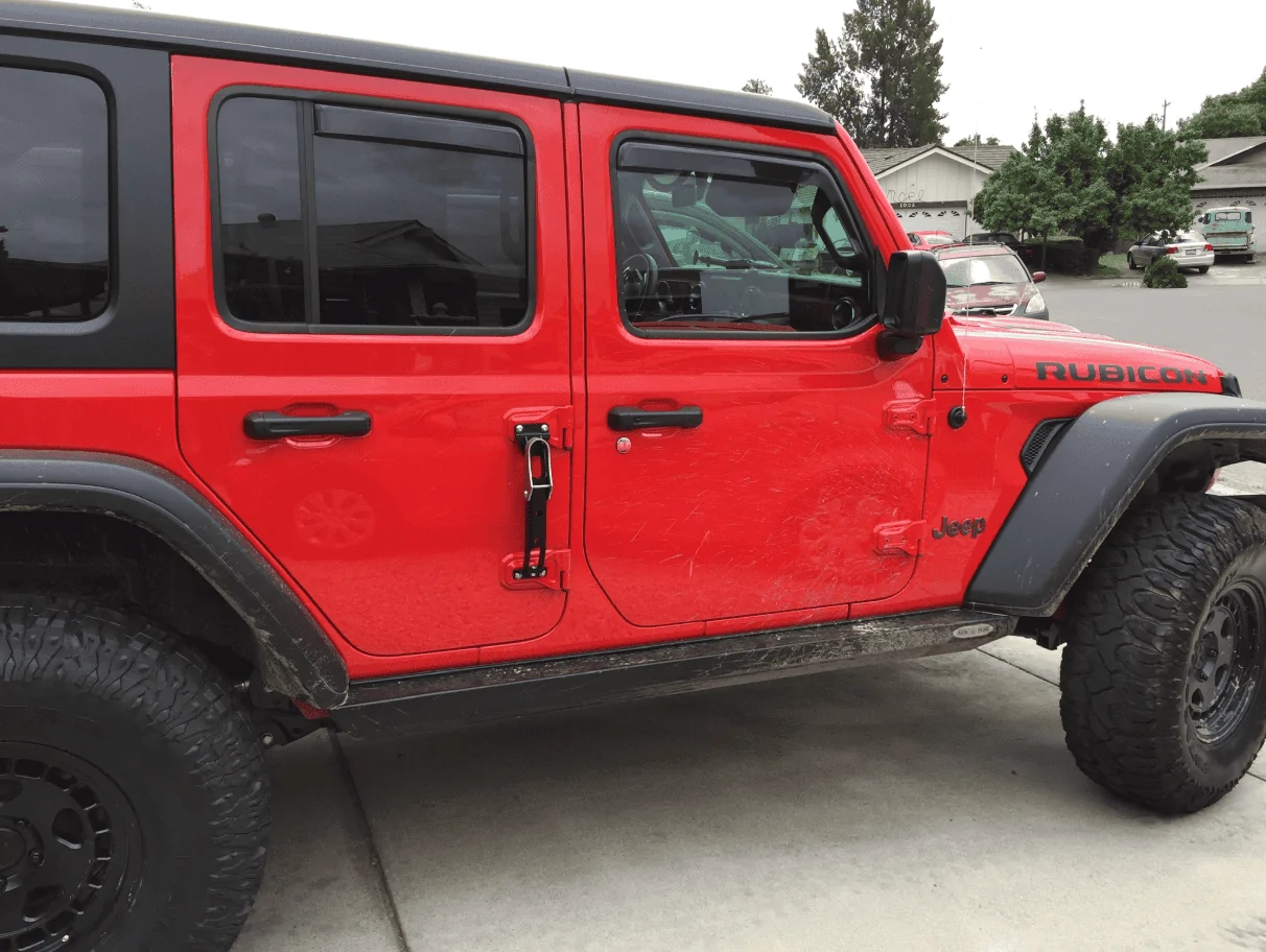

MetalCloak has the best customer service of any company I have ever dealt withFinally got my Metalcloak Pro Step hinge steps installed. The hardest part - getting the factory hinge bolts off.
Finished product

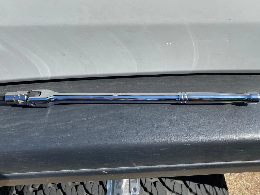

The breaker bar was instrumental in taking off the factory bolts. Combine with a quality T50 Torx bit. I almost gave up and decided to use extractor bits, but i'm positive that if you use the breaker bar to begin with (before stripping the heads), you should be fine

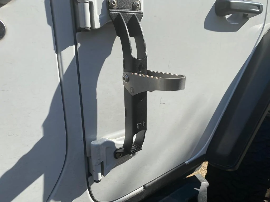

Below is everything that came in the box (almost).

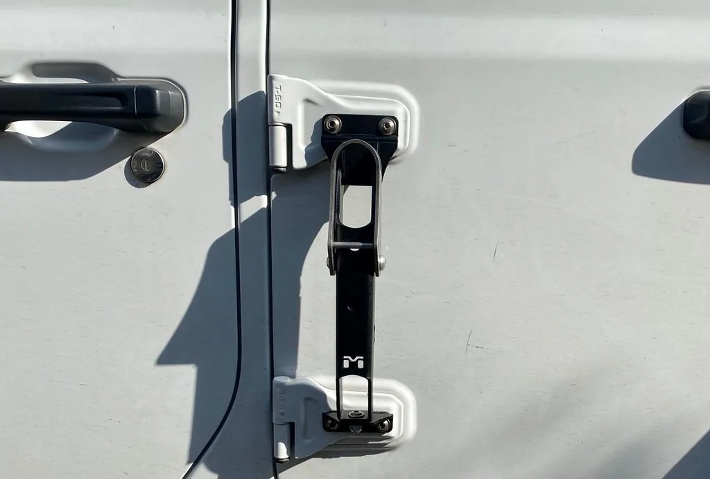

Special shoutout to Metalcloak for the plastic spacers. Great quality and already molded with the protrusion for the holes in the hinge. No need to worry about additional washers, etc. Note, I said almost everything came in the package. I was originally sent the JK spacers, but this was remediated promptly by Metalcloak. They overnighted me the replacement JL spacers via Fedex at their own cost.
Once again, excellent quality spacers. Even has their logo on it.
