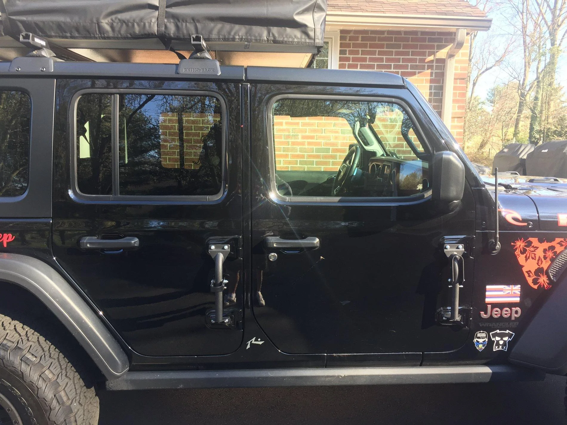

I got all of them out using a breaker bar. I made it to the last bolt and it started to strip. I knew it was going to happen. I started to sweat a lot and pleaded with God. It came out, but I definitely had a moment there. But yes, it can be done.
Looks good. Do you think its so difficult because of the paint or are they just torqued on real tight?
I saw this video on YouTube showing the channel owner using a small spring loaded punch to work around the bolts and him saying it is because of the paint. Looked like it made it a little easier to get the bolts out.

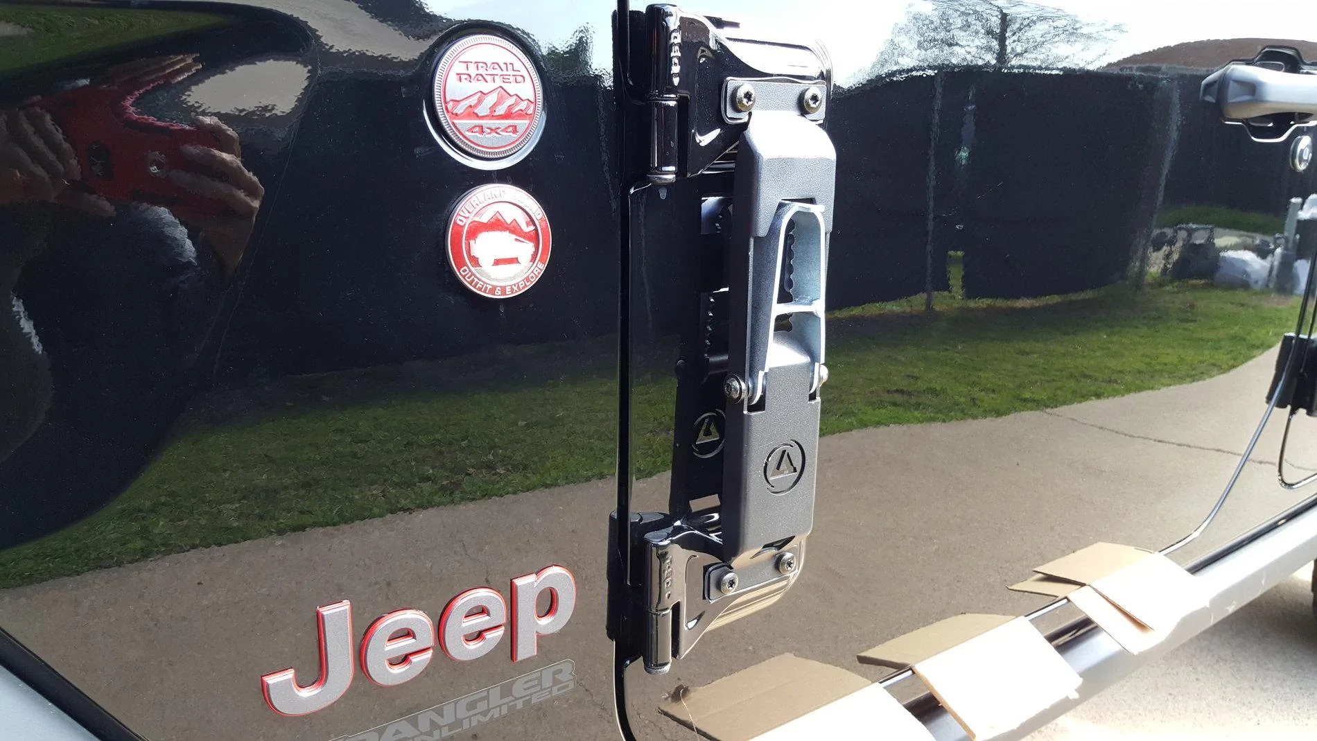

Update - I actually managed to remove the bolts using a breaker bar!!! Started installing the Metalcloak Pro Step hing steps and realized they sent me a wrong spacers, JK instead of JL. They just confirmed that they are overnighting them, so should have my steps installed then.
Hmm, never thought of using a punch. I actually think it was torqued way too tight AND it was the paint. I know some people have used a heat gun (carefully, of course) and said that makes it easier. But with a breaker bar and a whole lot of patience you should be able to do it.

Fits perfect everyone!

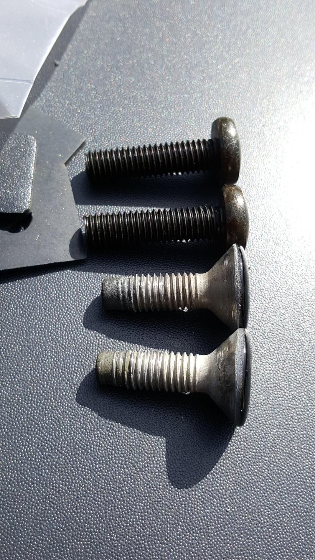

Did you notice if there was any Loctite on the OE bolts you removed?
I'm sorry Russ, I didn't notice...but I sure felt as though there was! What steps did you go with?

No prob. I just saw a picture on pg 2 in this thread comparing the OE bolts to the ones that come with the step. Doesn’t look as though they had loctite on them.
