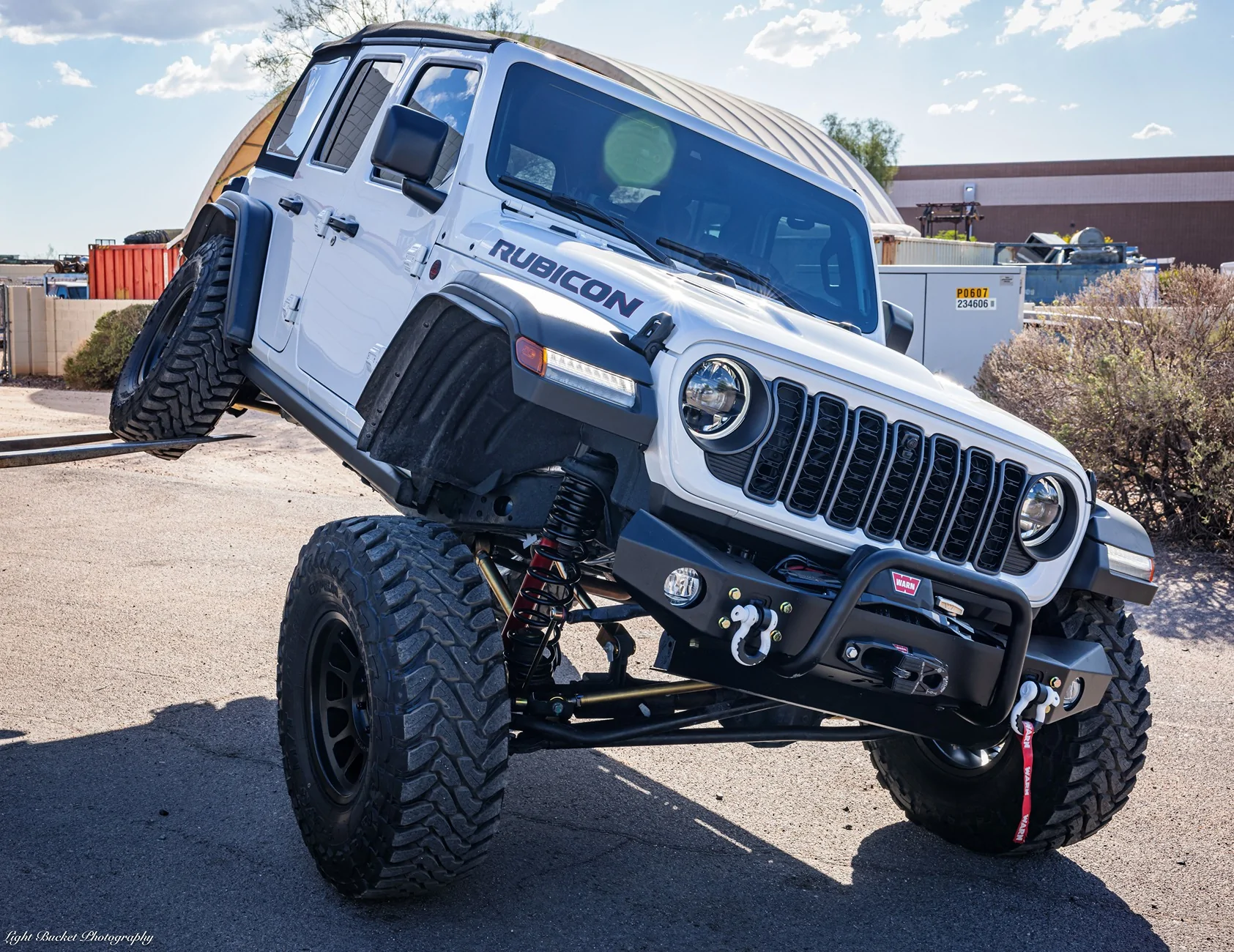

I never thought there could be a huge upgrade to a rubicon XR but i was wrong... Metalcloak 3.5 game changer is truly game changing :)
Looks great!👍🏽 👍
