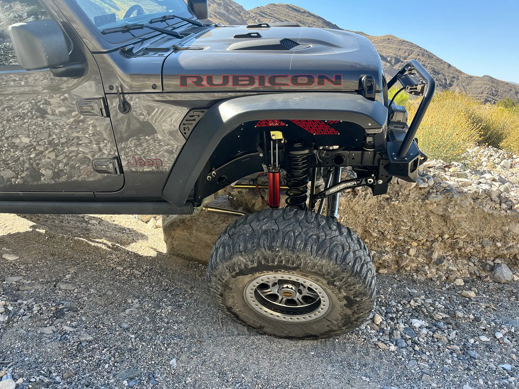

I have run both. Started on Reds then swapped to Silvers. In my opinion, the Silvers provided me a better on road feel all around and did well off road. I have used them in the rocks through The Rubicon/Moab, and through faster off road stuff down in Barstow, CA. Now, I just swapped back to the Reds/Slates because I miss the travel they provide over the silvers. Silver front compressed is 18.4 and extended is 28.4 inches. Rear silver compressed is 19.4 and extended is 30.6 inches, vs the reds which are 17.3 compressed and 30 inches extended front and rear. The Reds/slates do very well on road and off road too, they are just a little softer on road vs the silvers. I am on Metalcloak 3.5 rocklander kit running 40's.
