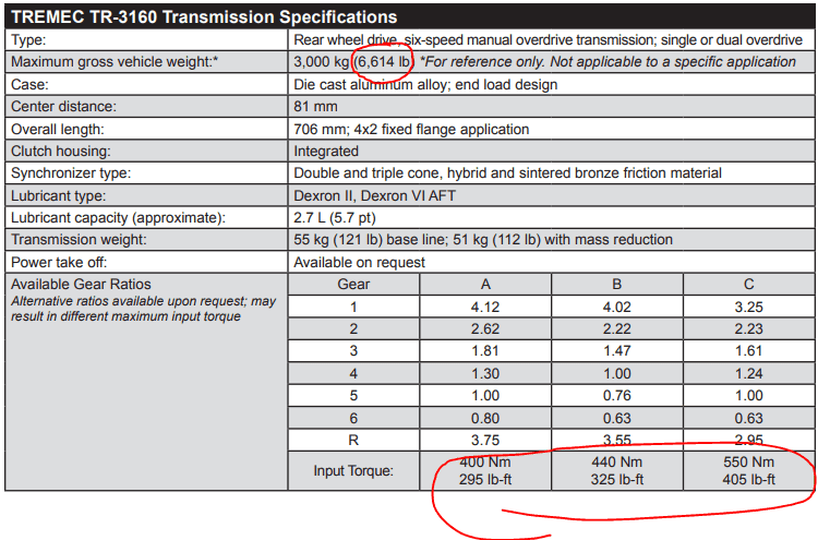

The Shelby GT350 has 429lbs of torque at its peak. The Ecodiesel has 420, from what I've read. The 3.6 is way short of that, so how is that a weakness? Maybe it can't handle much of a towing load?
Perhaps it has do with the low first gear? The JK has a 4.4 1st. Looking at the spec sheet, the lower the gear the lower the ft/lbs
http://www.tremec.com/anexos/TREMEC_TR-3160.pdf
It ranges from high 200s to low 400s. Also, the Wrangler has more weight to move around.

So, how does it handle the torque of the V8 powered Camaro and Mustang? I'm guessing that chart is for the Cadillac ATS version. It also says at the top, for reference only, not applicable to a specific application. That tells me that it can be tailored to a specific application, such as the GT350. I'm hoping that's the case, because the shifting feel of this transmission should be light years ahead of the current 6 speed.
Chart is for all 3 applications, Caddilac, Camaro, and Mustang , and in that order IIRC
Torque numbers are guides, in the same way that despite detuning the export CRD Wrangler exceeded the NSG370's 370NM rating by 11% @ 410NM (full power 460NM on the NAG1)
While Tremec states custom configurations are available, it is still limited in that package, and expecting raising both significantly is unrealistic, slight boosts with still some offset is most likely.

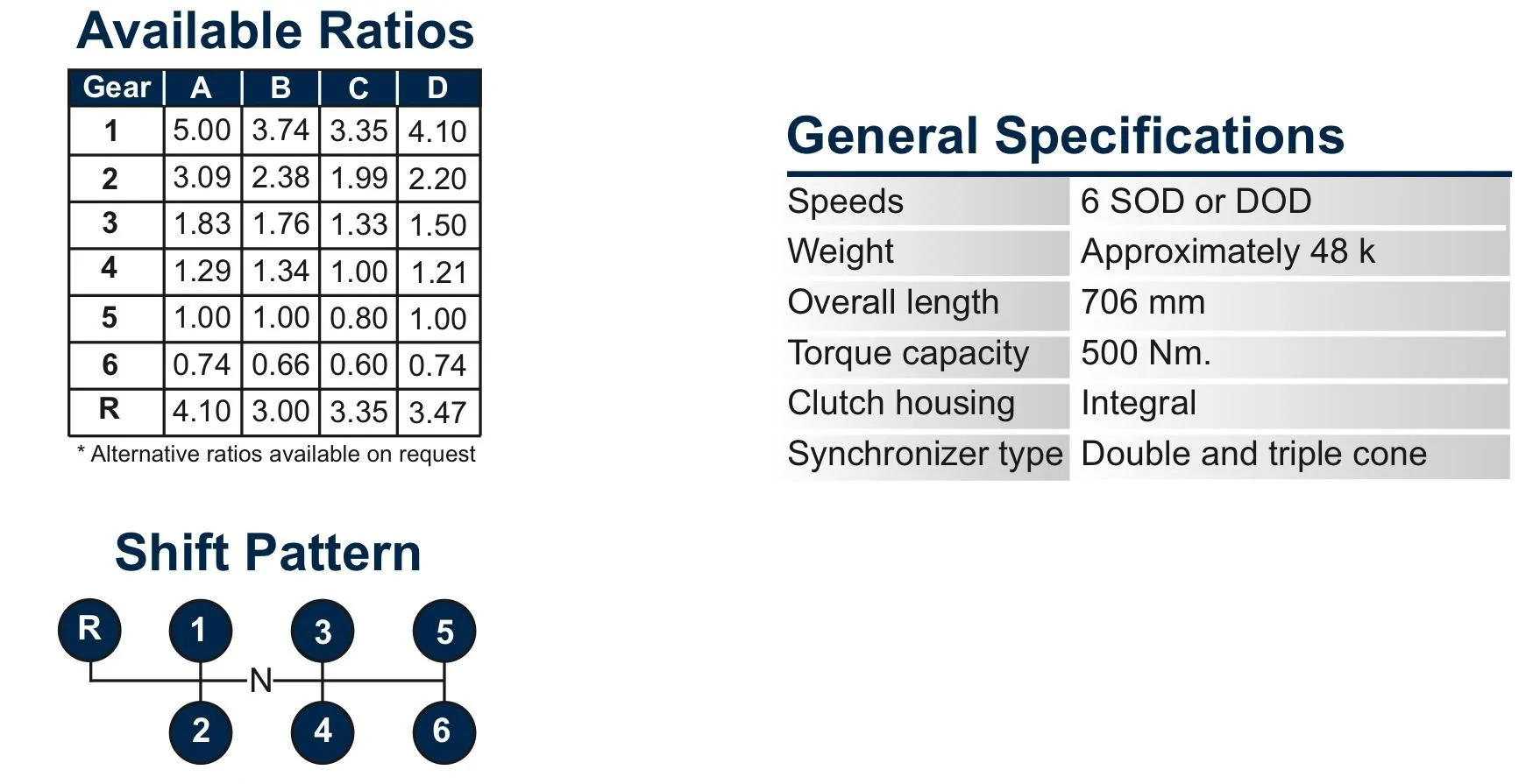

Will post the new SUV imolementation Gear Ratio list here for easy reference without having to follow link.
That addition of a 5.00:1 ratio 1st is a big change and wasn't there a few months ago.
Gives same crawl ratio as the ZF8 and close to same spread (6.75 vs 7.8 compared to the NSG's 5.3 and NAG's 4.3 spread). Which also addresses the fuel efficiency drawback of the small spread of the 6060 as seen in the Challenger.
http://www.tremec.com/anexos/File/TR-3160-010408.pdf
