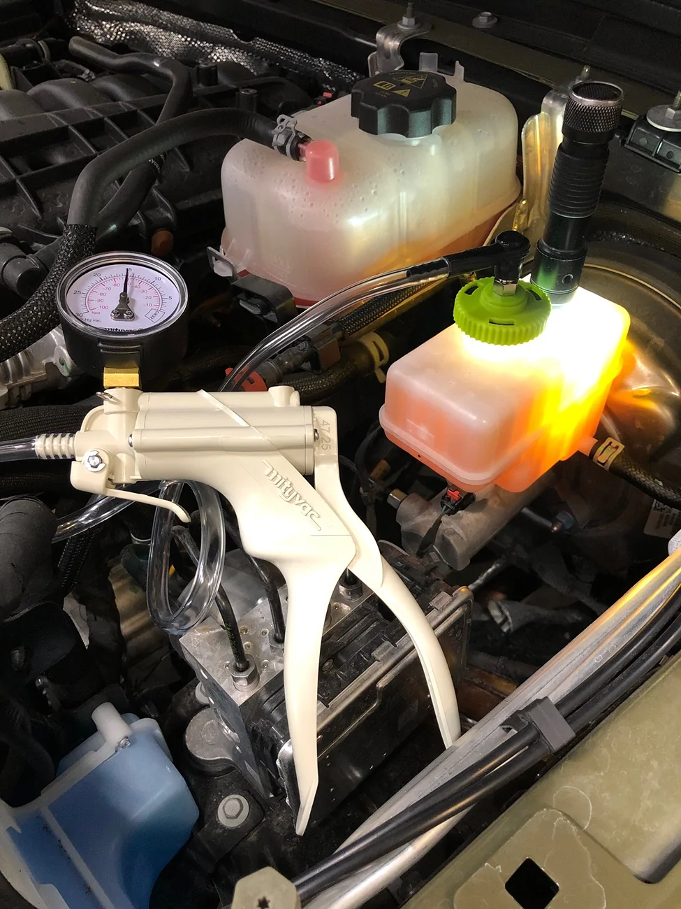

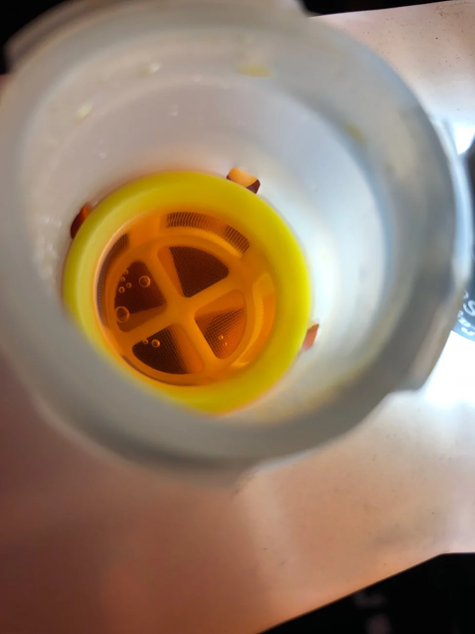

This was what I found after just an hour. But there’s not really any way of telling where exactly the bubbles came from. If air is getting in, you would think fluid would be getting out somewhere. Unless the vacuum somehow pulled air beyond a seal at the master or slave cylinder.
As a mechanic, there has to be a rational explanation for this. Nothing just stops working properly for no reason lol. That being said, has anyone else noticed the big curly-Q in the exhaust adjacent to the slave cylinder?
I think the quality of the cylinders are just crap. Air has to be sneaking in through the seals somewhere. Maybe not enough to let fluid out but even the tiniest bit of bubbles just screws up the entire system. It's not forgiving at all. No one has figured out yet why the transmission locks up. Previous Wrangler generations don't do that. If you push the stick a little harder it will eventually go into gear on a JK. With the JL no amount of force will get it to go into gear when the disc is dragging - it just locks you out of gear.
It may be worth bleeding it from the slave cylinder instead of pulling a vacuum. Eventually I'll pick up one of these one way brake bleeder hoses when I inevitably get lockout issues again.
So in a week or two 😜
