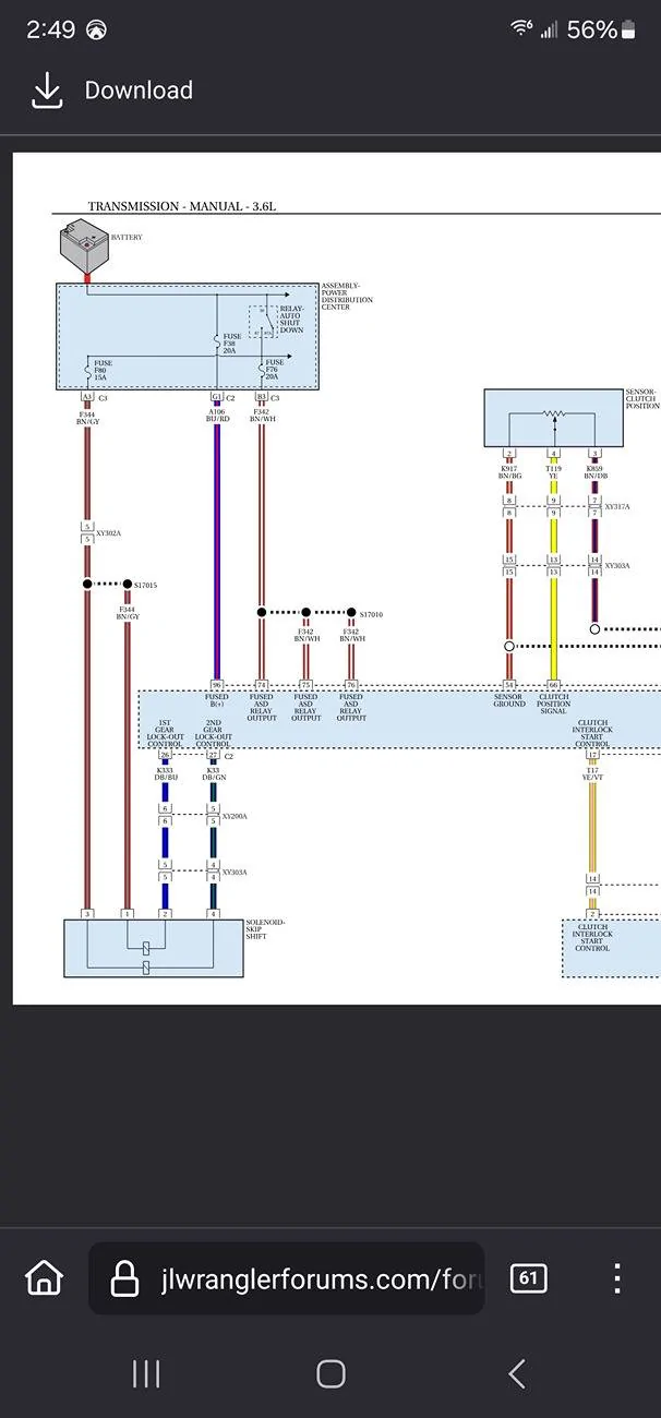

Its not a skip shift*in what I've read about the challenger* sense, its a downshift lockout apparently.
Which doesnt explain any of our Reverse issues, and its a Downshift only lockout. Shouldnt affect getting into 1st from a stop.
Looks like we could pull fuse 80 as a test though. I'm assuming because it's fused that it's a mechanical lockout, which means that a software glitch could cause it to engage. I don't know if it could engage once in gear but I don't see why not because it's probably a pin or gate block. That explain why turning the ignition on and off clears the lockout
I'm just glad I've been vindicated here I kept telling people there was a block that kept you from going into first gear and I was told I was crazy or it was just the synchros not keeping up or whatever turns out no there is actually a "feature" in the transmission that does it and now we even have the dang wiring pinouts that control it.
I knew I wasn't crazy.
I'm not saying it's the underlying cause every time or even in any one particular instance but any system can fail and not always in ways you expect.
Most of my issues are with Reverse, but, I just yanked fuse 80 just to rule it out. No immediate cluster warnings or CEL. I'll keep everyone posted.
