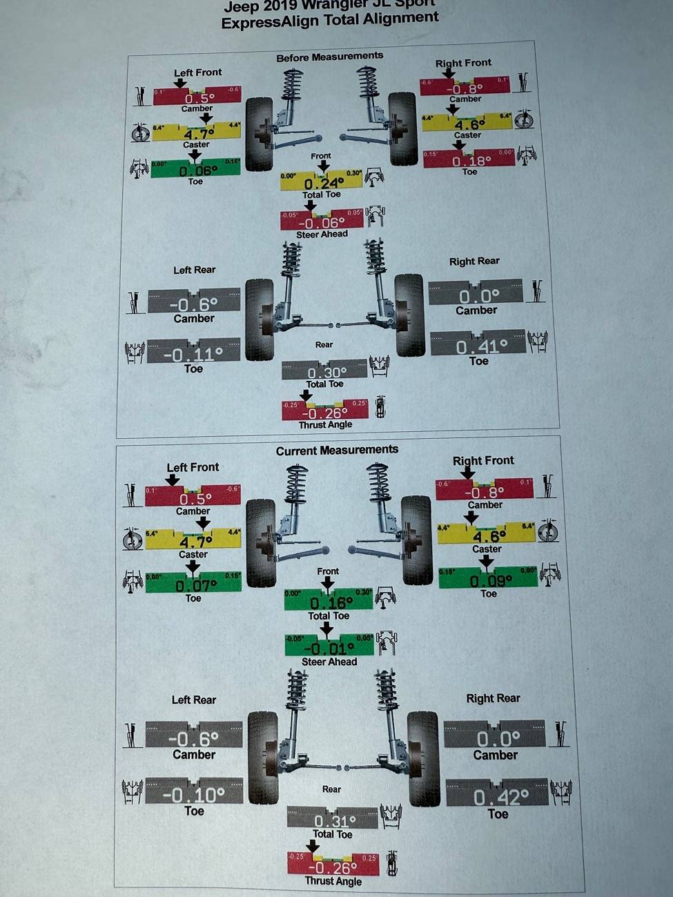

Hello all, bought a 2019 Wrangler with 24k on it a month ago. So far I replaced all 4 tires with Cooper ATPs, all new rotors and pads, new front track bar, and steering stabilizer. Had alignment done after tires, track bar, and stabilizer. No death wobble but jeez does this thing pull extremely hard to the right, faster I go harder the pull. The steering wheel is also offset to the left for me to drive straight. Any idea what this could be? No accidents or frame damage.
