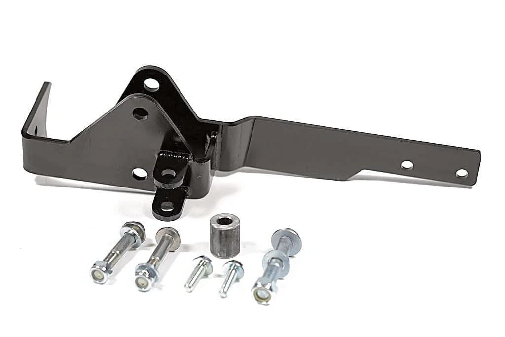

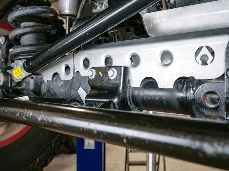

Yes, I'm aware of the bracket, and I'm going to get this one

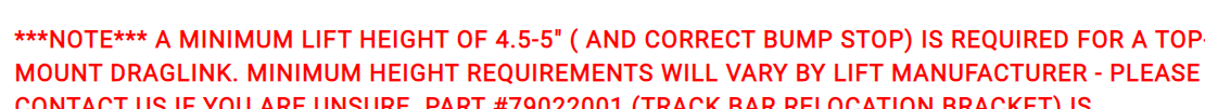

This is the most controversial moment, the manufacturer notice is:
But at the same time, I've seen a lot of feedback from JL owners with 3.5 lifts and they are delighted with the top mounted draglink.
Besides I don't drive off-road often.
Basically, I often drive on ordinary city roads, but with potholes and pits.
Sometimes I go to Europe and I want to ride comfortably at 80 mph on highway
Therefore, for me the main question is how much better it becomes if I flip draglink and add a bracket for the trackbar

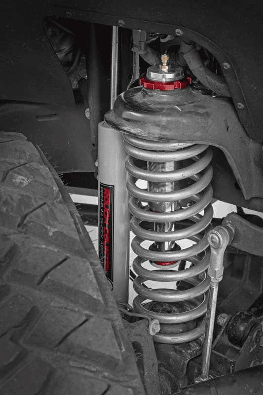

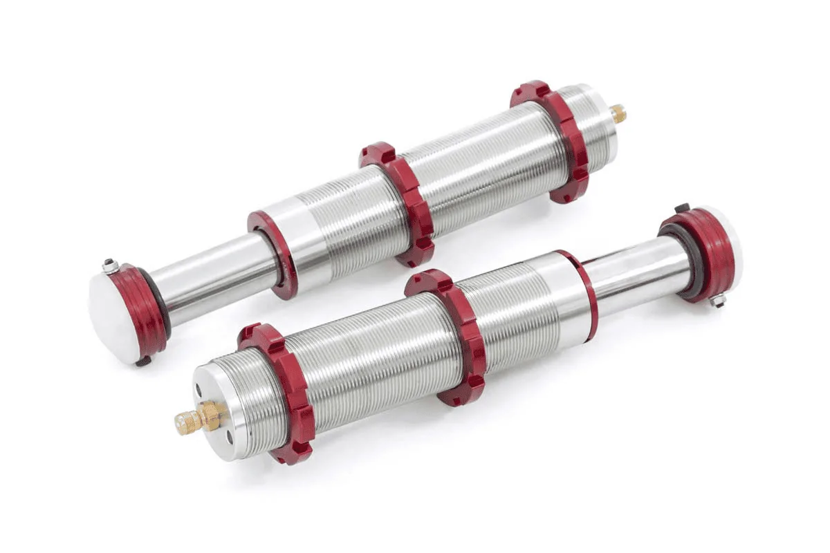

What if I install such bumpstops?
You still have to adjust thoughs to the corrct bump height for your shocks and components…in all honesty flipping the draglink on the jls is way more of a hassle than its worth, im still low mount at over 5ā€ of lift. I used to be high steer but i lost so much up travel for very little steering/drivability gain.

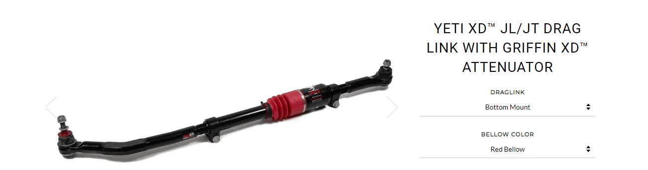

I want to purchase some Steer Smarts YETI XD:
  • TOP MOUNTED Draglink Assembly with Griffin Attenuator 78077002
  • Front Track Bar Relocation Bracket 79022001
  • Pro-Series Aluminum Tie Rod Assembly 78095001

You definitely don’t want to flip your drag link with a 3.5ā€ lift.

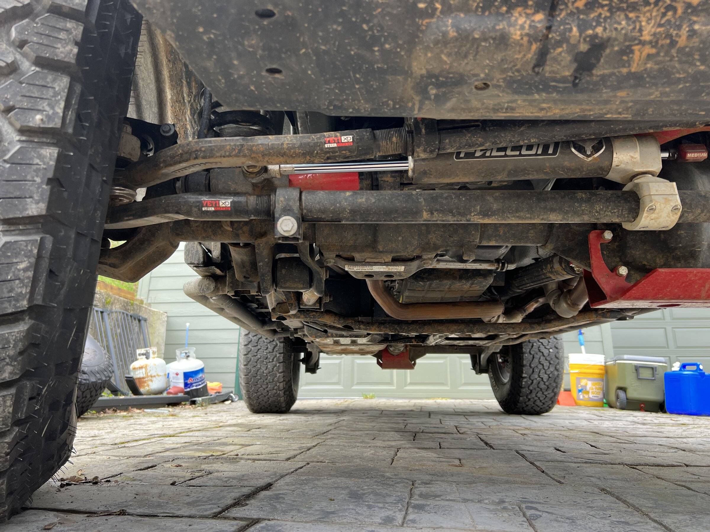

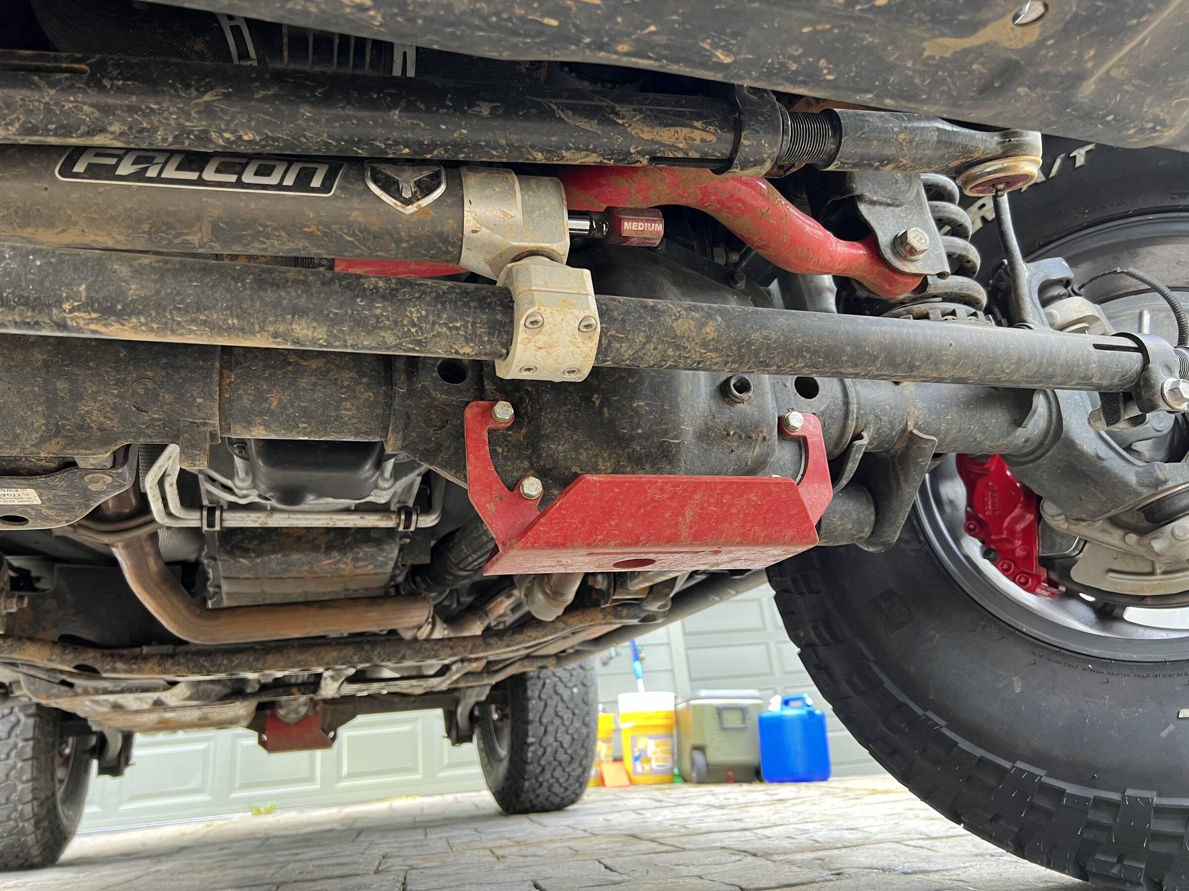

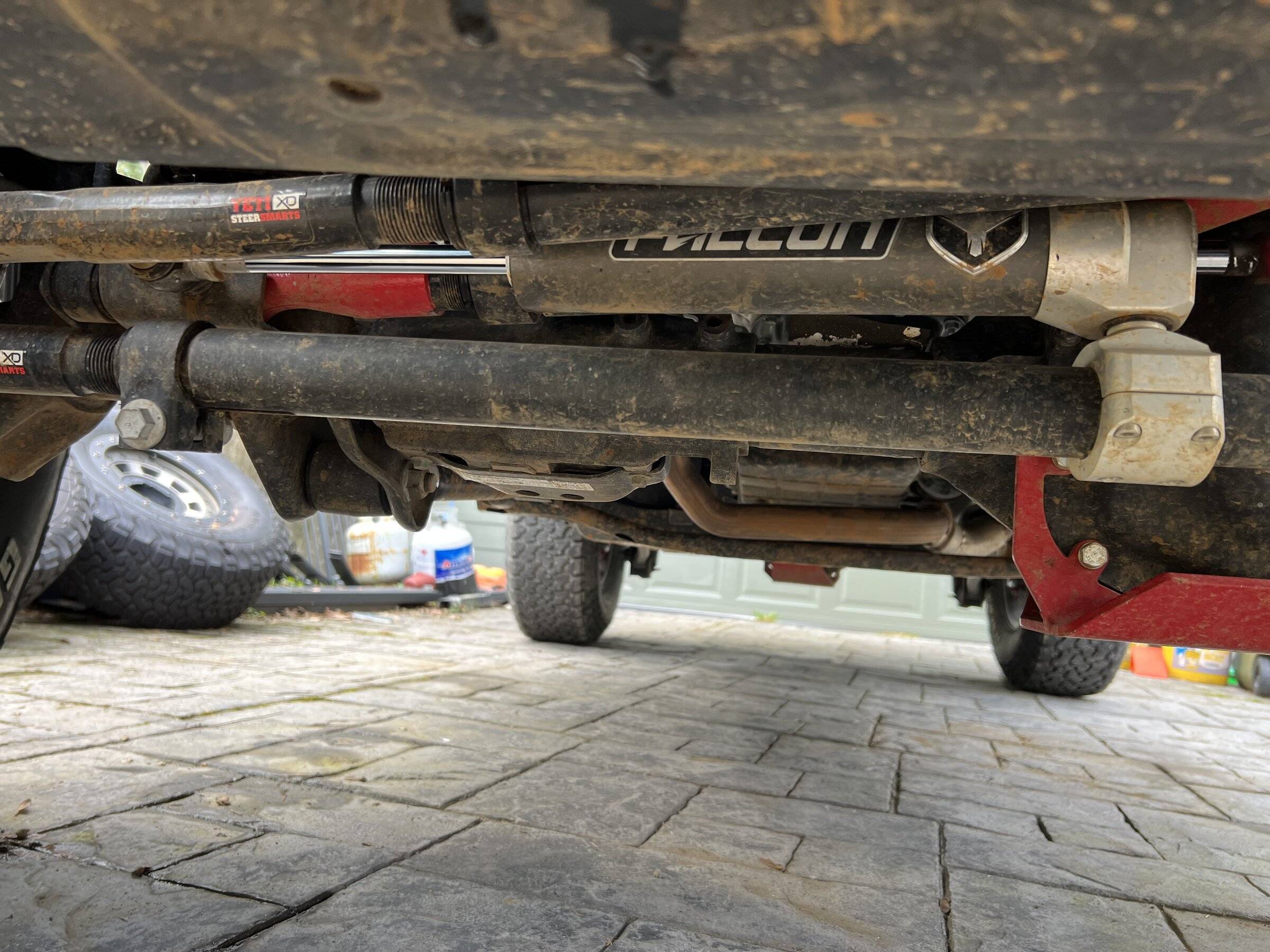

On the Yeti: I have the MOPAR 2ā€ lift, which seems to be more like a 2.5ā€ to 2.75ā€ lift, and the Yeti works slick. Itā€˜s pretty cozy, but the steering/suspension articulate just fine.
Jeep Wrangler JL Steer smarts drag link and lift size. 4A91B736-80C6-46DC-849D-EE5F611ED1A7
Jeep Wrangler JL Steer smarts drag link and lift size. 9603E850-2747-47AE-BB46-4055E0FCDCE8
Jeep Wrangler JL Steer smarts drag link and lift size. 13B4E0AC-AEB7-4E0E-A48B-CFF7EEC0A7E5
