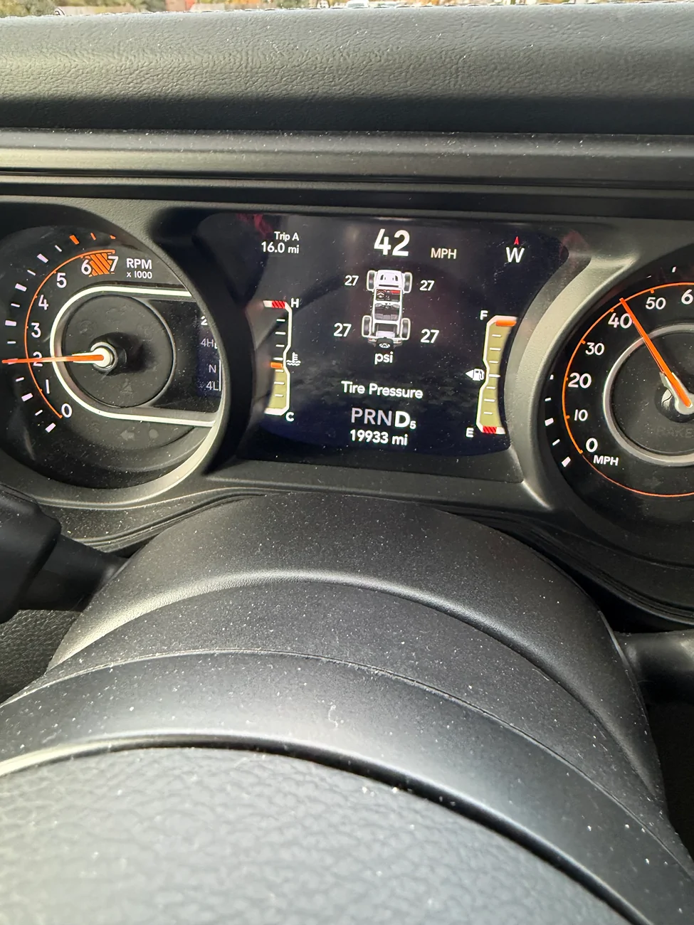

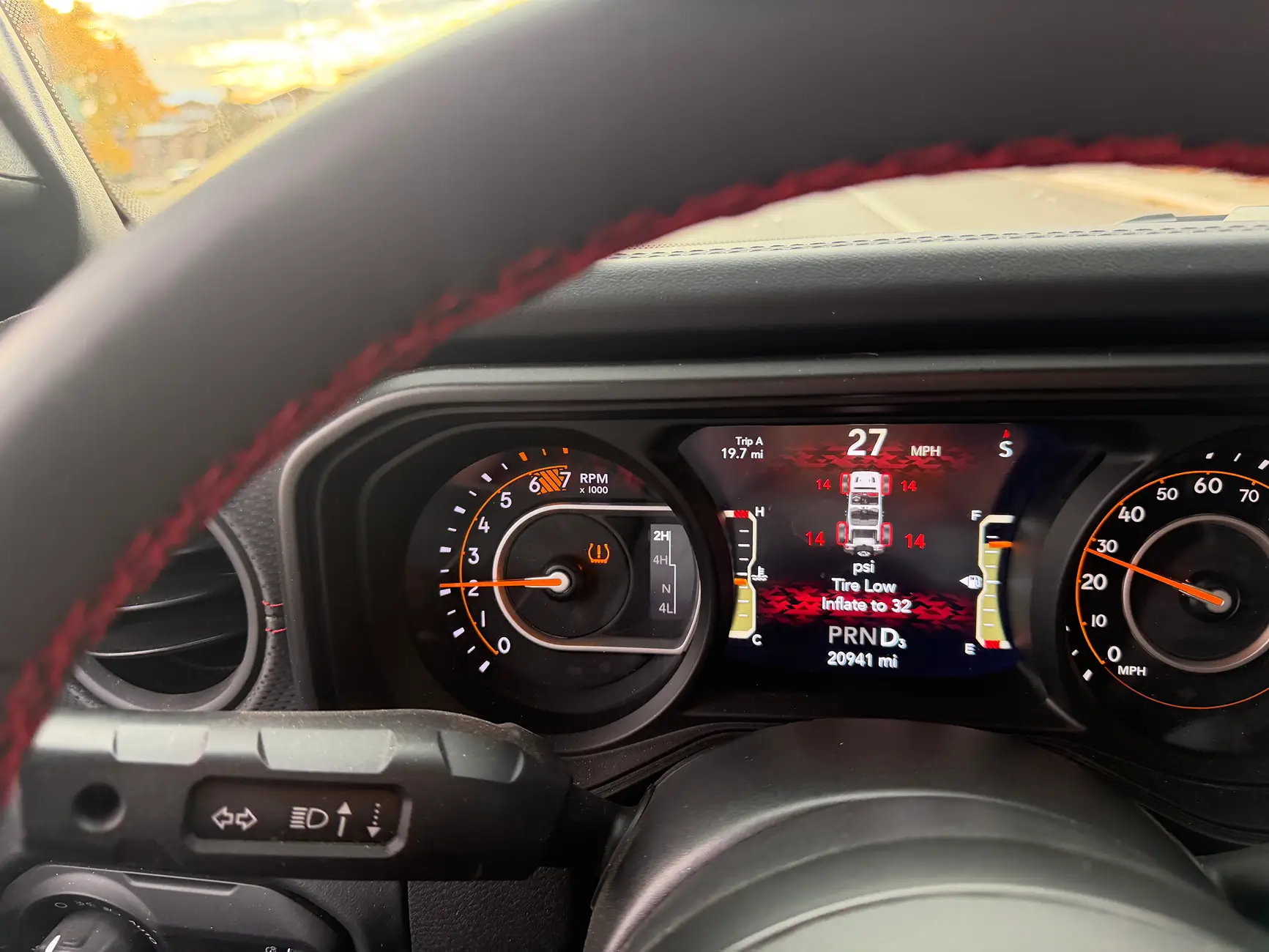

I run 255/85-17 E load 28-30psi and they ride great. on my JK's I also ran 255/80-17 Falken at3w and it was fine too. the 255/85-17 is a 35x10 and the the 255/80-17 a tall 33" tire.

Thanks much. That low psi works OK at highway speeds? I have 'E' on my GMC 2500HD which is of course much heavier. Have never tried airing down that much to do a ride quality comparison myself.
has for me for years. never had an issue...speed limits are 75-85mph in my area. my normal normal on road and offroad psi's
