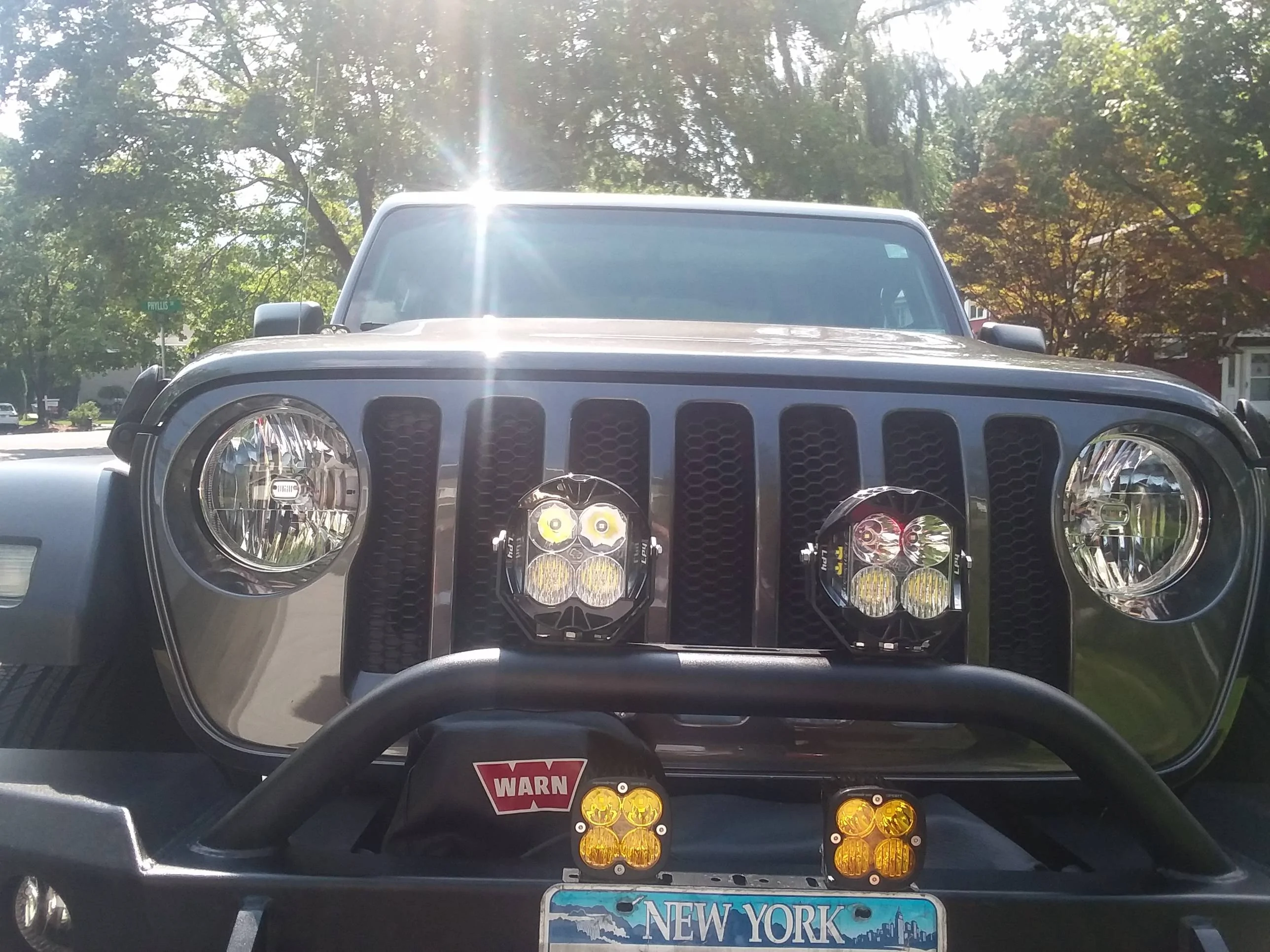

I've got a pair of LP4 Pros mounted directly above my fairlead, and haven't had any issues. I'd say that as long as the lights don't impede winch line use at varying working angles, you should be good to go.

I drilled holes in the top of the mopar steel bumper, so the lights could sit evenly spaced and centered under the bull bar. Maximus-3 does make a light mounting bracket for this bumper, which utilizes the middle 3 factory bolt locations. I just didn't have enough room under this specific bar for the extra +/- .75" of height that a bracket would take up.
I agree with lashlee above. They do look great when mounted further out and under the headlamps. Here's a pic of Litebrites Step Child, back when they had the Crusher bumper and LP6's...

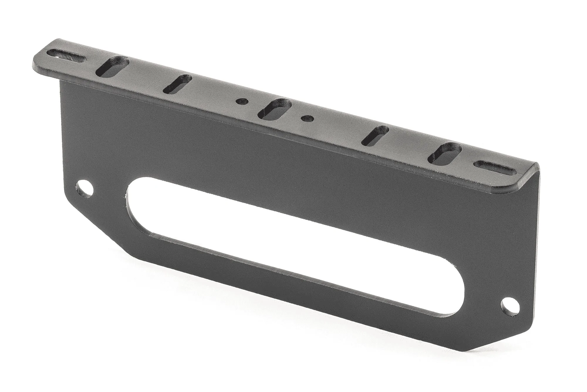

What fairlead mount did you use or did you just drill mount holes?

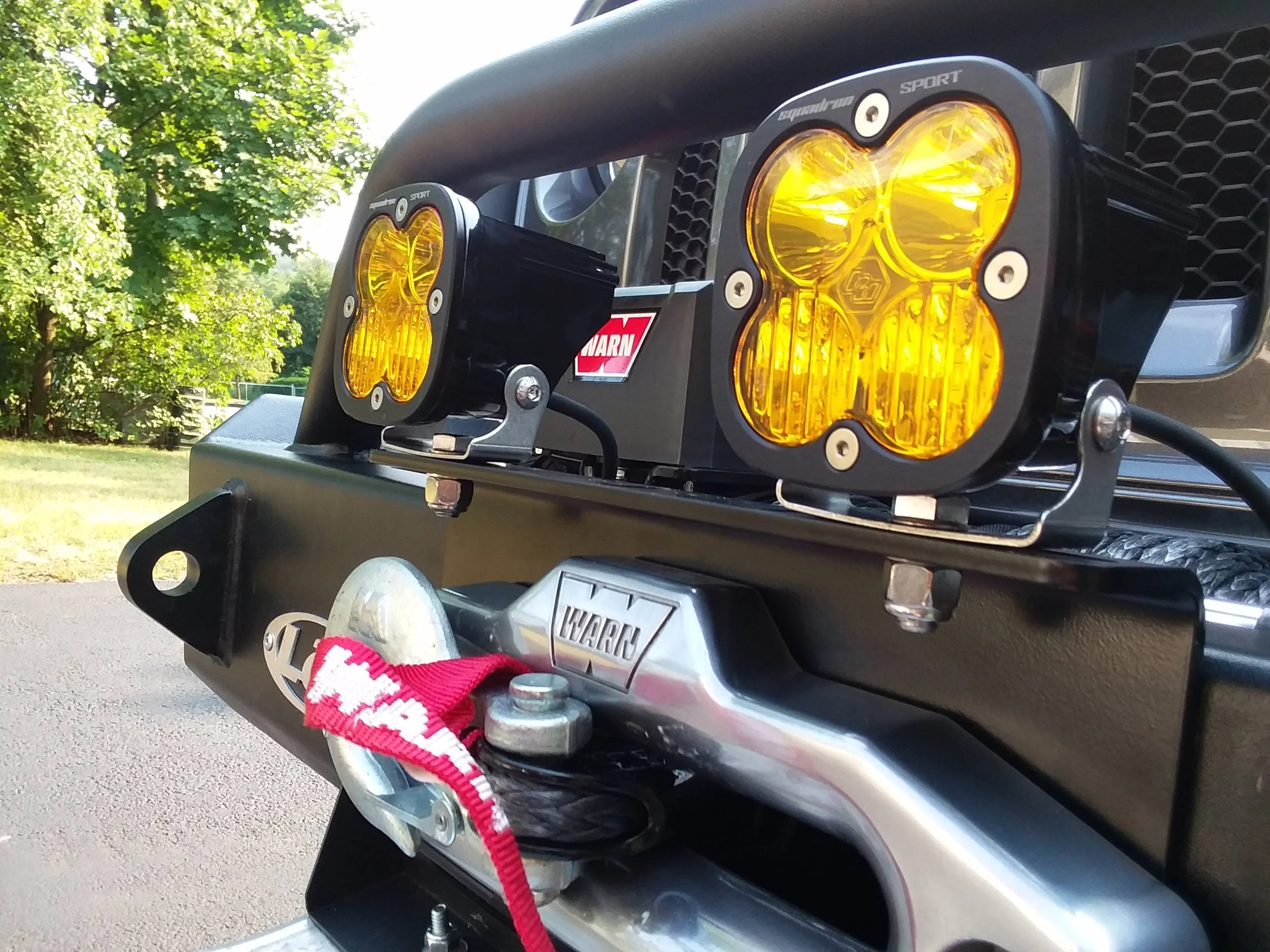

i use the vison x fairlead light bracket. this will fit behind the fairlead with the capability to mount aux lights above the fairlead. here's the link. if you go back one page on that like, there's more options to choose from.
Jeep Wrangler JL Lp4/6 fairlead mount? 1666828829141
here is my setup. my lp4 is actually on the bull bar (plus a pillar). i have the squadron sport ambers mounted on the mount.
