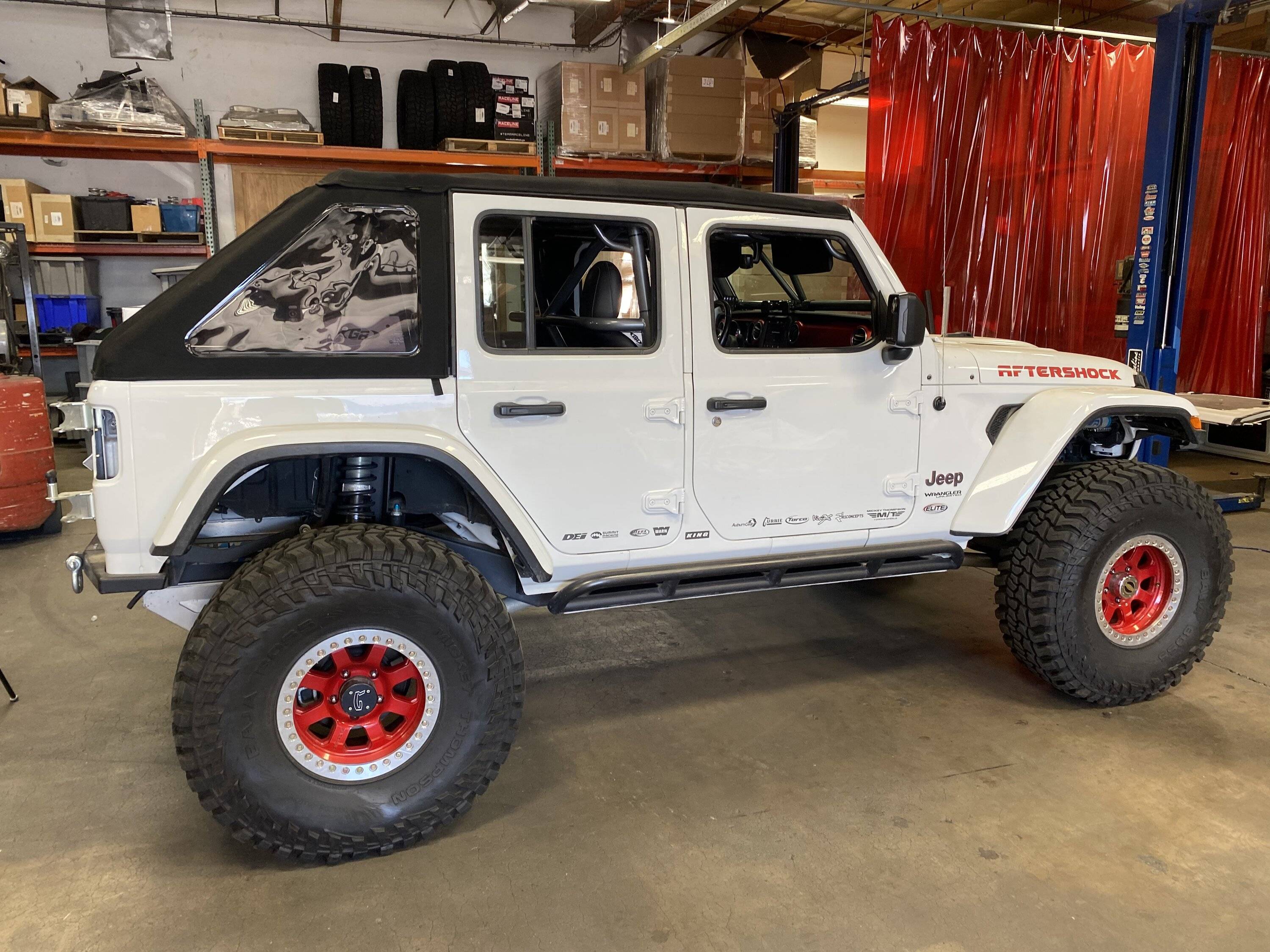

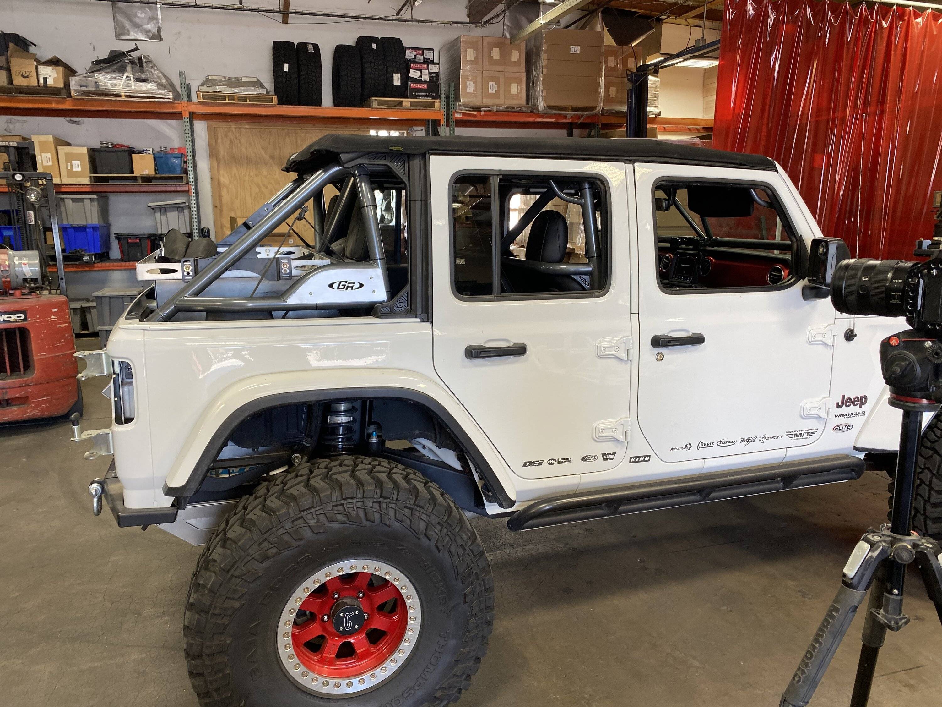

What I'm really looking for is for someone to work with to understand how the top gets mounted. I'll make my own brackets for the cage to top integration. I just need a complete understanding of what is required for the top to attach and have it operate properly. I'd like to have this discussion before purchasing a top.

@chevymitchell I just got off the phone with my Quality Team. I was not able to get anyone to help you with understanding how the top mounts unfortunately simply because our tops are designed to go on the Jeep as it is stock, when aftermarket products, like your cage, replace the stock roll bars, that's when modifications are needed and we cannot assist in modifying our tops to go on something they're not designed to. I wish we could help, I guess its a liability thing.
I was however able to get you somethings to think about before installing the top, I hope this helps.
Here are the things we discussed:
  • There are no holes in the cage where the factory holes would be on the stock roll bar, to allow the frame/hardware of a soft top to mount to, you would need to get the stock specs of where these holes need to go, in order for the Trektop hardware to mount where its suppose to
  • The crossbows that come with the top, might not sit correctly over the cage, causing the fitment and function of the top to be skewed
  • The windshield position, if the cage causes the windshield to sit further forward than stock, it may not allow the top to attach correctly

Each side uses support brackets "door surrounds" which on the factory "cage" attach using four bolts through the cage to a threaded insert on the door surround (effectively clamping the door surrounds to the cage). Then the door surrounds have threaded inserts to attach the 3 cross bars. Standard soft top stuff beyond that. There is a leg on the rear surround that extends from the cage height to the top of the tub immediately behind the passenger door.
I think what you'll need to devise is a way to use a clamping-esque component to accommodate for the change in location between the genright cage and the factory cage.

I’ll just get a top and make it work.
Thanks for the input man.
GenRight is already working on a kit for this top, but it won’t be done before I’m ready for it.
