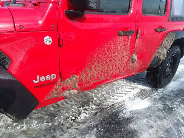

I noticed almost no difference in steering after putting winter footwear on my JLU. Following the conventional wisdom, they are inflated 5 psi higher than the Michelins that I use in fair weather.
My average fuel mileage has gone down by 3 mpg or so, but the snow tire/steel wheel combo is a bit heavier (and has a softer rubber compound) than the factory wheels/tires. So, that's hardly surprising.
They were field-tested today in icy slush and hardpack, and performed superlatively.
