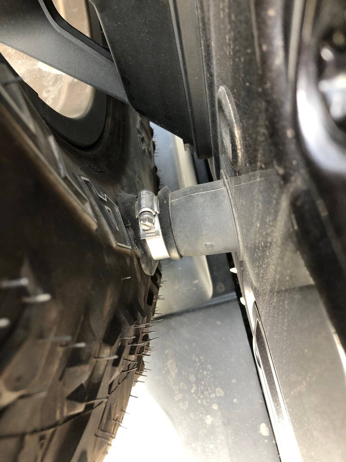

I wouldn't even go as far as that... I just went to home depot and got the small diameter PVC pipe connector that would fit in the hole of the bumper and then got some wider rubber pipe fittings secured them around the other end. haha not the cleanest, but no one ever looks behind your spare so. Around $5 of total parts or so.
I love it. I am just massively out of money right now, and that looks like a fine piece of redneck engineering.
