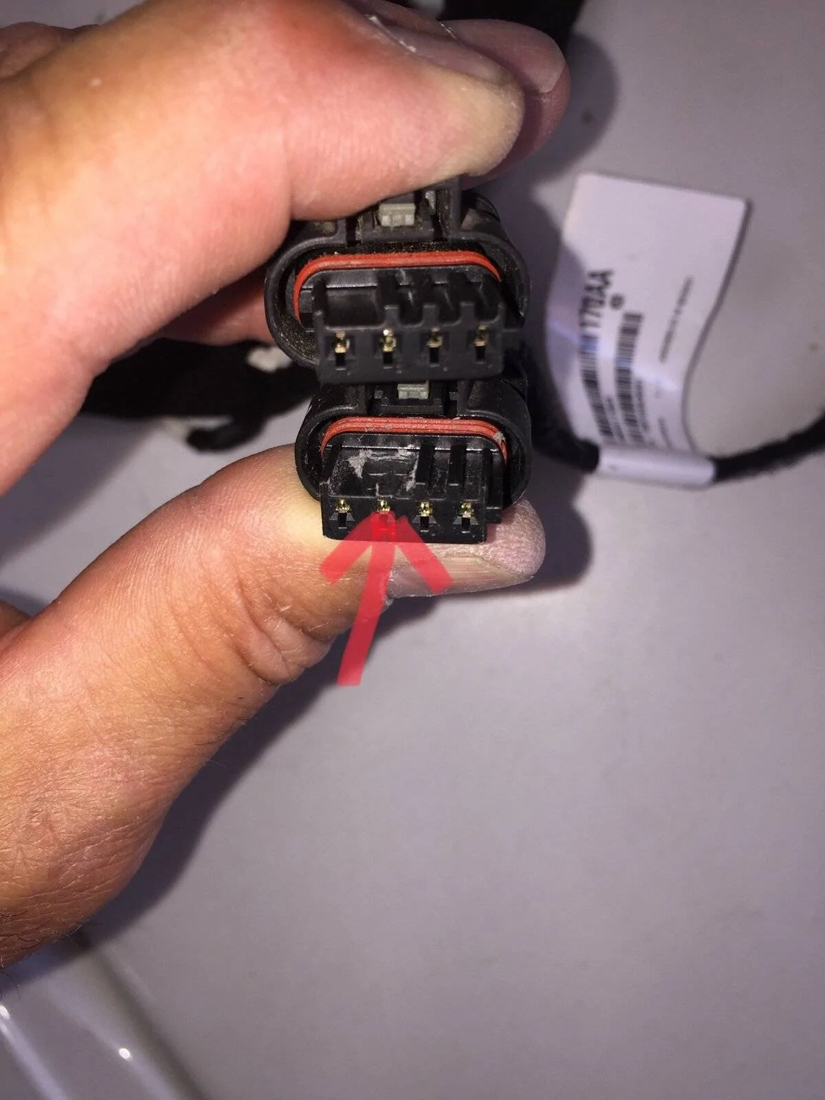

For those who are putting Rubicon Axles in their non-Rubicon and are shocked by the price of the locker wire harness (I may be a cheap bastard but $90 seems like a lot of money for one connector and a couple wires). I looked all over the interweb for the connector but couldn’t find it. I thought it had to be used in other applications and knew I had seen it before.
Turns out that family of connector is used in the doors for the latch and I have the old harness from the Proximity install. The locker connectors are 805-122-582 and the connector in the door harness is 805-122-581, it’s the same connector that is keyed slightly different. I just had to use the dremel to remove one ridge in the connector.
Other than that, just lengthen the wires and done.
