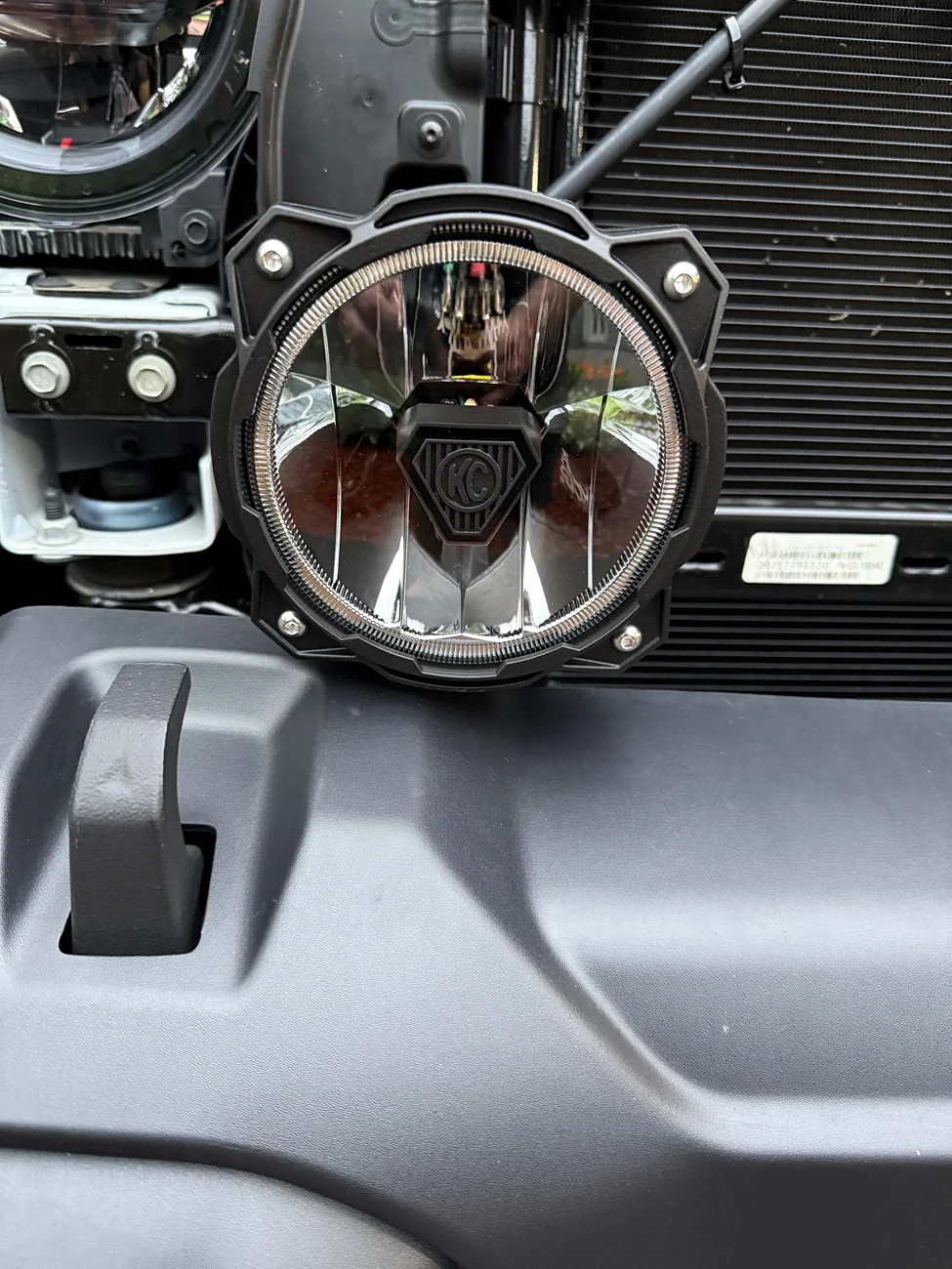

not cheap but these KC slimlites really light up the road..they were so bright I actually put the DOT diffuser lenses on them..they light up the sides as in front very well. mounted on a cheap Rocktrix winch guard.
Jeep Wrangler JL Lights for back roads /deer tempImageozi59o
Jeep Wrangler JL Lights for back roads /deer tempImageFJ8pud

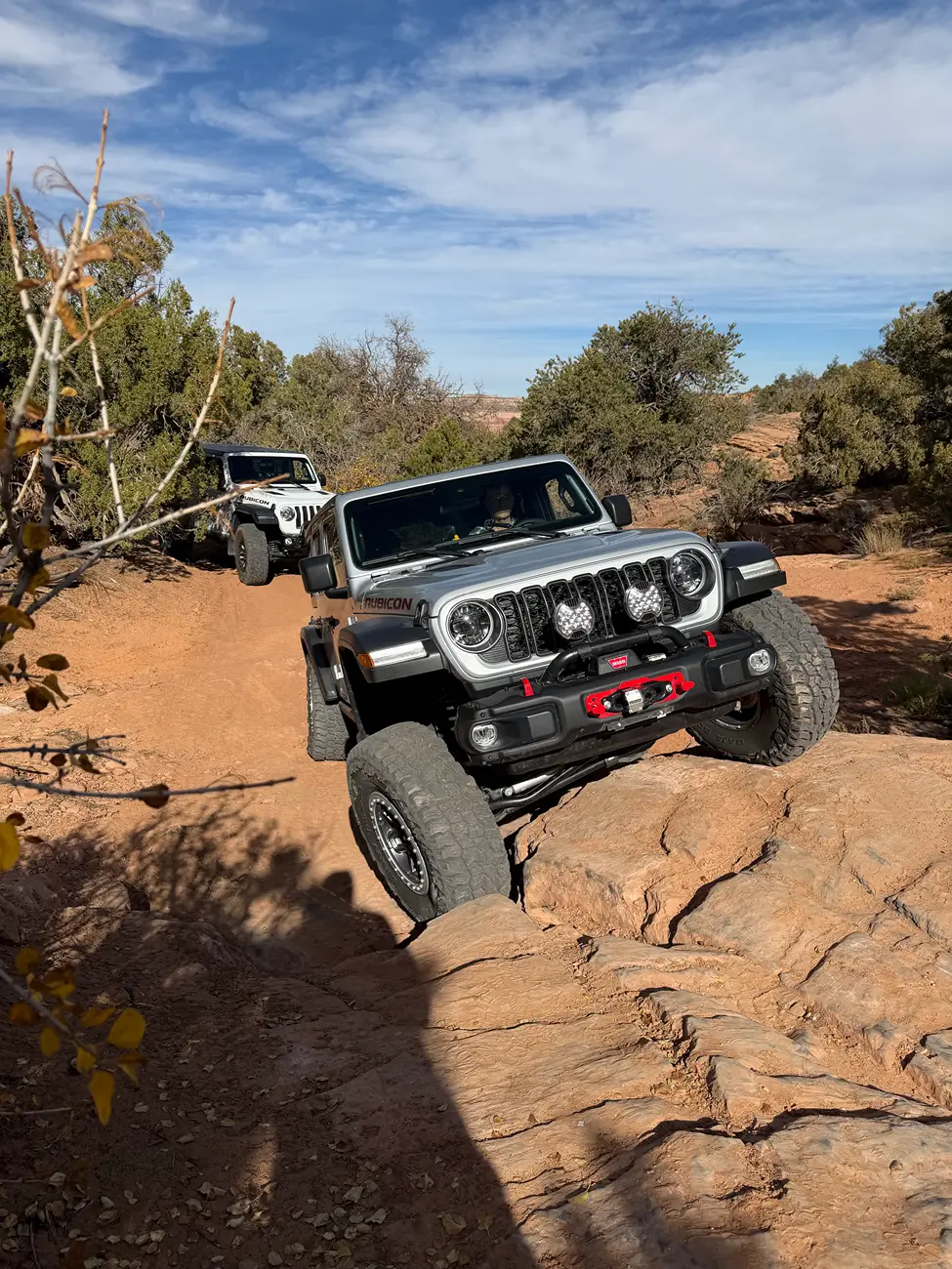

Last year I finished the Rubicon Trail at about 3 PM, aired up the tires, gassed up, and then drove straight through to home in southern Utah. Coming across the Loneliest Highway in America in the middle of the night was made much easier with the aftermarket lights I had on my Jeep. I have 4 of the amber Baja Designs S1 lights behind the front skid plate that do a good job of lighting up the periphery of the road and close to the Jeep. Then I have 2 Baja Designs LP6 lights on the bumper that have good side lighting while also taking care of distance lighting needs. Then I have 2 Baja Designs LP4 lights on the cowling that are angled to better light up the shoulders of the road. It almost felt like driving in daylight while driving across miles and miles of deserted highway at 2 AM.
Mine is the tiny one on 40s
Jeep Wrangler JL Lights for back roads /deer Moab EJS 2025

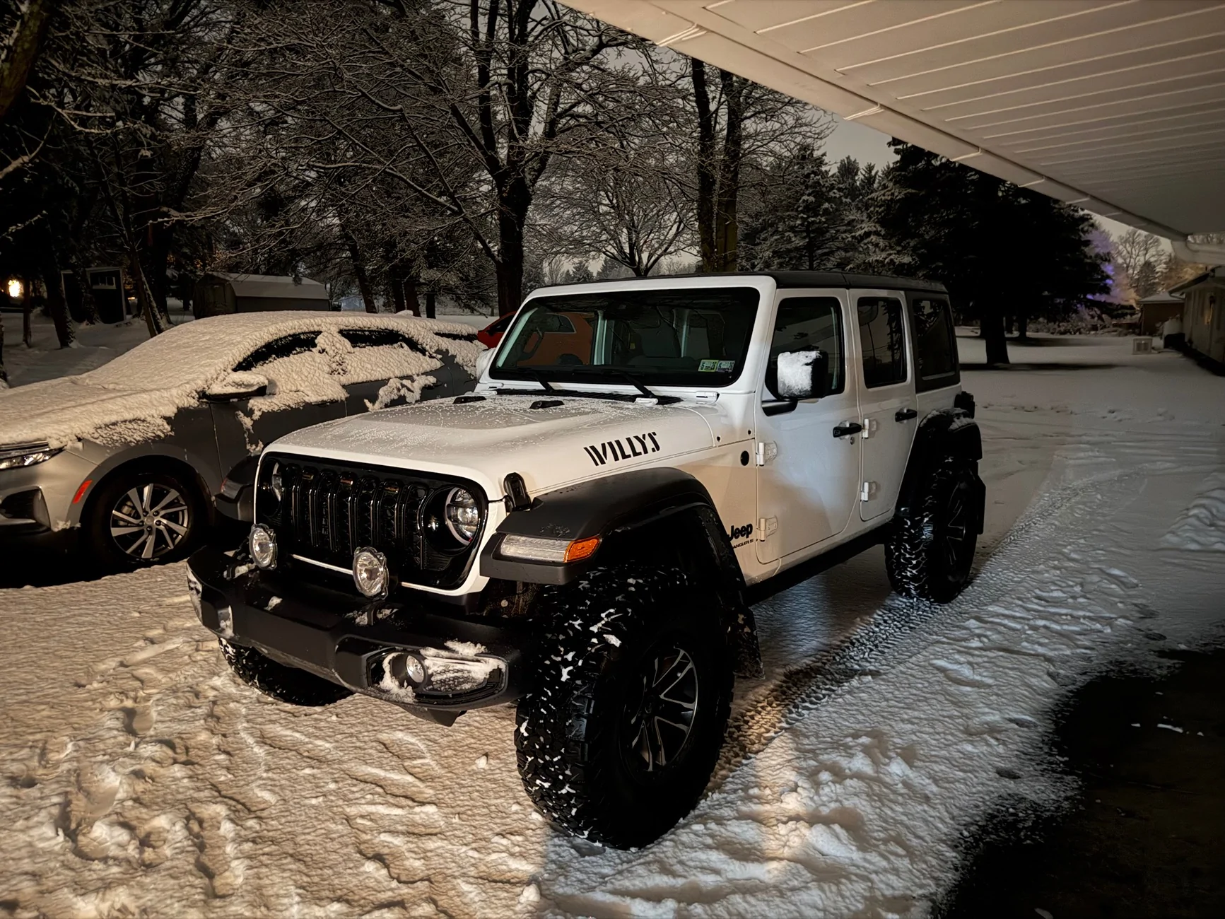

I had a pair of BD Squadron Sports with the amber combo lens on my JKU bumper. They worked well on country roads and were brighter than the Hella halogen headlights I was running. I have the same lights now in the bumper of my JLU instead of the oem fogs. They aren't as bright as the oem led headlights. They work well, but I will be adding another pair of Squadron Sports with the amber spot lens to try to match the performance of the current headlights.
