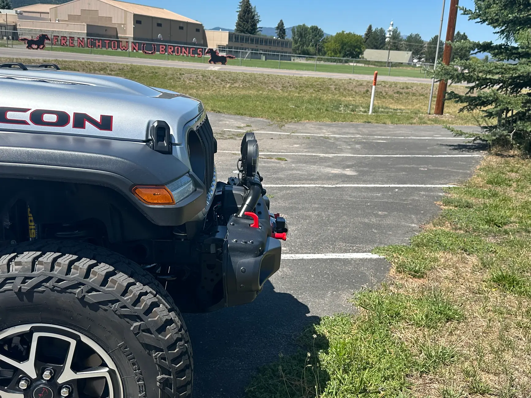

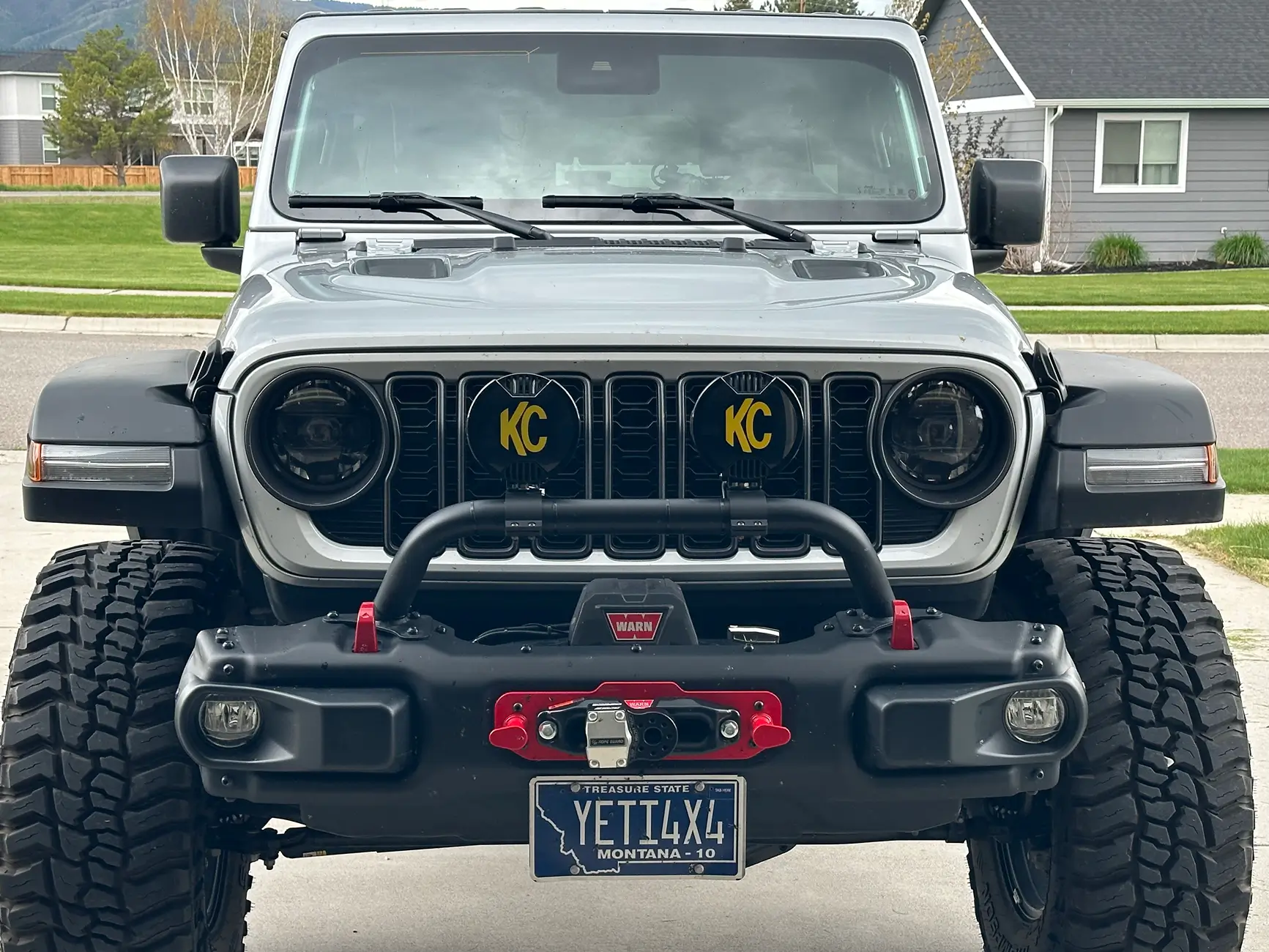

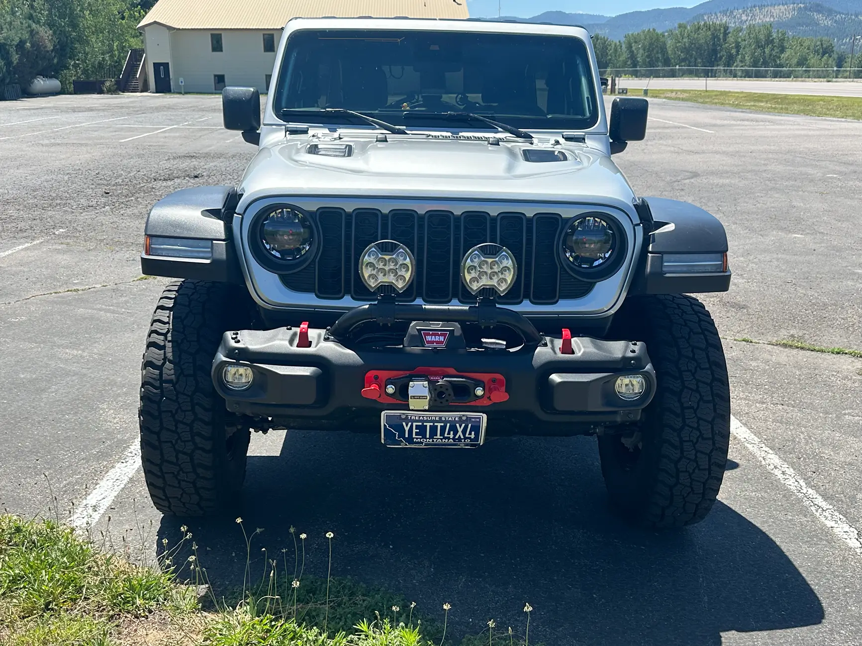

I just purchased a set of KC gravity lights which are a bit large and I am in the process of trying to decide where to mount them on a Rubicon with a steel bumper with winch in place. The mopar mount will not work with a winch and I found an option on Etsy that places the light away from the winch but it partially blocks the headlight beam. Placement options are limited so I’m probably going to enlarge the existing holes on the bumper closer to center. Will also be running them off the accessories port on the zeon winch which is plug and play and can be controlled remotely with no wiring harness
truck trix $79 hoop...might be worth a try if you have mopar mounts...

Those look like a good solution. Just a bit concerned about blocking the radiator however
I have been to Moab 2X (june last year and June this year) in 100° heat traveling ~800 miles one way at 80mph without issues either time...my coolant temps never change. lot of mountain passes in Montana and never had an issue..

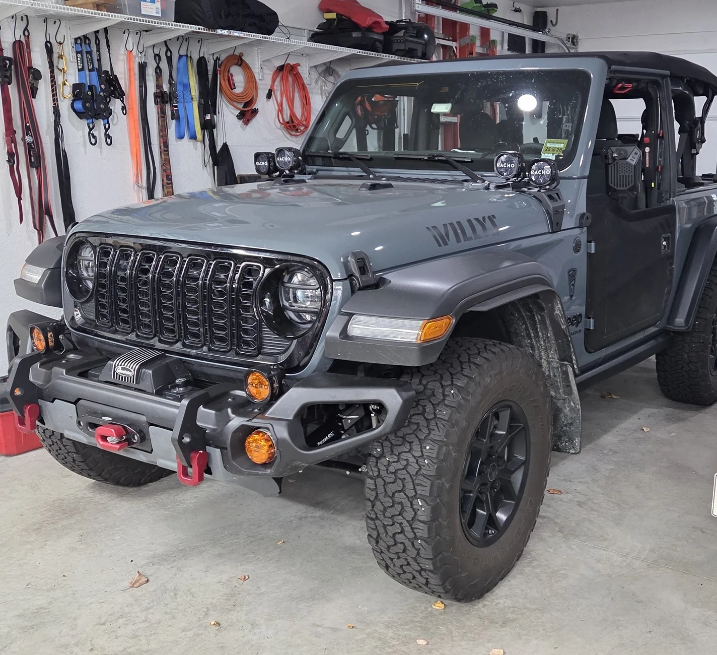

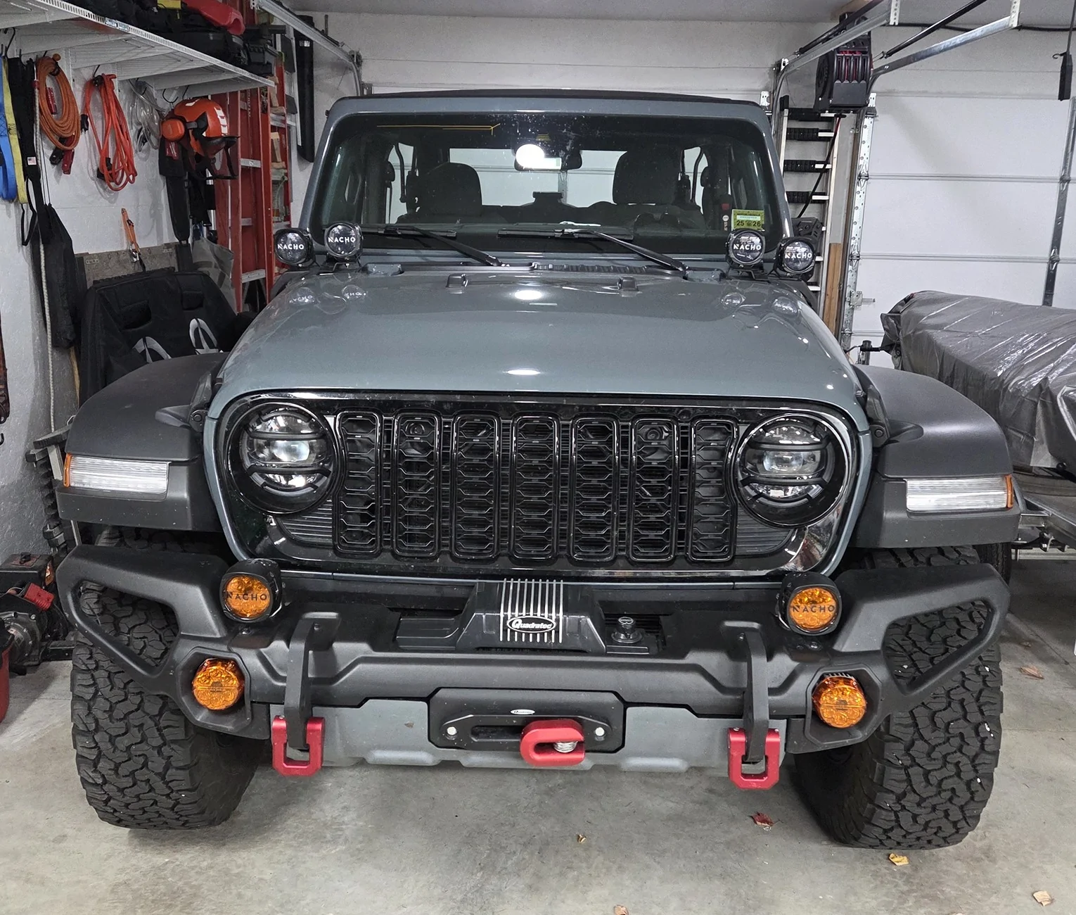

Nacho Quatro 4" lights. White ones up on the A Pillar, using DV8 brackets. Amber down low on the Rugged Ridge Venator bumper, two on top, using two bumper bolts and two in the factory fog light positions.
