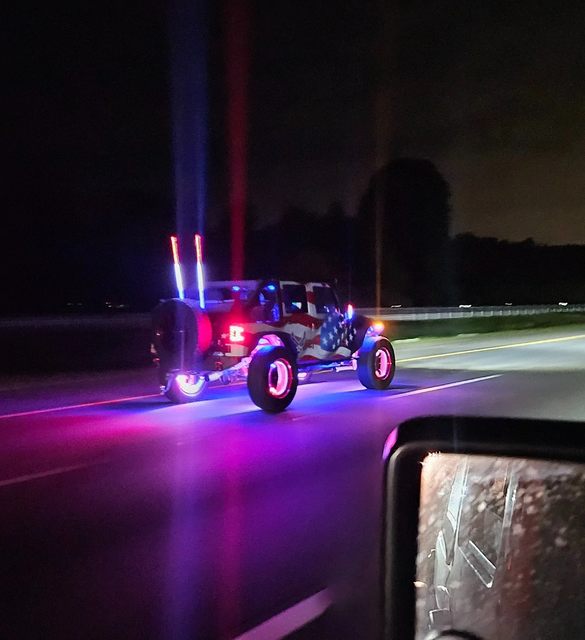

Our JKUR with an MLC-6 has more lights than switches. Most of them (with the exception of the 52" lightbar) are running 2 or 3 different lights per switch. I plan on upgrading to a wireless 12-switch setup and some point, but it's been working as-is for years.
