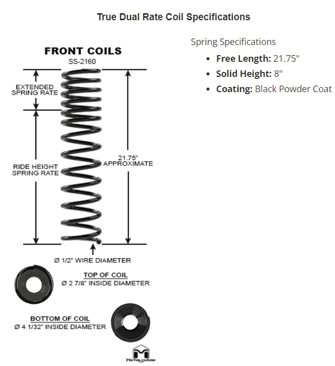

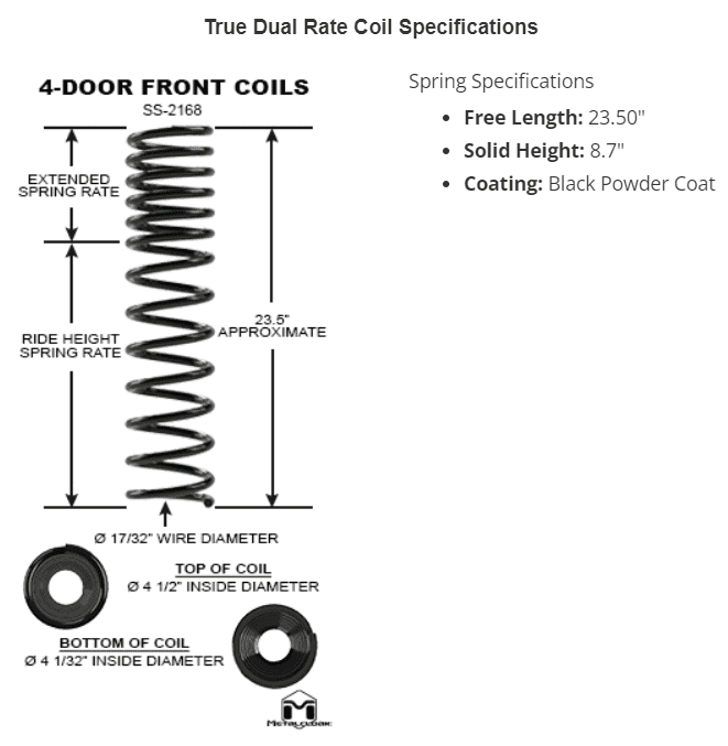

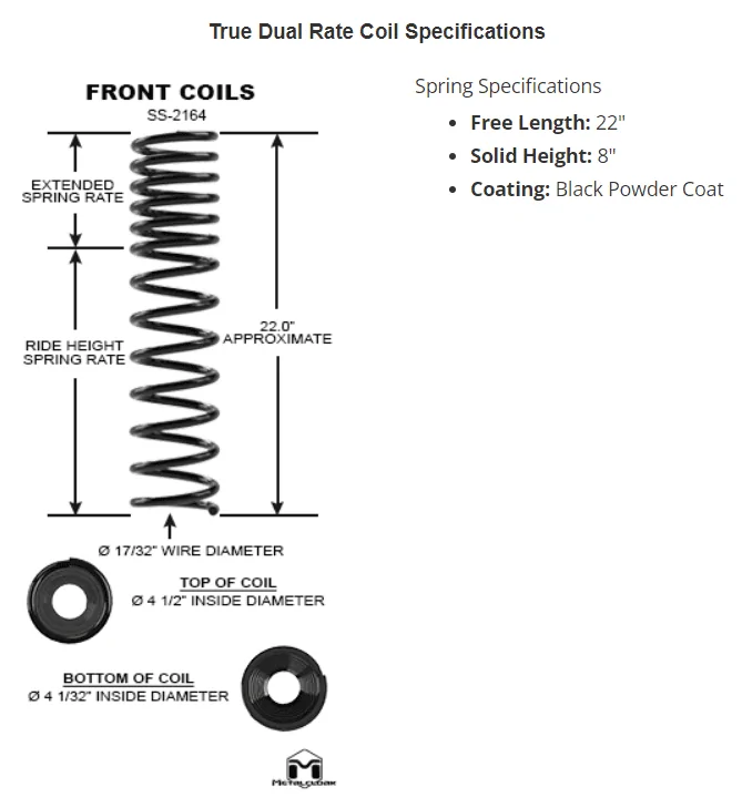

I would like to know the difference between the springs. When it comes to the your lift offerings, (2.5”, 3.5”, 4.5”). Are the springs simply an inch longer each with the same spring rates? Are the springs actually the same length but with increasing spring rates? Is there a change in rate across the dual band for each increased spring offering?
To throw a little more info in. If you look at the separate spring product pages on the MC site, about halfway down on the left, they give you some dimensional info:
4 door fronts:
2.5": https://metalcloak.com/jl-wrangler-jt-gladiator-true-dual-rate-coils-4-door-2-5-front-pair.html
Jeep Wrangler JL Lift height, spring question. 1674488080529
3.5": https://metalcloak.com/jl-wrangler-centered-true-dual-rate-coils-4-door-3-5-front-pair.html
Jeep Wrangler JL Lift height, spring question. 1674488119028
4.5": https://metalcloak.com/jl-wrangler-jt-gladiator-true-dual-rate-coils-4-door-4-5-front-pair.html
Jeep Wrangler JL Lift height, spring question. 1674488155853
