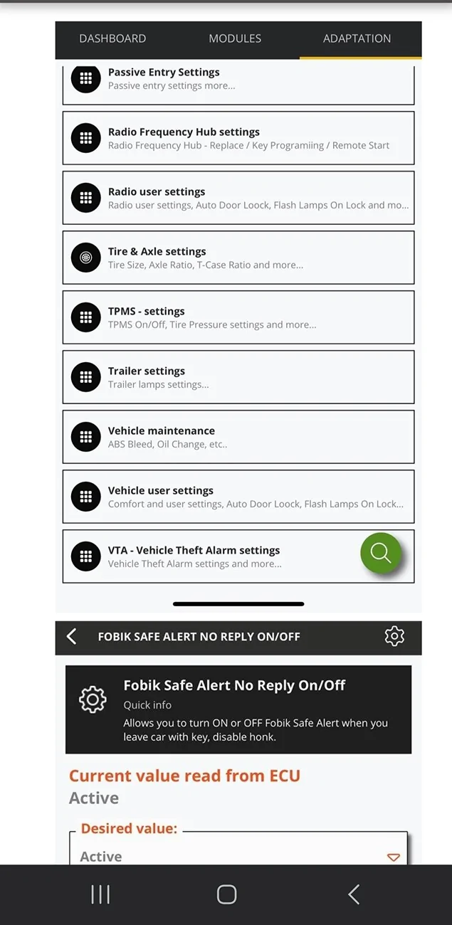

I use Jscan, I wasn't able to disable the 3 horn beeps either. I bought a $20 seat belt extender to avoid the 3 horn beeps. Tire size, tpms, everything else was very easy.
Jeep Wrangler JL Let's talk JScan and 4XE Screenshot_20250730_043945_DuckDuckGo
