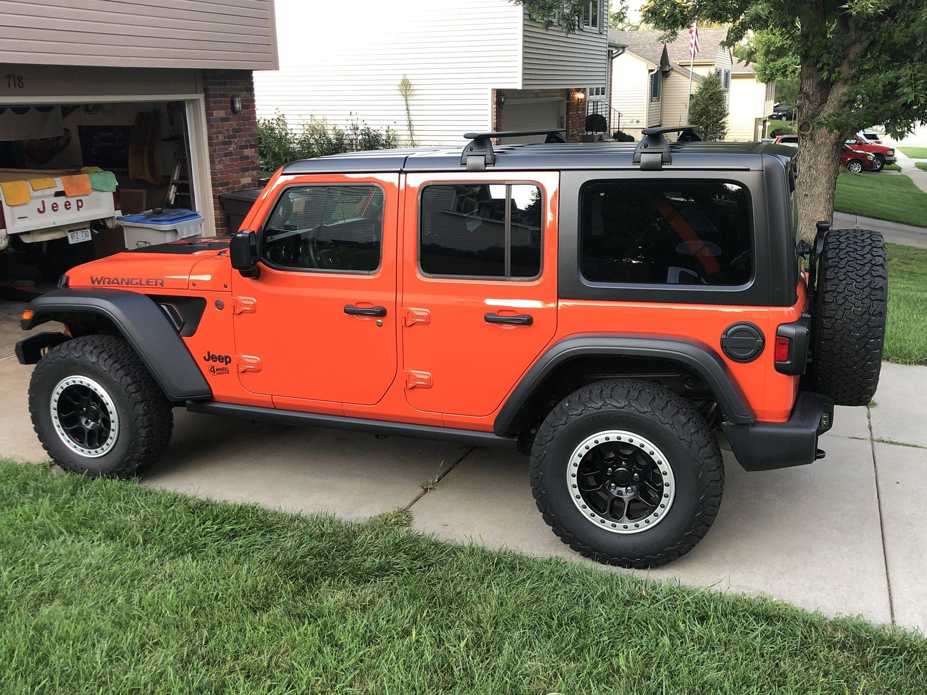

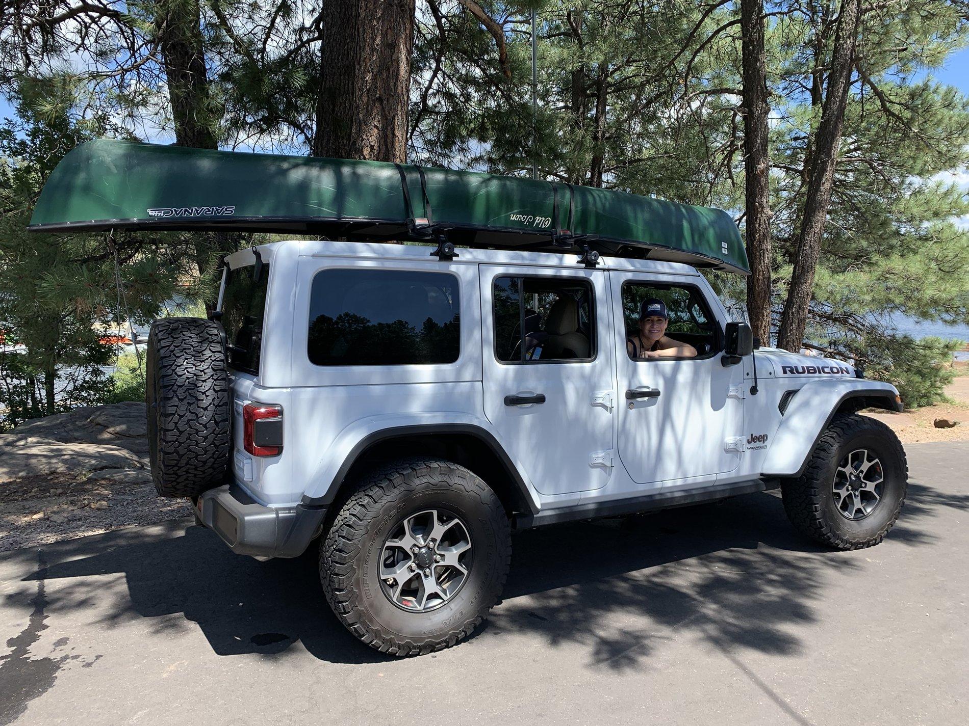

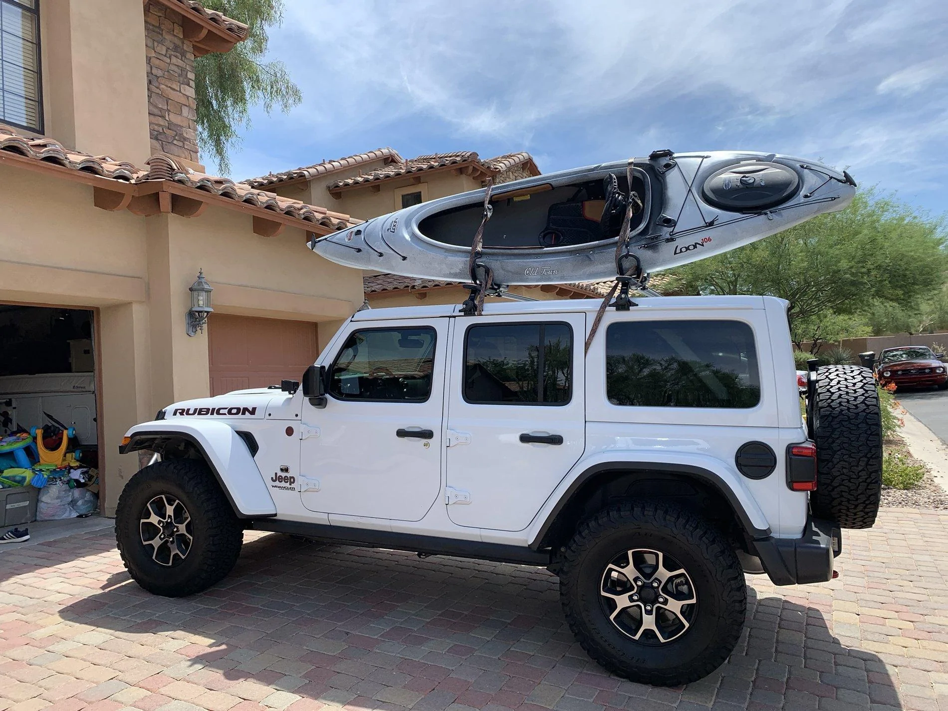

Do you have any reservations putting the front part of the rack on the freedom panels?
It probably isn't the best in terms of strength but I wanted to keep my canoes and kayaks relatively balanced over the bars.
Only negative thing I can think of is the fixed width of the bars. The bars won't allow you to mount two canoes side by side and although you can mount two kayaks using a J-frame, it won't be easy. At least for a person who's relatively short.

I see some folks are mounting these racks to the freedom panels. For safety reasons, you might want to avoid this since the freedom panels are the weak links to this setup. Aerodynamic lifting forces can be quite high and the freedom panels are not designed to support these load levels.
I don't dispute that but I was just following the instructions provided by Rhino rack.
Moving the bars rearwards would be fine for something short like a tent or a recreational kayak. But I'm guessing that it wouldn't be feasible for an 18' 75lb sea kayak.

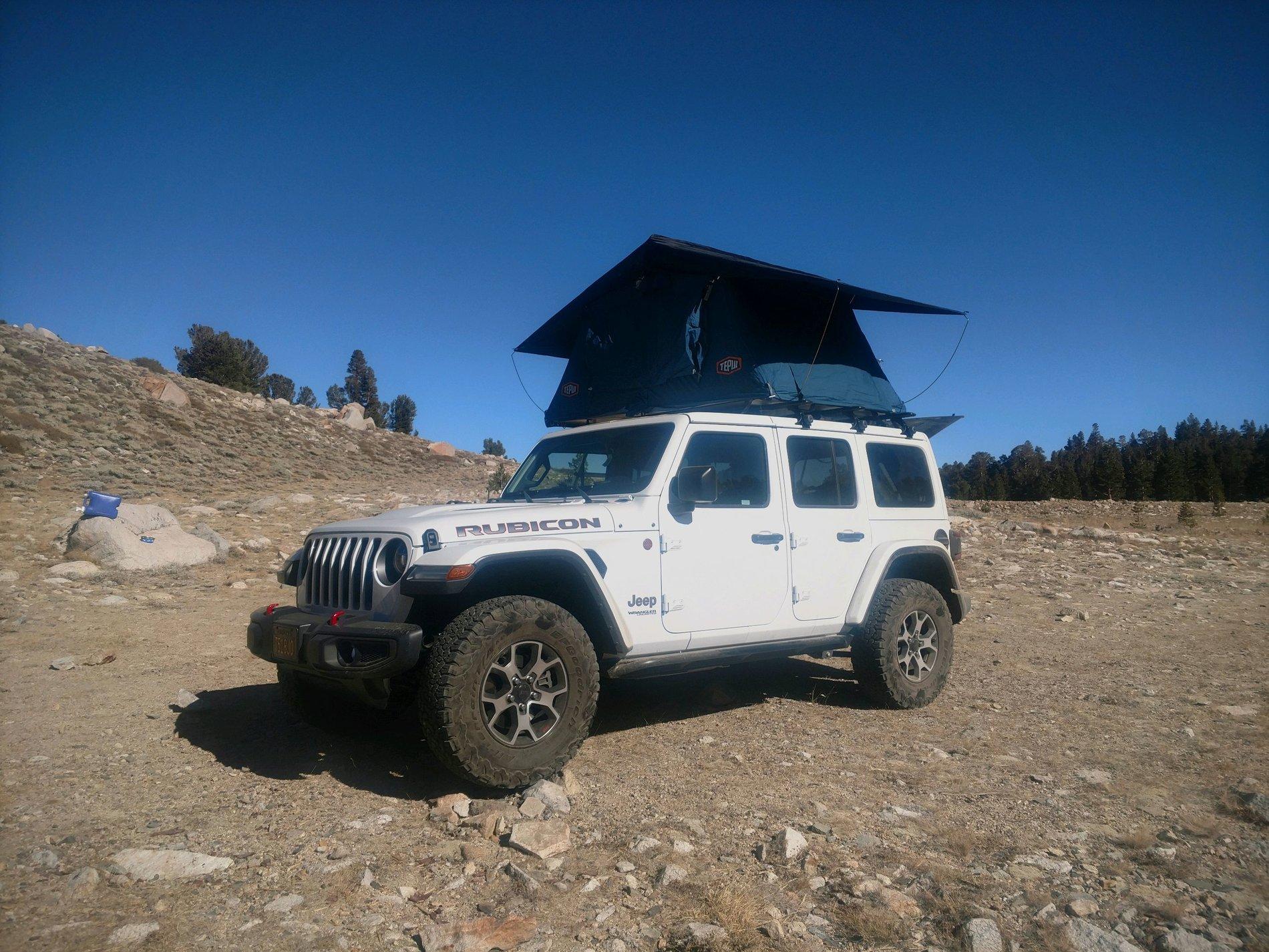

Thule says the bars are rated for 220lb dynamic per pair. They do not speak to what the hardtop can handle.
Static weight is usually a good bit higher, which is the rating for when you are sleeping in it. Does it feel pretty solid? What tent are you using?
The three bars is a great idea to spread the load. The center one lines up pretty well with the C pillar, which should be a strong point on the hard top.
