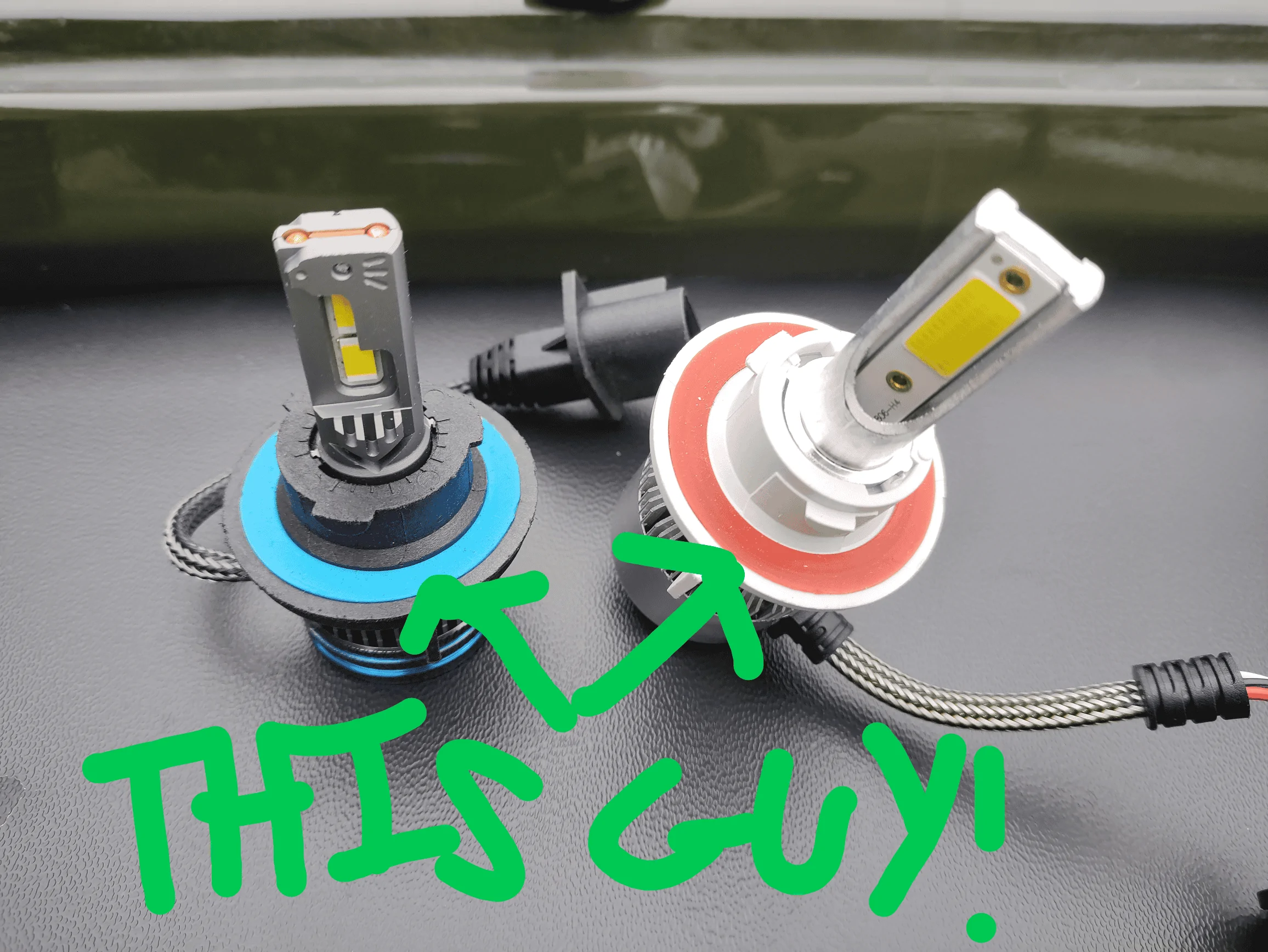

I've been playing around with AliExpress H13 LED headlights for about 6 months now, they work decently, I haven't had any issues with any of them seating poorly.
Before that I was running the same pair of Beamtechs' which I've had for 6 years now. Ran them in my 2016 Patriot and 2021 JLU with zero issues.
Only thing I can think of why your BeamTech's might not have been seating properly, is if you were missing the rubber ring which comes with them...
Jeep Wrangler JL LED Headlight H13 Screenshot_20240103-132720-553
That one with the blue rubber ring, my most recent purchase from China, one of them came without a rubber ring and I ended up borrowing one from my BeamTechs. Without those rubber rings, it won't seat properly and will be extremely loose.
Those ones on the right, with the orangish red rubber ring, those were a $6 pair of H13 LED headlights from China. They seated just fine. Maybe you got an unlucky batch which was deformed?
Have you looked into the possibility that your headlight assembly is a little bit warped?
