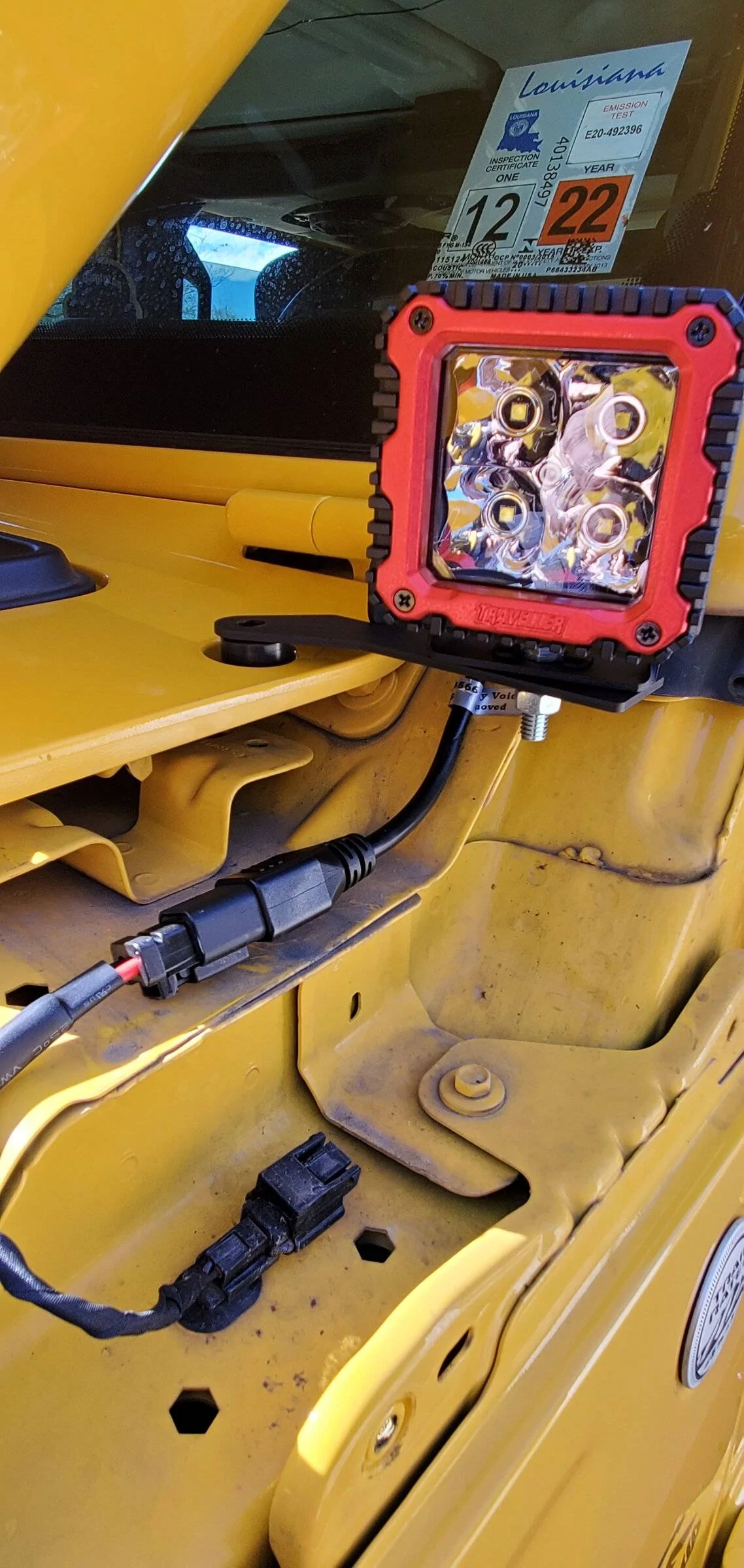

So, I purchased some led cube lights from the local tractor supply store. They didn't come with any type of wiring harness, so I picked up one at Harbor Freight. Same exact connections as the lights.. I assumed this would be the easiest plug & play I've ever done..
Well, I got everything hooked up & no light... The switch itself lights up, but not the lights.. ?

Is it possible that polarity got reversed somewhere? Like at the harness to lamp plug or the switch?
The light and harness plugs match, but do the actual pin connectors match?

Yeah, I guess I can peel back the wire covering & make sure red is connected to red..

do you hear a click coming from the relay module when you flip the switch on or off?

@Headbarcode you, sir, are an absolute genius!!?? It took me all of 10 minutes to strip and reconnect those wires!!
I guess Harbor Freight and Tractor Supply doesn't like each other! Lol

No, nothing genius about starting with the basics first. I'm just glad that it's all good now and that you can enjoy your new lights.
Cheers buddy!
Just saw your pic. Looks awesome!
