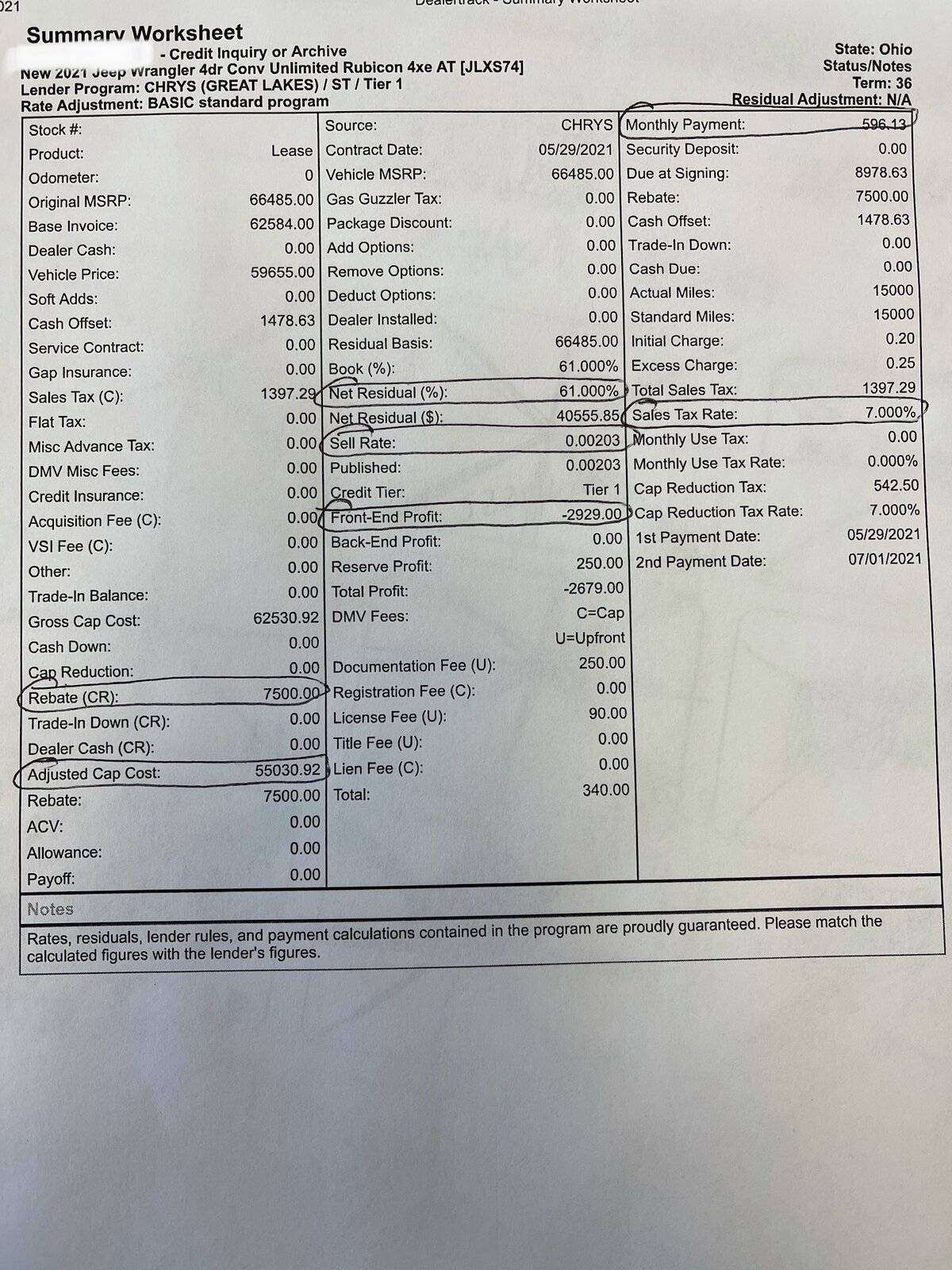

I think this could help. We are similar vehicles, terms, and everything. I’m in Ohio (7% tax).
Here is a written quote from my dealer. 61% RV, .00203 MF.
Curious what people think of this write up, and whether there’s anything fishy in here or if it’s a good deal. Also hoping it helps you since we are a similar deal.

You’re paying about $23k over the course of the lease.
$14.5k in depreciation, $1.4k in taxes, and $7k in finance charges (read, interest). That looks very lopsided to the lease company, but it may be competetive with what is available on these wranglers. Across all vehicles, this seems excessive.
This is why I don’t think the mf to apr conversion is a good indicator of a good deal.
