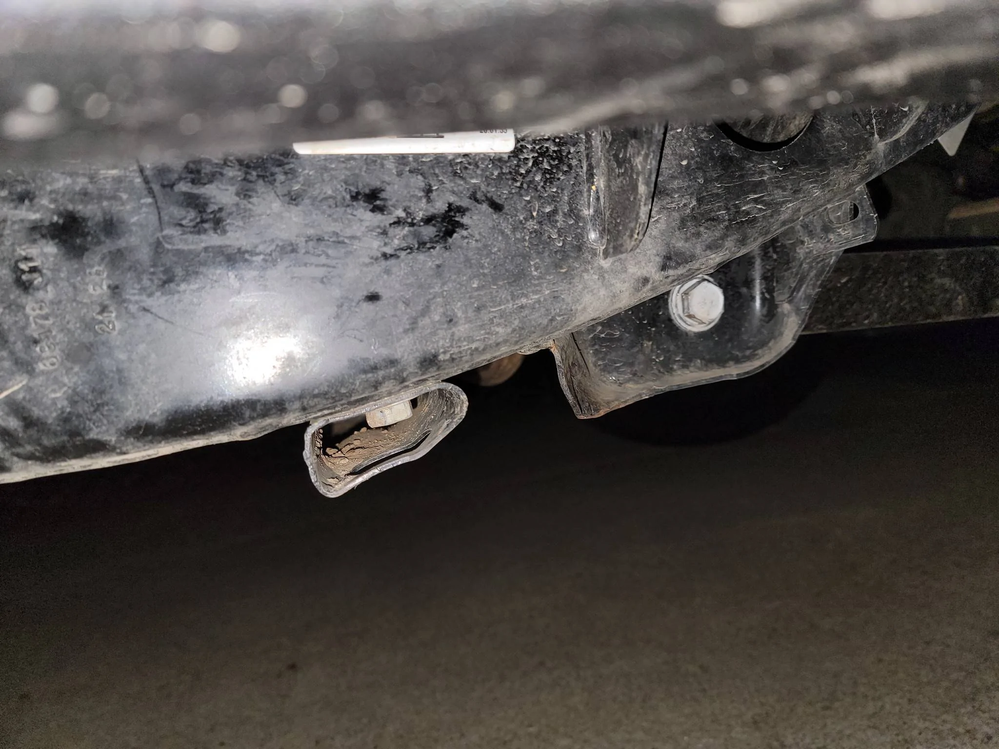

I purchased a pair of used Wrangler front tow hooks (68334760AA) off eBay and replaced the hooks that came with the MP Concepts bumper. I did this because the non-OEM hooks used studs that were very soft, and in fact I had bent them slightly when installing. These are much stronger. I continue to appreciate that this bumper is compatible with the OEM steel bumper parts.

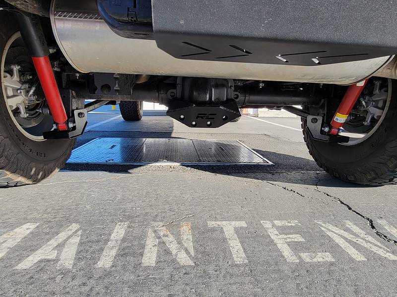

I installed a Savvy Magnaflow Built Axle Back exhaust. I wanted more clearance and a cleaner look. I didn't want a loud exhaust. Based on a limited number of reviews on the forum I decided to try the Savvy offering and it fits the bill. Slightly louder when pushed but very close to the stock levels otherwise. Really nice build quality. Installation wasn't difficult once I realized I could remove the hangers completely rather than trying to separate them from the rubber isolators. It did require some sweating to twist the OEM muffler off.
